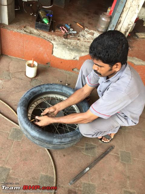

My front tube gave up and I had to get the same replaced, the stock size i.e 2.75-17 wasn't available so they put in 90/90-17, seems decent for the time being, tire has around 10k kms of life left or so I hope, do share your thoughts.
Bajaj CT100B - Utilitarianism Redefined!-imageuploadedbyteambhp1524933524.815055.jpg
Also got to learn that both my tires do not come with specific rotation pattern and can be put on either way, a first for me. :)

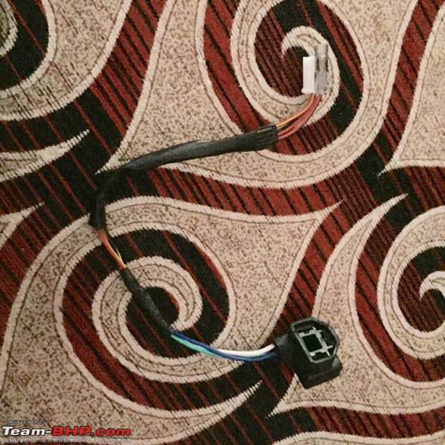

H4 Conversion Completed!
Sourced a Lumax H4 Dome made for the "Hero Honda CD Dawn/Ambition"
Bajaj CT100B - Utilitarianism Redefined!-imageuploadedbyteambhp1525703175.142687.jpg
Got an OEM "Hero Honda" H4 connector as well.
Bajaj CT100B - Utilitarianism Redefined!-imageuploadedbyteambhp1525703214.378141.jpg
Had to DIY a bit to make sure things were plug and play, which was a bit of a pain considering that my soldering skills suck.
P.S. Do let me know if anyone would require a DIY guide. I am asking as I had to do a bit of trial and error as no specific guides were available online.

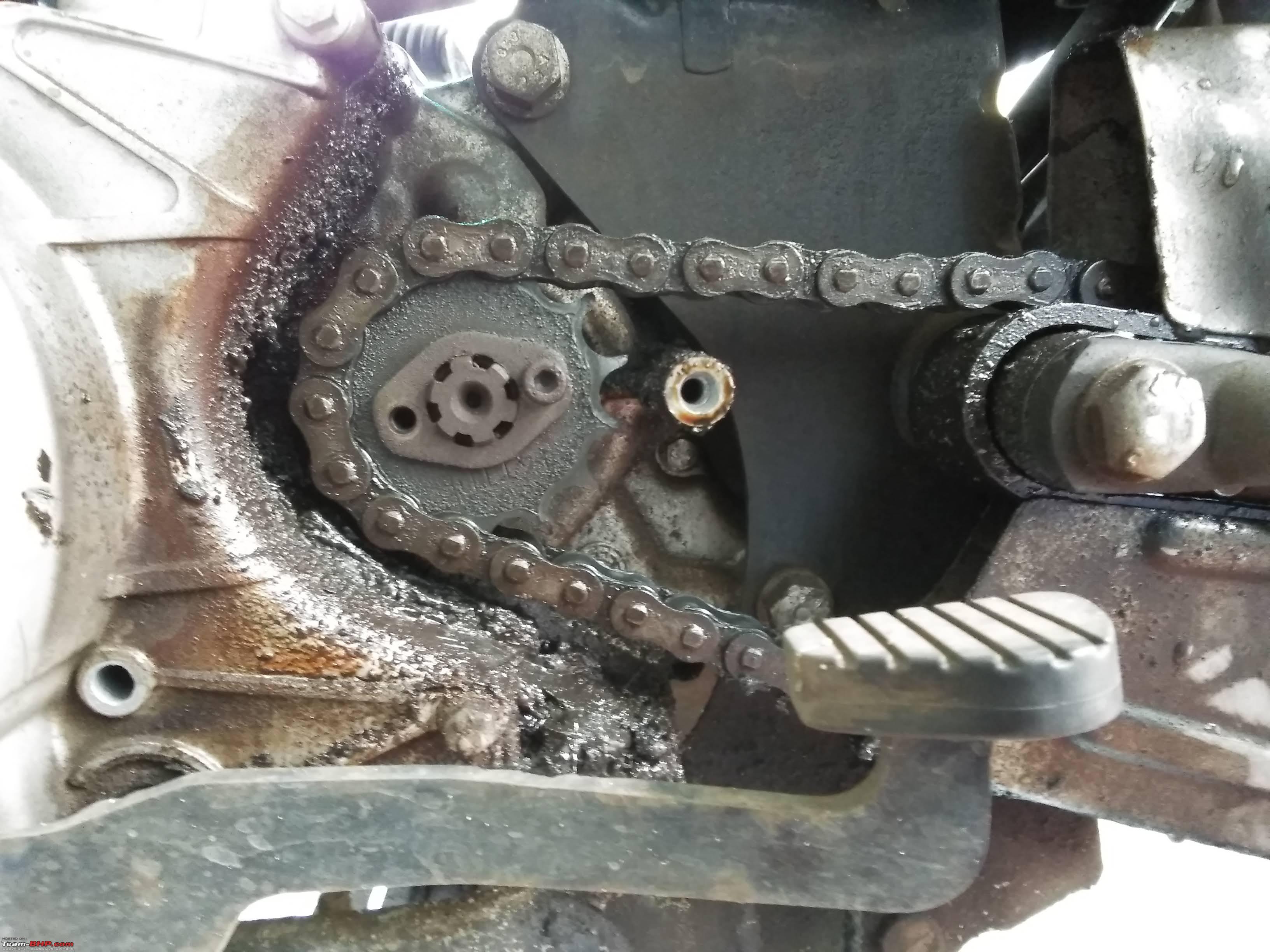

After experiencing a shimmy while riding my CT100B I thought I'd give up being cheap for now and change the chain and sprockets a bit earlier than the 30k mark, which I'd kept in mind considering that I'd change a lot of things in one go including the brakes and tires. But then I was already past the usable life which prematurely was at 20k on to odo after the golden quadrilateral run and I'd purchased all spares after the ride. For some stupid reason though I decided to extend the interval by another 10k's so that I'd only have to take things apart once and be good for another 30k's. But was I wrong, so now at 24.5k on the ODO my chain and sprockets would be changed for the first time.
Here's the DIY Guide on how to go about a Chain and Sprocket Change:
DIY: Chain and Sprocket Change on the Bajaj CT100B, an Investigative Thriller of Sorts!
And here are some teasers i.e missing bolts and nuts;

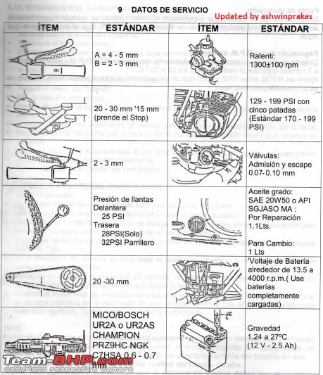

Quick Update: Tappet Clearances Adjusted!
DIY: Setting Tappet Clearance on Bajaj CT100B
Initially had set clearance as per the Scandinavian version of the CT100B's workshop manual;
On realizing that the specification was off, I went with my Indian instinct to make a random assumption in an area where I lacked technical expertise and decided to add a 0 before the 7 making intake clearance 0.07mm which surprisingly solved the issue! :D
Here's the updated page from the workshop manual;

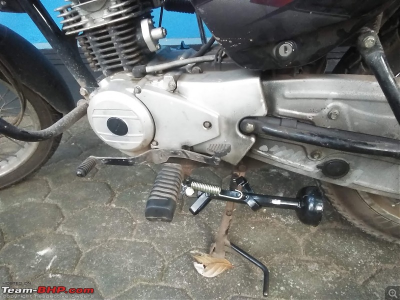

A day before the ride the motorcycle had a minor spill which resulted in some scuffs and twists here and there and finally led me to opt for a more off-road friendly kick stand as the stock one had its limitations.
