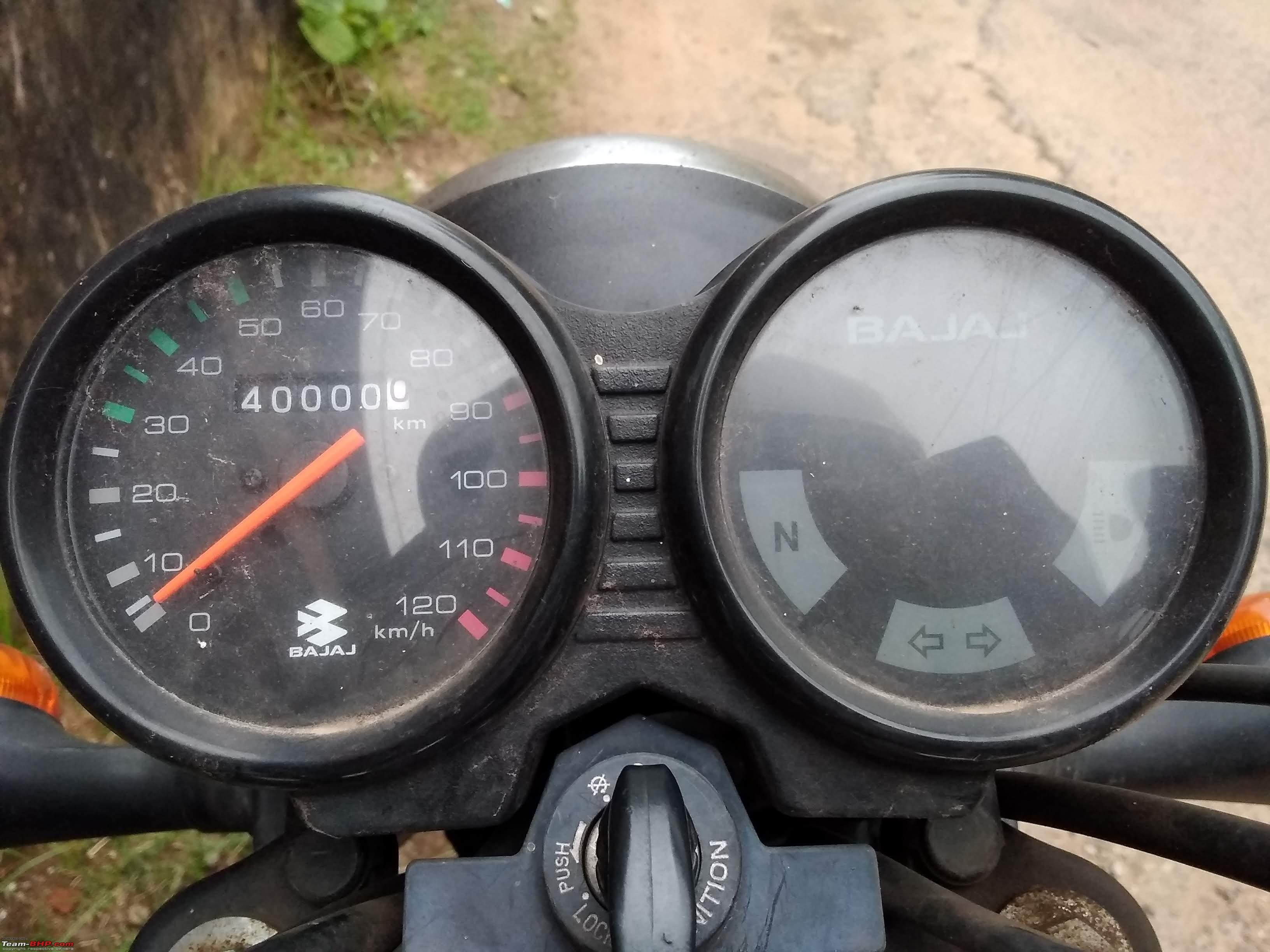

UPDATE: 40,000km's Clocked!
Consumables were changed, she's running on Savsol 20W50, I had some Laal Ghoda 20W40 remaining form the P220's oil change but got this bottle as Savita was selling their lubes at a discount to promote #AtmanirbharBharat and I ceded without much thought.

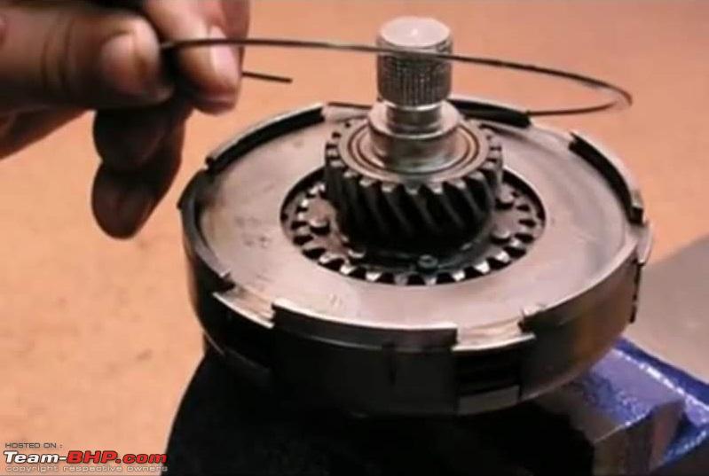

Ever since that fateful day she seized up;
Speaking of which the reason behind the seizure was that the previous mechanic who was the sole person who serviced the motorcycle for the whole of the 2,25,000 km's the previous owner had put on the motorcycle, he didn't bother to replace very trivial parts during the several clutch changes in the past;
Bajaj CT100B - Utilitarianism Redefined!-screenshot_20191130171619_youtube.jpg
This giant cir-clip and the clutch basket which would cumulatively have added about 100ish bucks more to the bill. :deadhorse
So while riding in traffic the circlip came loose causing the clutch to literally seize which pushed the crankshaft off its axis from the obvious force of something coming to an abrupt halt from a few thousand RPM's. Since she's a better built machine the cases remained intact.
The cylinder was in really good condition so wasn't replaced, the crank was reconditioned at 'Popular Lathe' near the RBI office, the guys an expert and seeing the condition of the crank insisted that he installed the bearing shaft as the condition of the crank was below par and any hammering from the mechanic would possibly affect balance.
