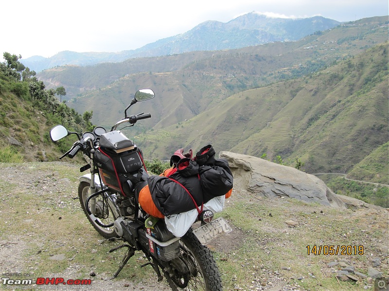

My 2016 CT100B with some mods for touring.
Starting from the back
Aftermarket tail light from Karol Bagh
Luggage rack from a commuter bicycle (Welded on to the frame)
Jerry can holder made to fit a 2.5 lt. motul can (I guess its unnecessary for a bike with good fuel efficiency)
Rear tyre Ralco Gripper
Pulsar 150 shocks
Small battery operated tail light (In case the main one fails)
3M Reflective stickers everywhere
Aftermarket exhaust (Pretty loud)
K&N type air filter (Didn't see much difference in performance)
Custom made bend pipe with Heat shield (Still burn't my pants couple of times)
Stock kick lever chopped and bent to fit (Stock one would hit the pipe)
High density foam seat with perforated seat cover
Tank is from old model Boxer (Cost Rs 2000) Its thicker than current model
Front mudguard from Rx100 (Direct fit)
Front tyre Timsun TS 800
Headlight from TVS XL
Aftermarket headlight brackets
Switch gear is from CT100ES to allow adjustable cables
Runs without battery
Everything else is stock (More or less)
Don't remember the exact costs but nothing too expensive.

I forgot to mention the engine bash plate at the bottom. stupid:
Cool Mods!
Do contemplate adding indicators, unless you're not intending to take the motorcycle on the highways.
Exhaust looks cool, just hope its tuned right, because if you run a lean mix for long on these machines that'd be at their peaks most of the time the engine life would drastically go down. Same goes for evacuation cause if heat remains at the exhaust port then your exhaust valve would die prematurely.
Also ensure it doesn't burn your leg in a fall.
As for the intake, personally I'd stick with the stock filer any day because I'm strictly against these re-usable filters, the pore size goes up after every clean cycle and you eventually bust your valve seats.
I believe the tank capacity is the same, I'm contemplating a tank with increased capacity. The RD350 tank has 16L capacity though I'm not sure about availability of new spares.
Though the motorcycle has 10.5L capacity, when riding hard it doesn't take me as far as I'd hope it would.
Thank you for that, would contemplate going for them if the stock plastic one goes for a toss, I'm fan of economic options, and presuming RX100 spares are non-oem I expect they'd be cheaper than the stock mudguard.
A friend has this setup on his FZ16, he says the output is better and more focused in spite of the smaller beam, do share your thoughts.
The quality of the brackets seems commendable, do share a link or more details of the same if possible.
Please share more details on this with pictures and cost, also do the connectors match?
I'd really love to scrap the current switch gear. :D
Also, the engine guard is a nice add-on, I'm heavy and every time I land hard I worry about the drain bolt getting hit.
Do share more details about its construction, and how you managed to mount it.
Cheers,
A.P.
Cheers,
A.P.
I stuck a sheet of paper (using fevistik) at the bottom tubes and made a stencil as required. Then transferred it to stainless steel sheet using the stencil. Cut out the plate.
Fixed it on a vice and bent it using a hammer (The bend is where the tube gets narrower)
Drilled 4 holes. (Make sure they are in line with the tubes). Put bolts through the bottom side. Tightened them with nuts from the other side.
Lifted the bike up, Held the plate at the right place and welded up the nuts to the frame. (Use small bolts so that they don't touch the frame)
You can tilt the bike instead of lifting it but remove the petrol tank so it doesn't leak during welding.

I won't take it on the highway. The bike is strictly for the mountains. Where I feel the power is just sufficient. I tend to go crazy with bikes and use it to its full capacity.
The whole intake and exhaust setup is just an experiment. It is completely reversible to stock. I just wanted to make it as light as possible and high swept because of so many water crossings we have up here.
I do need a bigger heat shield for now.
The old boxer tank is also a direct fit. And its width is perfect for standing up on the footpegs and gripping the tank while off-roading.
I went for a non-oem mudguard but it rusted very quickly so now I have a genuine one which i took out from my '89 rx 100.
Yes the TVS headlights have a focused beam. You can also try the rx headlights which are of same diameter. I don't know which one to recommend because I hardly ride at night.
