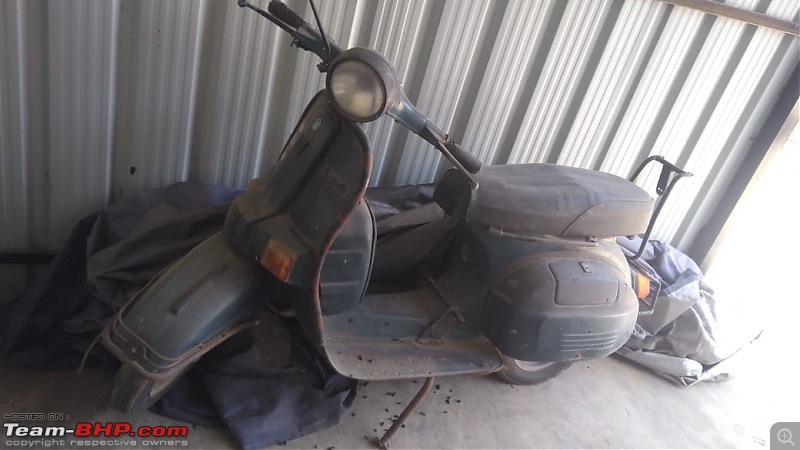

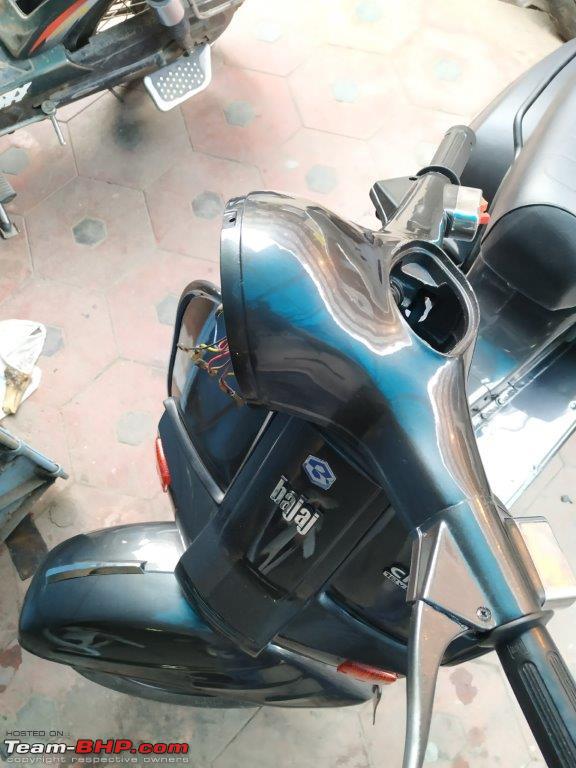

This thread is not about the scooter I owned in the past. It really is about the present. Few months ago, I got an itch towards geared scooter. There was a period of few weeks where I started feeling I need to ride and own a scooter. A sweet co-incidence was this thought came exactly 20 years after my first scooter. I looked around Olx for days together. I couldn't find any good ad nor did I understand how to spot a good scooter ad. I was very rusty, confused and what not. Then I remembered my friend Arun (Arun1100) had one at his home. His dad got it in 1997 and used for around 10 years and then it was lying idle. It had a lot of cement on it that fell when they had some renovation work going on. Arun was wanting to restore this scooter since long. With his busy schedule and family commitments, he just couldn't. I causally asked him to give his scooter. Without any hesitation, he simply parted it to me for free! He said, I will get it fixed nearby and give you in running condition which he did.
The scoot wouldn't start and kicker was getting jammed. Arun was kind enough to identify a FNG and get it fixed. I preferred Arun's scooter because of the fact it was a known good scoot and genuinely low run (just 24k kms).
This is how it looked like at Aruns backyard:

Initially, we thought just cleaning carburetor, tank and pouring fresh petrol would suffice. It wasn't the case and mechanic had to work on unjamming the kicker(We weren't present when that work was done).

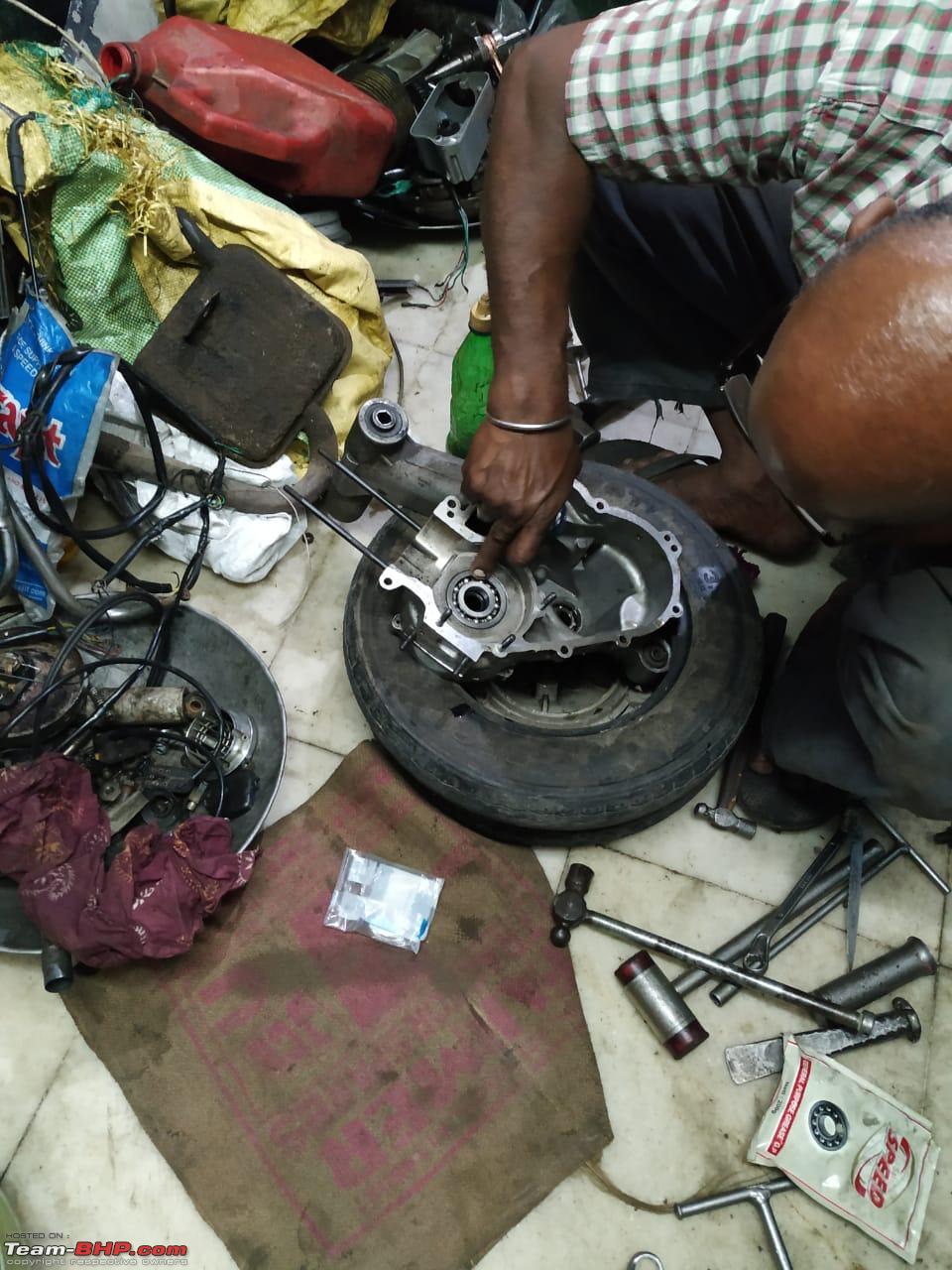

With the scooter being able to run, we noticed that there was a very harsh noise from the engine bearings. Though it rode perfectly, the irritating and harsh noise was killing all the fun. Also, noticed that the fitness of the scooter had lapsed as they were not using it since few years. Now, I had to find a good mechanic to set the scooter right. I had no clue where to start. All I knew was car mechanics. I asked all my mechanics who couldn't refer me to any good scooter mechanics. They did refer me to some places but those garages were least interested in old vehicles like this scooter and preferred only Activa/Deo.
While researching, I needed some spares like mat and other things. Some how found the spares shop nearby. The shop owner was a nice chap and referred me to a mechanic nearby. He said he has the shop since 35 years and only this one mechanic is best when it comes to Bajaj Scooters. There was no 2nd best also in say 3-4 km radius. He vouched for him fully.

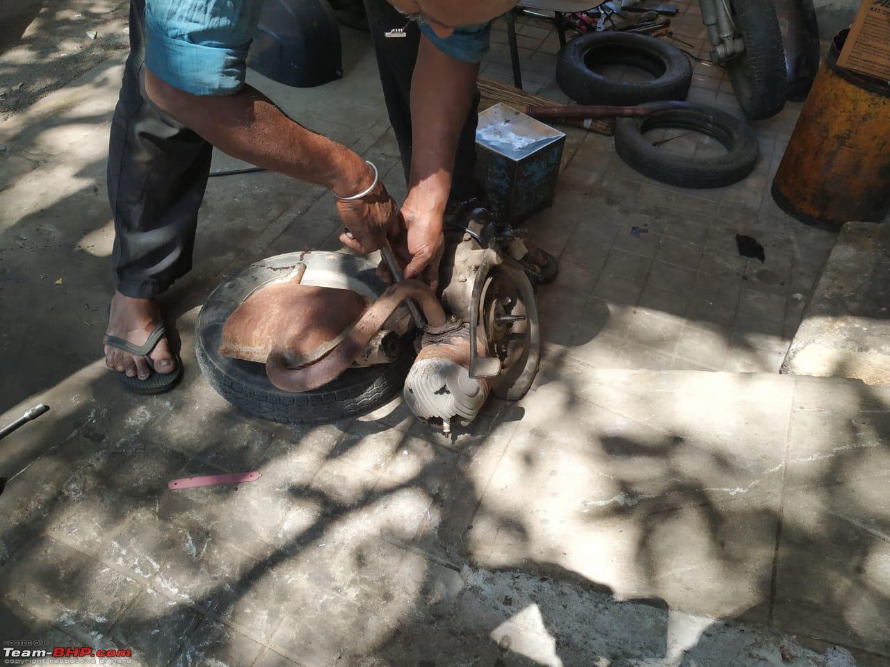

I took the scooter to Sunil. He immediately said this is bearing noise and engine has to be opened. He was reluctant in doing so. He was saying this is expensive work. Once engine is opened there are something we proactively need to change and we may unearth few other things to change and all. He said why you want to spend so much look for another Chetak you will get at same price of the work needed. He was seeing me from same perspective of his many other customers who are rightly reluctant to spend more on scooters. Then he understood I am passionate about this and not worried about petty expenses, he agreed. I told him upfront I very curious and want to watch him do the work. He was elated and said it will be my pleasure. He said he will start work any time in next 2 days where he gets a dedicated 3-4 hours time at a stretch and he would call me. He liked the interest I was showing and some how he made it happen the very next day morning 9AM! I was elated and was with him all day watching him remove the engine apart. The was he executed I could understand how knowledgeable he was and organized. Some pics while he downed the engine:
Mechanic starts work to remove the engine, starting from side cover going off and carburetor removal

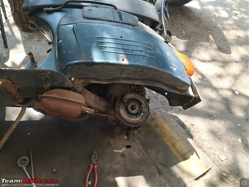

Other side of scooter, he removed the wheel and drum and also noticed brake shoes were quite worn
The Scoot without engine

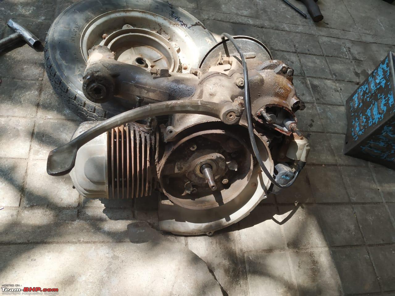

The Engine and further dismantling the engine

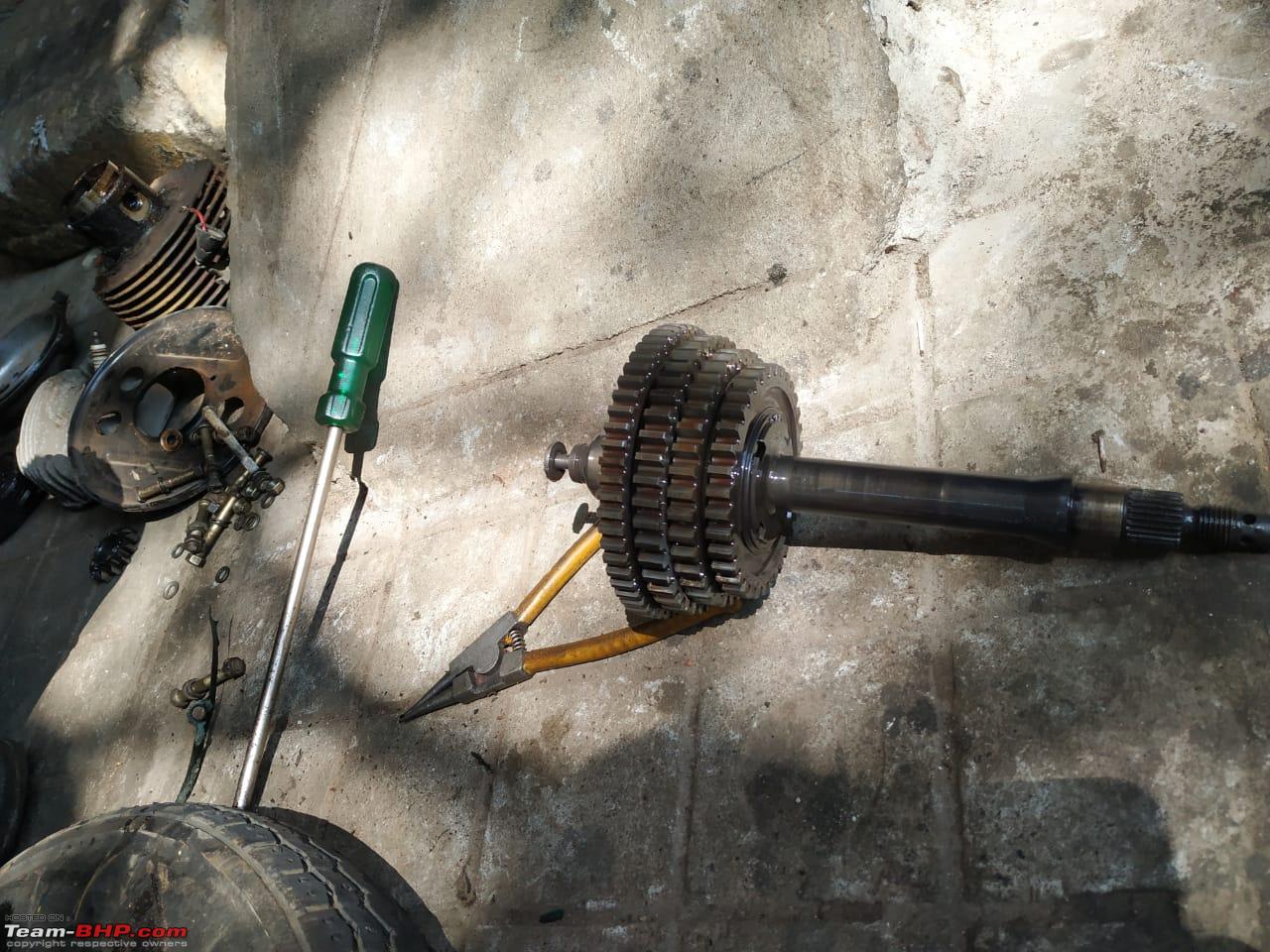

The gears

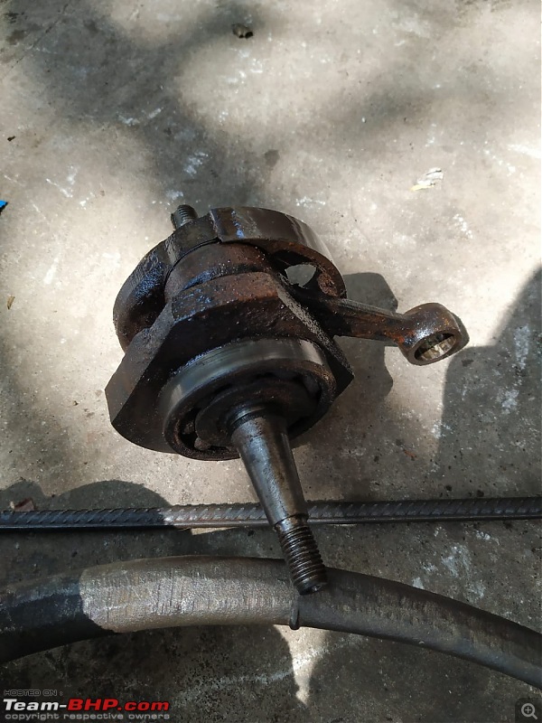

The faulty bearings (marked in blue) that was causing such a noise:

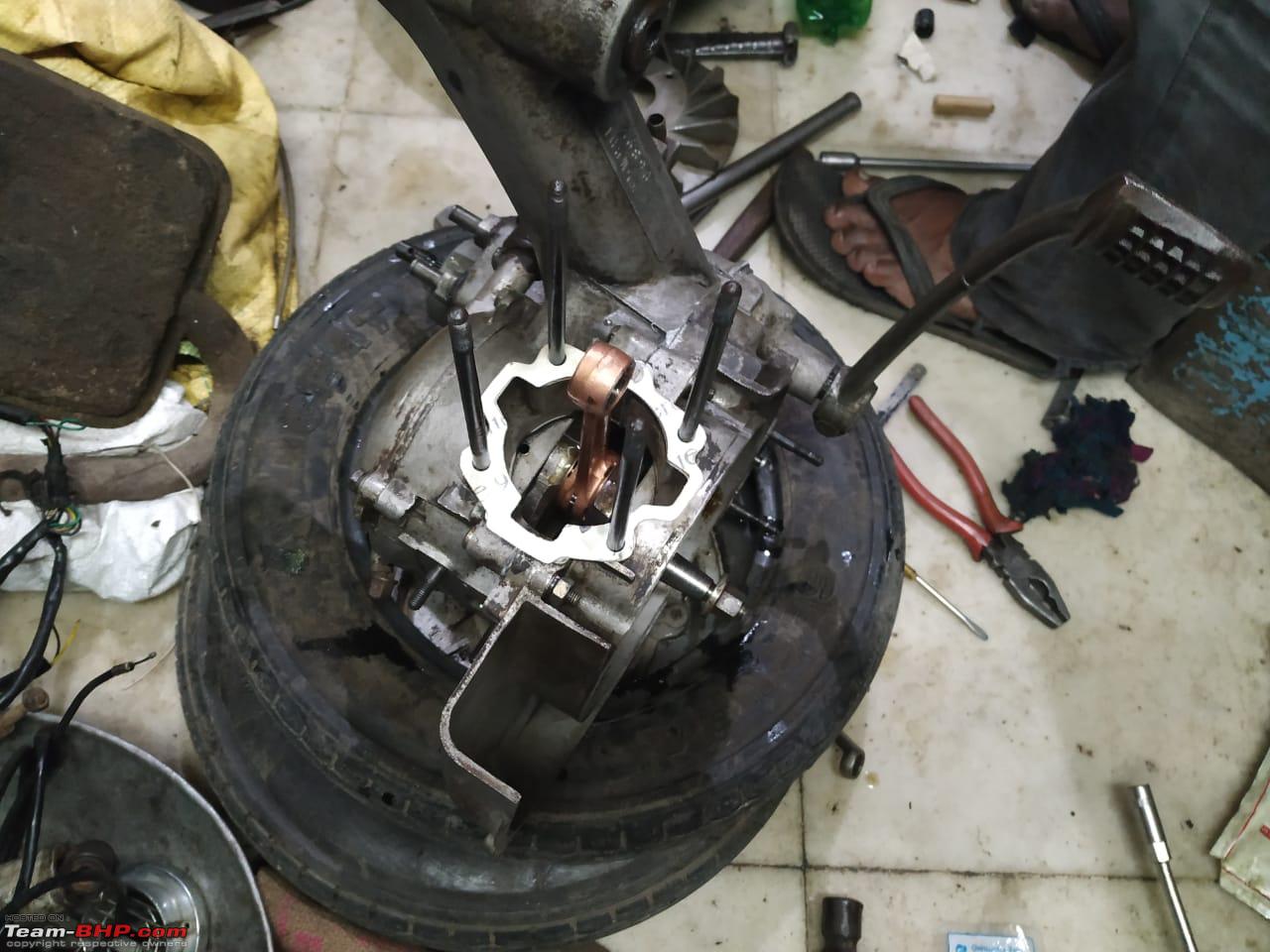

Mechanic after thoroughly checking noticed the Connecting Rod to have a lot of play and for some strange reason it was full of rust. He asked if the vehicle was submerged any time. I said never! He too said it was strange that only connecting rod was rusted badly and said may be poor quality control of factory. He replaced the bearings, connecting rod, clutch and few other minor things.
The meticulous process of assembling the engine. He always prefers to do it after hours so he is not disturbed by walk in customers
Restored! Hamara Bajaj - Chetak, a fun workhorse-whatsapp-image-20181031-18.21.06.jpeg
Restored! Hamara Bajaj - Chetak, a fun workhorse-whatsapp-image-20181031-20.58.35.jpeg
The packing set:
Restored! Hamara Bajaj - Chetak, a fun workhorse-whatsapp-image-20181031-20.58.381.jpeg
The new Connecting Rod visible here:
Restored! Hamara Bajaj - Chetak, a fun workhorse-whatsapp-image-20181031-20.58.382.jpeg
Restored! Hamara Bajaj - Chetak, a fun workhorse-whatsapp-image-20181031-20.58.38.jpeg

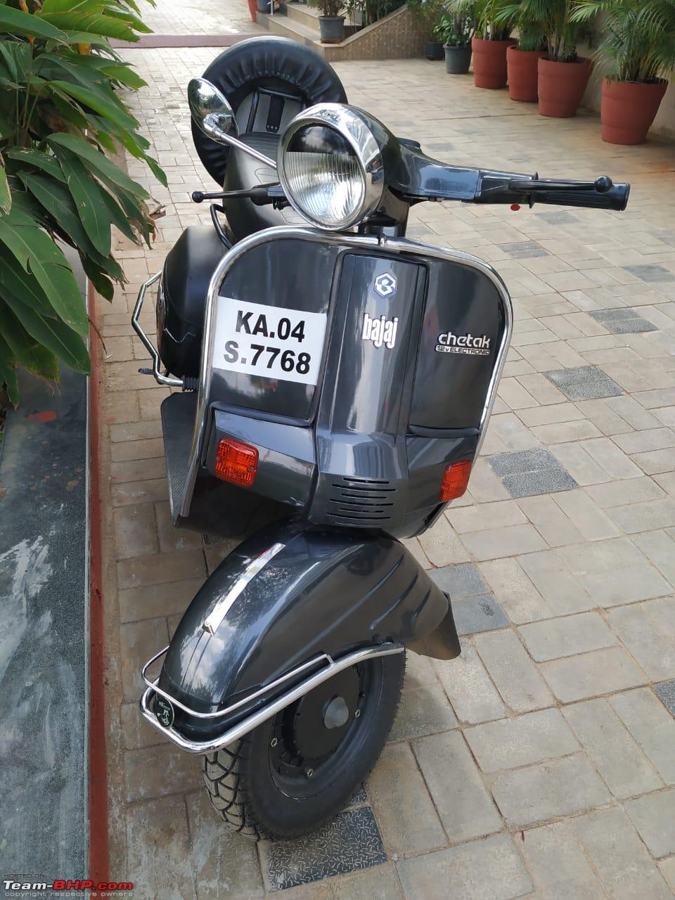

Once all work was completed, the scooter rode like a charm. It surpassed all my expectations and really rode better than a new Bajaj Scooter when it was available new. I felt I was very lucky to identify the mechanic who made this happen! Here are some pics after the engine work.
Restored! Hamara Bajaj - Chetak, a fun workhorse-whatsapp-image-20181101-17.09.58.jpeg
Restored! Hamara Bajaj - Chetak, a fun workhorse-whatsapp-image-20181101-17.10.091.jpeg

After the paint work was completed, it was back to the mechanic for the fittings.
The gloor looked so neat and level now!
I chose to install new leather for the side shields and front dickey!
