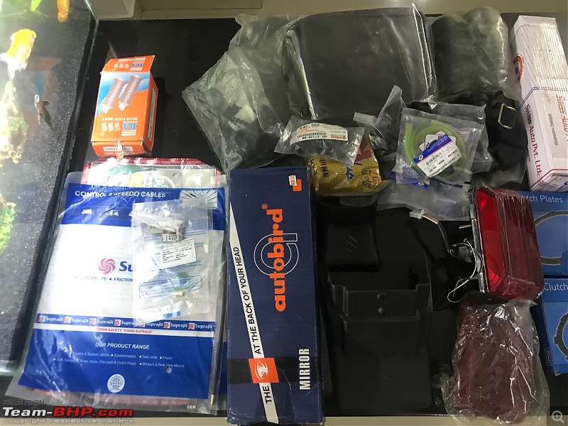

Update update..
Got a bag of goodies from Bangalore.
Pramod
pramodkumar is offline   (2) Thanks
