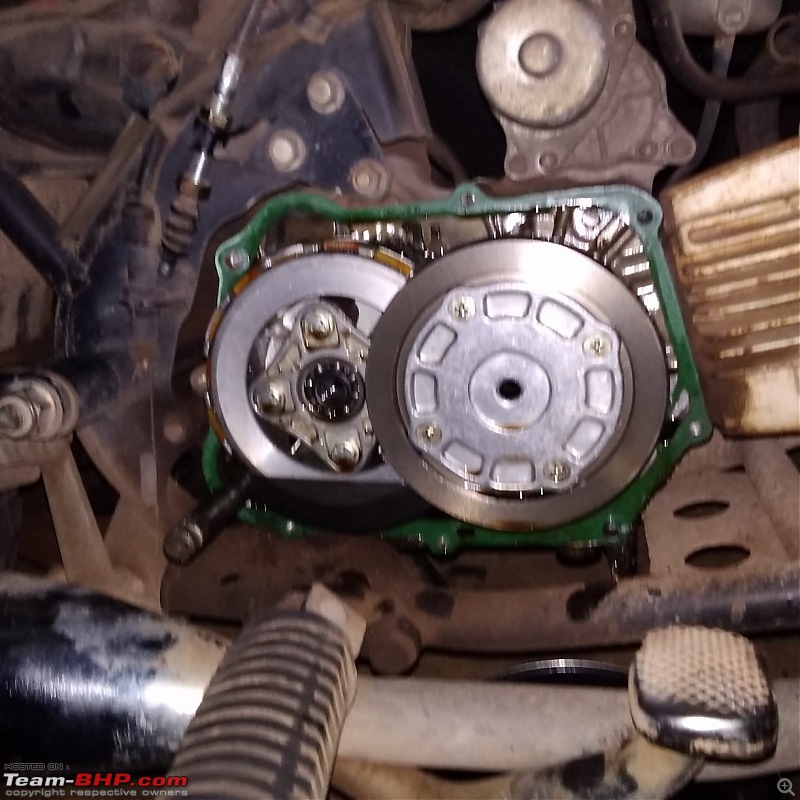

Changed friction plates on a friends Splendor, what better way to spend Christmas than to work on a motorcycle with like minded bikers eh?
DIY: Assembling your motorcycle clutch!-img20191225wa0037.jpg
DIY: Assembling your motorcycle clutch!-img20191225wa0034.jpg
Surprisingly even the clutch center nut had regular threads, on my Puslar only the centrifugal filter has regular threads, the clutch center nut is reverse thread.
You need different special tools to remove both nuts, the center one can be removed with the Puslar type but the centrifugal filter nut is of a different size, we removed it using a rift and a hammer, Indian style.
And you really need the clutch holder to remove the center nut, jugads simply failed. A nearby FNG was kind enough to lend us their tool being Christmas and all.
Friction plates from Bosch costs 100ish and OEM ones cost 300ish, we went for OEM ones.
