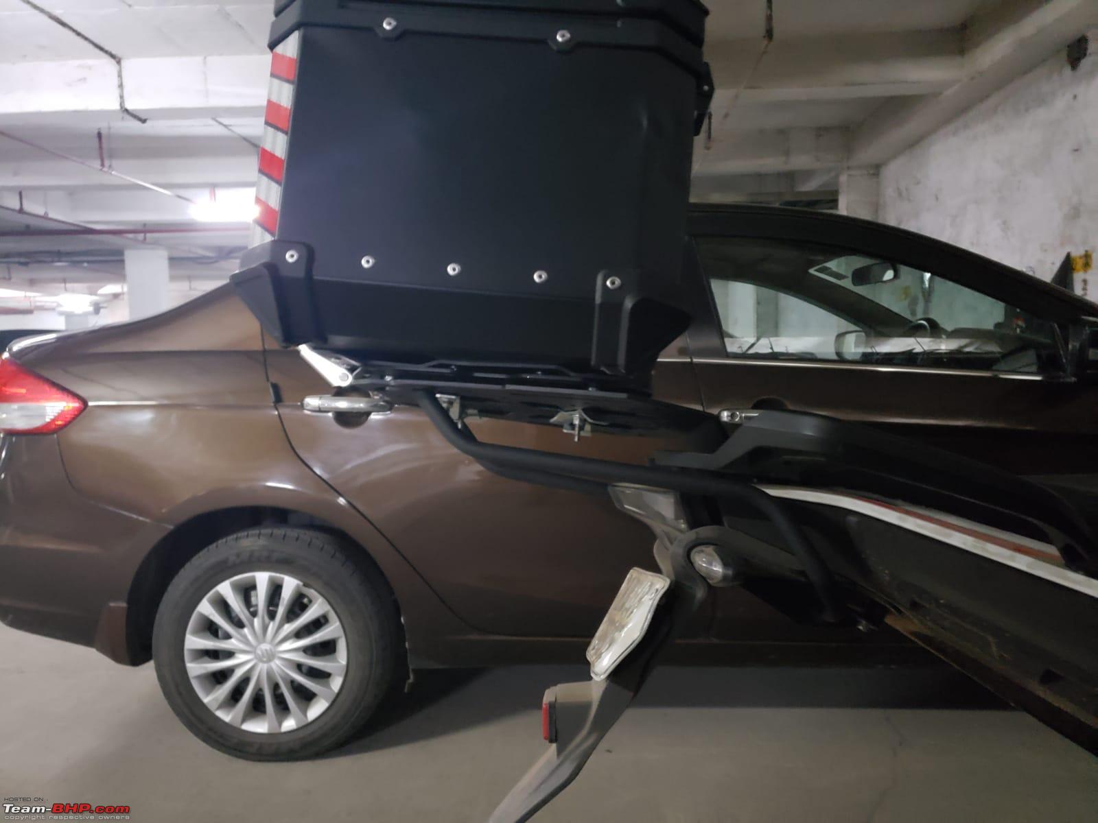

Hi Viraj. I bought the top rack in order to mount a top box. However, the JB Racing top rack is attached only to the 2 handlebar bolts, hence with a top box mounted the entire thing starts to wobble dangerously. I contacted Bandidos Pitstop (the seller) and they said that the 2 extra support arms that the rack comes with can be attached to the JB Racing saddle stay for additional support.

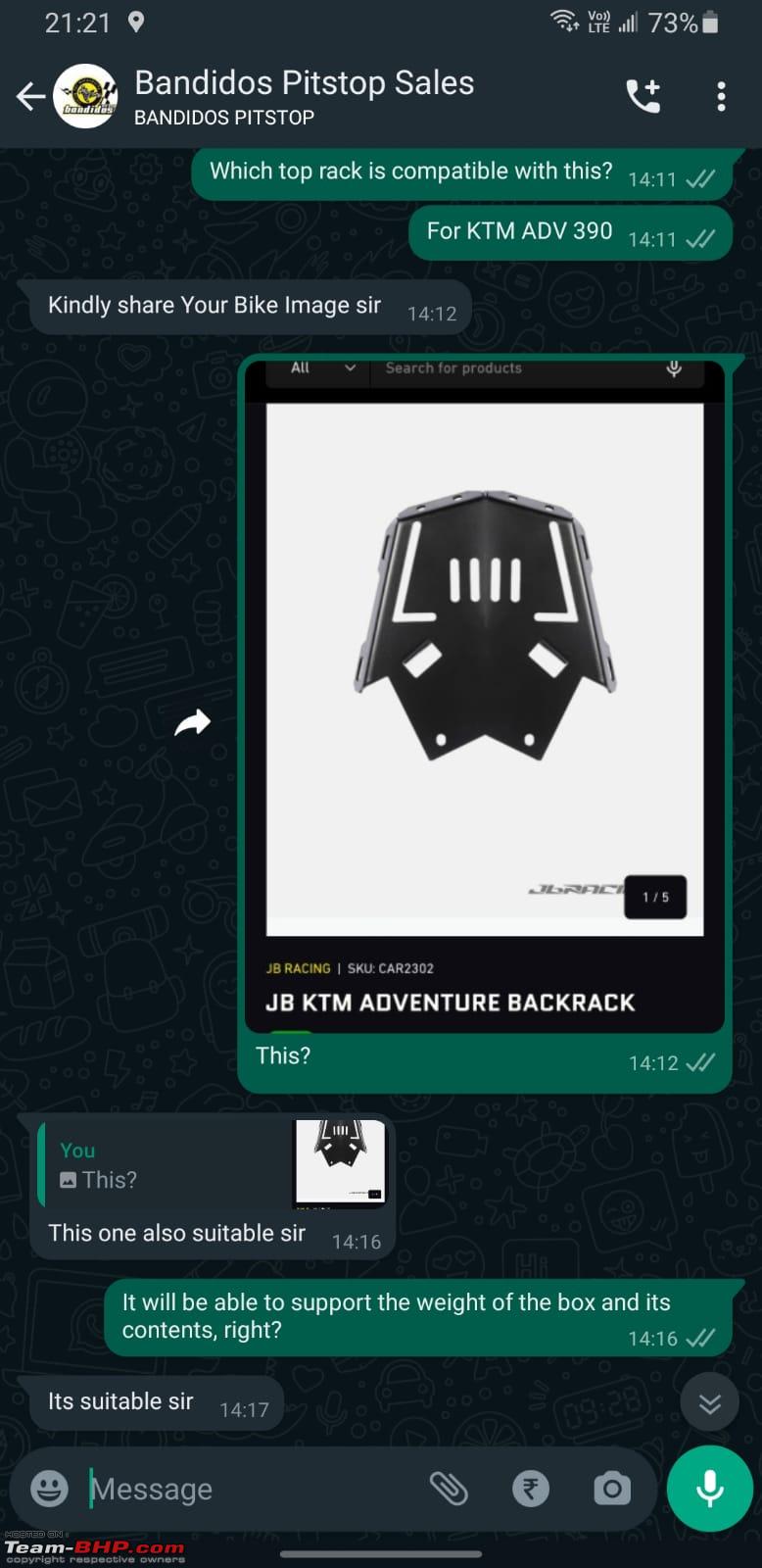

While I did have plans to buy a saddle stay anyway, I felt cheated by Bandidos Pitstop since they could've just told me this last bit while placing the order (I had lengthy chats with their sales team before ordering their rack and "premium" top box). Then I would've either not ordered this rack or would've ordered the saddle stay too, at the same time. Before placing the order I specifically clarified whether the top rack will be able to carry the weight of the top box or not, and they replied in the affirmative.
Anyway, I went ahead and purchased a second top rack, this time the Hyperrider Aluminum top rack, which was quite a bit more expensive at Rs. 4990 (the JB Racing one was Rs. 1450 iirc). I'm satisfied with the whole setup as of now and there is no wobble anymore.
The JB Racing backrack (without additional support from the saddle stay) can at best be used to tie rucksacks on it. Should be quite good for that. If you, or any other ADV owner can get it picked up from my place in Delhi, I'll be more than happy to give it away since I don't need it anymore.
The KTM 390 Adventure (Gen- 1) Ownership Thread!-whatsapp-image-20240115-17.21.29.jpeg
The JB Racing rack with no additional support to hold the weight of the top box
The confirmation I received from the Bandidos sales team after which I went ahead with the purchase

That's bad. Sorry. Would have picked it up if you were in Pune and checked with a local fabricator to make a custom support bar for this unit. Still would have been a lot of work. One reason why I am not very confident about buying from these online accessories sellers. Quality is a big issue. Items sometimes are totally different from what you expect after seeing the image. to make it worse, Youtubers don't even mention these issues.

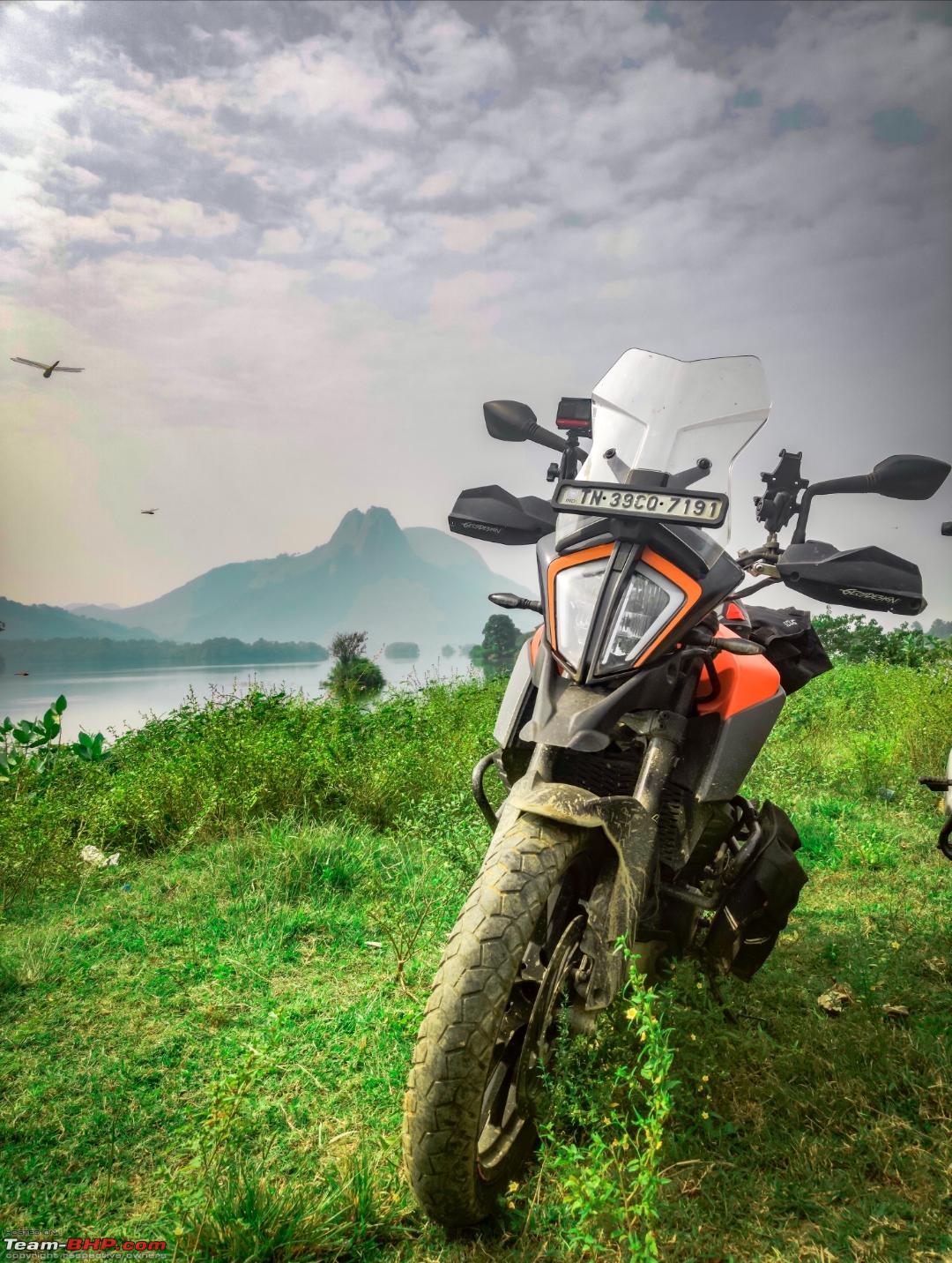

How I Upgraded my KTM 390 ADV Mirrors for INR 250
I purchased my KTM 390 ADV in May 2022, and my first complaint with the bike was the abysmal rear-view mirrors (RVMs). While the stalks are tall and wide enough, the mirror area is sadly lacking and tapered upwards, leading to lacklustre visibility.
To address this, I initially tried using the RVMs from the Avenger, which were wide but not tall enough. Consequently, my shoulder ended up occupying a significant portion of the mirrors, and the aftermarket solutions were too costly to explore and Mirror Extenders I find useless.
With my Pune - Rajasthan Trip on the horizon I decided to go the DIY route which involved using P150/NS200 Mirrors on KTM Stalks. Below are some pictures of the DIY Modification.
Mirror removed from Stalk.
P150 Stalk and Duke mirror after disassembling
View from the DIY Solution
Near Narmada Canal on the way to Udaipur
Total Cost: INR 250
Time Taken: 15 Mins
Issues Faced: I have now completed my Rajasthan Trip and the mirrors offered great view but were hanging a little loose due to endless bumps during the trip. This was easy to fix by using Screws from P150 Mirrors rather than KTM ADV ones as I had earlier used.
