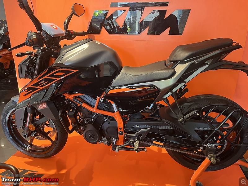

Here's my gen 3 Duke with full set of international variant mirrors.

Here is a pic taken from the 2024 KTM Duke 390 Thread.
https://www.team-bhp.com/forum/motor...ml#post5628611 (2024 KTM Duke 390 Review)
The KTM 390 Adventure (Gen- 1) Ownership Thread!-2024_ktm_duke_390_post_06.jpg
Now in the later batch KTM started using dominar stem with the international shape as you can see here. The new adventure use the same mirror.
https://www.team-bhp.com/forum/motor...ml#post5937668 (2024 KTM Duke 390 Review)
The KTM 390 Adventure (Gen- 1) Ownership Thread!-blackduke390gen3inferiorqualityv0zuqhe5yqgfne1.jpeg
https://www.team-bhp.com/forum/motor...ml#post5944050 (2024 KTM Duke 390 Review)
Now @amyntor How does the international stem hold against the dominar's stem in terms of vibrations? I have found the Domniar stems the least vibey but obviously at the cost of being heavy.
