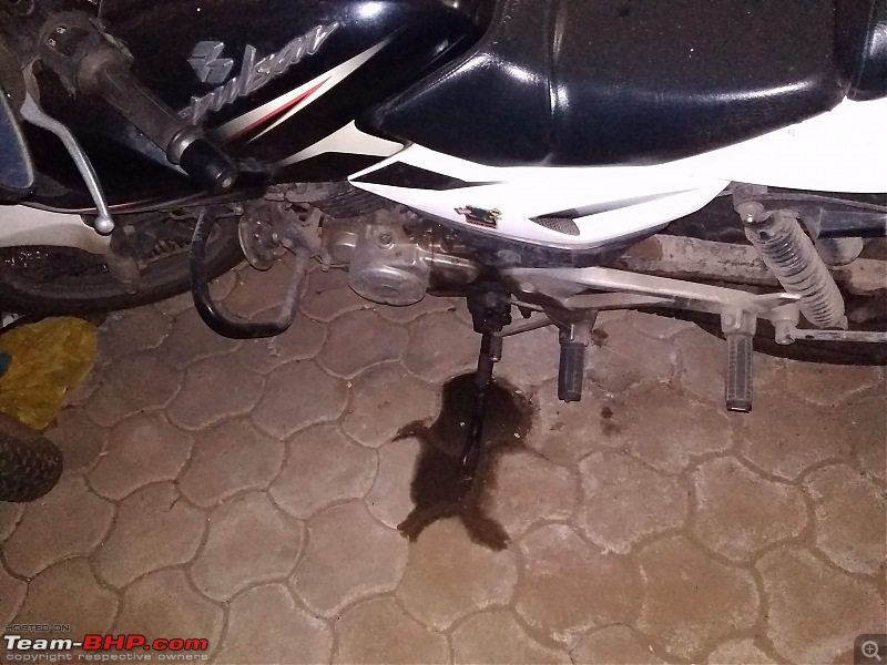

I have been grappling with an annoying oil leak in one of the motorcycles that i am trying to restore. Its a 78 model honda cd185 twin. The problem is simple. While on center / side stand there is no leak whatsoever, when the engine is started, it leaks close to the mid section of the center stand.

If it were the shifter seal, sprocket seal/collar or the neutral switch then the motorcycle would leak when kept on its side stand:
Ways to detect the source of an engine case oil leak-img_20200112_191602.jpg

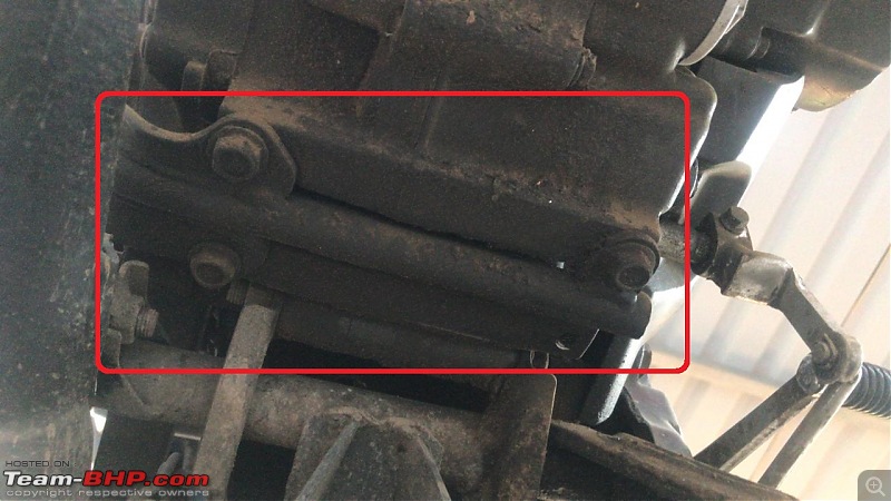

On the CRF's and CB's of yesteryear they have a kicker stopper that sits under the crankcase, on the Unicorn etc it extends to be forward set pegs, the mounts are prone to crack and at times would result in leaks, but that is usually noticeable even when the motorcycle is left idle.

Quite see what you mean but the leak is almost at the center of the case. The kicker stopper is at the right side so i doubt it.
The stopper extends from one side to the other.
Ways to detect the source of an engine case oil leak-whatsapp-image-20200318-4.50.46-pm.jpeg
Don't know why but that is how it is on the older CRF and CB series, but yours is older than the ones I've seen so do make sure.
