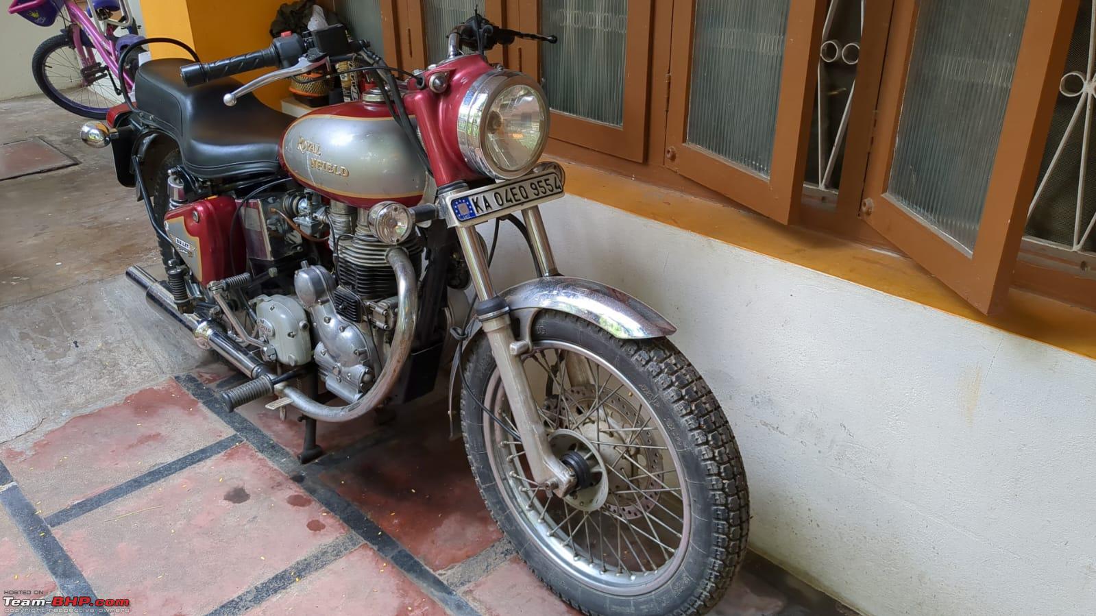

Restoring a neglected Royal Enfield Bullet Electra
Bullet Electra Restoration
I thought I should document the process of restoration of my Electra 5s CI.*
Background
I bought the Electra 5s around 2006 as a replacement to the then senior citizen Chetak which was too old and that my Fiero was used by more than one person at home. The reason for going for the Electra 5s was that it had gear shift on the left and I was apprehensive to have two bikes at home with gears on different sides. In hindsight that was a unnecessary decision made in the ignorance of youth. We will come to that later. I also choose disc brake option for "superior" braking ability and electric start because there were choices now for bullets that never was heard of before.*
Anyway 20+ years later and after close to 70k kilometres the Electra was sitting under the covers for several years while a Standard 350 CI took over as favourite. The Std 350 is incomparable to the Electra. I started using the Std 350, because of the relaxed 4 speed gear box and of course the neutral finder magic wand at one's foot.*Biking is hardly of concern now, and most travels happen in the family cars or by public transportation. The bullet however is the only motorcycle I prefer to ride, and it has been so over so many years. More over, due to a mistake in the RTO, when I renewed my DL in 2018, I only received my Car licence and it was missing the two wheeler licence. I never bothered to fix it or get a two wheeler DL as there was no requirement at all.
A few months ago, I felt that I am wasting away the bullets at home, while the world is moving away from petrol. Maybe in another 10 years petrol would not be available any more. I wanted to resume using my bikes again. So I applied for a LL and will soon get my DL for 2 wheeler again , though I am apprehensive about the looks I might get during the DL test at this age.
Of course there is the Standard 350 in pristine condition and always ready to be ridden, but a twinge of conscience bothered me for neglecting the Electra which was standing as always in the front part of the house. It felt as though that a child was looking at me in sadness, and I determined to restore it back to health.
Inspecting the years of damage
I did not bother to attempt to start it, because I knew that with so many years of neglect, it would be wiser to clean and restore everything than damage it further by attempting to get it running as is. So the saga began.
I had to use generous amounts of WD40 to release the nuts that have become rusted to start stripping out the bike. The seat underbelly is badly rusted and it has gone ahead and also rusted parts of the rear mudguard. Without too much difficulty however, I removed the seat and started to remove the tank. The front bolts were easy enough to remove but the rear one was locked solid. After a lot of coaxing, finally the tank was removed. I first emptied the contents of the tank and as expected it has become terribly rusted on the inside. I can see flakes of rust and the petrol that seeped out of the fuel cock was a dirty brown colour. I have no intention of fixing this tank, and I will look for a new red colour tank.
The carburettor was another story. The flanges were easy enough to remove, but the breather box on the side was locked fast and the entire bracket came off in pieces as I wrestled to remove it. It will need replacement as well. After the breather box was out, I managed to remove the carburettor. It was almost impossible to open the carburettor as it was full of dirty gunk which had locked it fast. I had to tap it quite violently with a wooden mallet and finally I was able to open it. It is full of rust flakes that have formed a thick residue and while I think I can get the bowl clean, I doubt that all the internal orifices will be clean enough. Also I have damaged one of the floats while trying to open it, so this is another replacement item.
I am unable to open the spark plug, and I dare not put too much force due to fear of damaging the threads. I will need to come back to this later.
The silencer is badly rusted as well, but it can definitely be salvaged. I like this original silencer, which has a mellow sound than the noisy ones that we seem to find in the market. I will try to retain this as far as possible.
The wiring looks terrible, some of it is frayed, but I will of course need to check that with a multimeter later.
There is also another strange problem. The last person where I had serviced it seems to have spray painted the entire top end in silver paint. The paint has mixed with rust and formed some sort of a very viscous liquid that I am unable to properly clean.

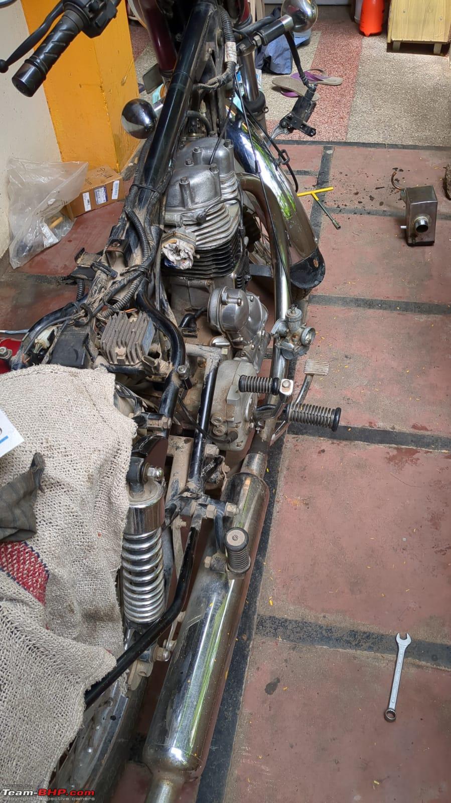

After the initial strip down of the bike
Restoring a neglected Royal Enfield Bullet Electra-whatsapp-image-20230902-10.01.19.jpeg

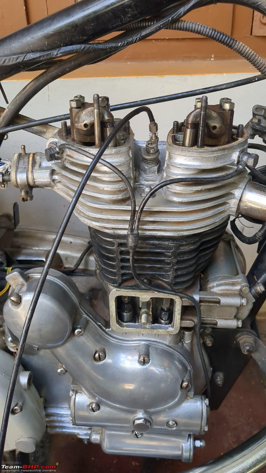

Oil replacements and inspecting the powerplant
I have drained the clutch case and engine oil and replaced both. Clutch is fine, no need of replacement. The primary chain looks OK on visual inspection but needs some tensioning. Drive chain and sprocket was replaced before the bike was left unused, and they are quite new and just need thorough cleaning. I was concerned about the banjo pipes being clogged and not carrying oil to the rockers. I have opened and inspected them, and ensured that oil is being carried. The tappets are quite tight, and need adjustment once the engine is running again. I have checked the wiring with a multimeter, and barring a few niggles, I was able to retain the existing harness with some fixes with insulating tape and heat shrink tubes.

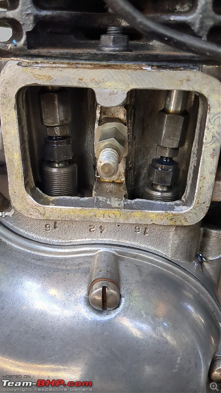

Inspecting that there is good lubrication to the rockers
Restoring a neglected Royal Enfield Bullet Electra-whatsapp-image-20230909-14.33.05.jpeg
Inspecting the Tappets
Restoring a neglected Royal Enfield Bullet Electra-whatsapp-image-20230909-14.33.17.jpeg
The spark plug was finally removed with generous amounts of wd40, and I have added oil into the chamber so that there is no wear due to lack of lubrication when turning the engine over.
The throttle cable was in very bad state and I have replaced it along with new spark plug as well. The breather pipe, gaskets, inlet hose and air filter are all replaced as it is better to change them when everything has been dismantled.

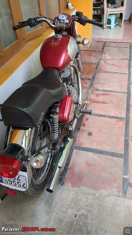

Here is a picture of both the beauties.
