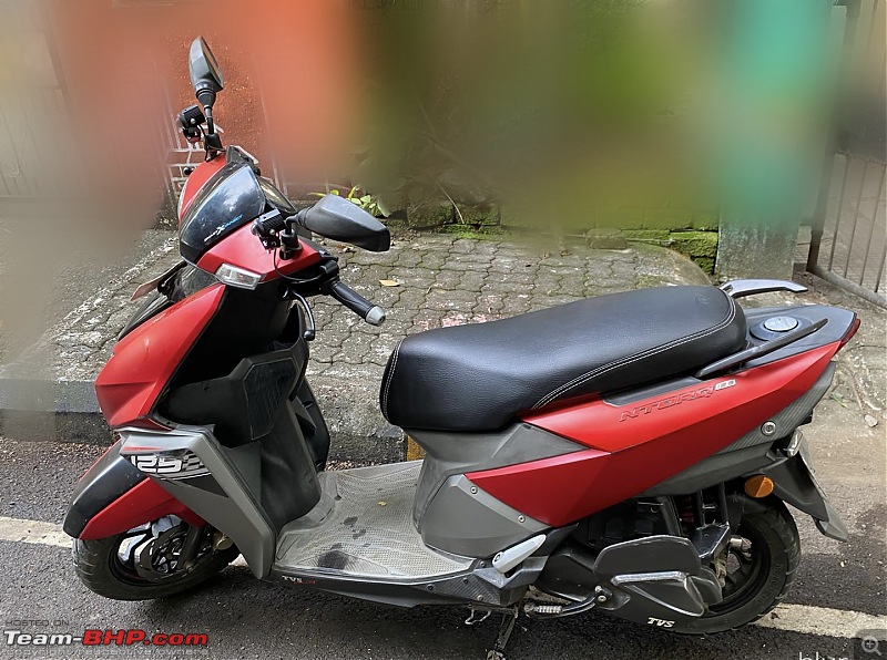

TVS Ntorq | Ownership Review and Mods for a 110 km daily commute-0a660dc3e7e94d97bdb4190296103aa6.jpeg
Still looks as fresh as the day we got her home. Note the glove box which is a TVS accesssory. Can easily keep a phone and not worry about it falling off on bad roads.

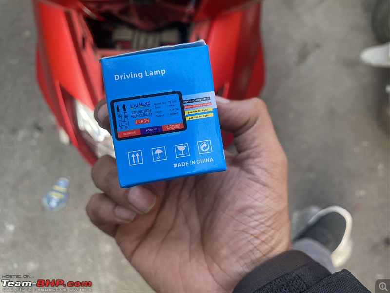

While checking the seat on the shopkeeper's scooter I saw these aux lights he had on them. He turned them on and they were switchable betwen white and yellow fog lamps. I was impressed. Convinced myself the LED headlamp I had wasn't enough. The auxs (auxen?) cost 1k which is a hell of a lot lesser than 2.6 L for a new bike. Of course the ones he gave were different from the ones on his scoot, 20 W each vs 25 W. I pointed out that they were different and he said 25W ones cost Rs. 2400 while 20W ones were 1000 bucks. I checked the throw on the cheaper ones and felt they would suffice for me. They were branded HJG and he told they were better than the China ones. So I asked about the warranty and he said there was no warranty. I then asked if these were also made in China. He said yes. I was too confused to take the conversation any further. Guess it meant the quality was different. Anyways the lights needed a switch which was another 300 bucks. Since this guy only sold parts he called a guy called Abdul two shops down from a place I think called Bike Point for doing the fitting. Labour was an additional 350. Now came the question of where to stick the lights. Above the number plate would involve drilling. There was a removable cutout in the panel next to the headlamps but I thought it looked ugly. Finally chose to hook it up below the mirrors and use the same holes as the mirror stalks. My only concern was affecting traffic in front of me but I was assured that the light would be focused on the street. Abdul was super enthusiastic and set off to work. He even assured me if there was any issues he was there to fix it. As it turned out he meant it.
TVS Ntorq | Ownership Review and Mods for a 110 km daily commute-aux-light.jpg
Note the brackets they're on are basically the ones used in scooter boots. Just realised the rubber stops now didn’t cover the holes. I also noticed the right indicator arrow and the yellow power mode lamp wouldn’t turn on. . Went back to Abdul.
TVS Ntorq | Ownership Review and Mods for a 110 km daily commute-aux-switch-wiring.jpg
Very little exposed wiring which doesn't look shabby at all.
TVS Ntorq | Ownership Review and Mods for a 110 km daily commute-aux-light-switch.jpg
The switch to control the lights. Up is white, down is yellow. Really doesn't look aftermarket.

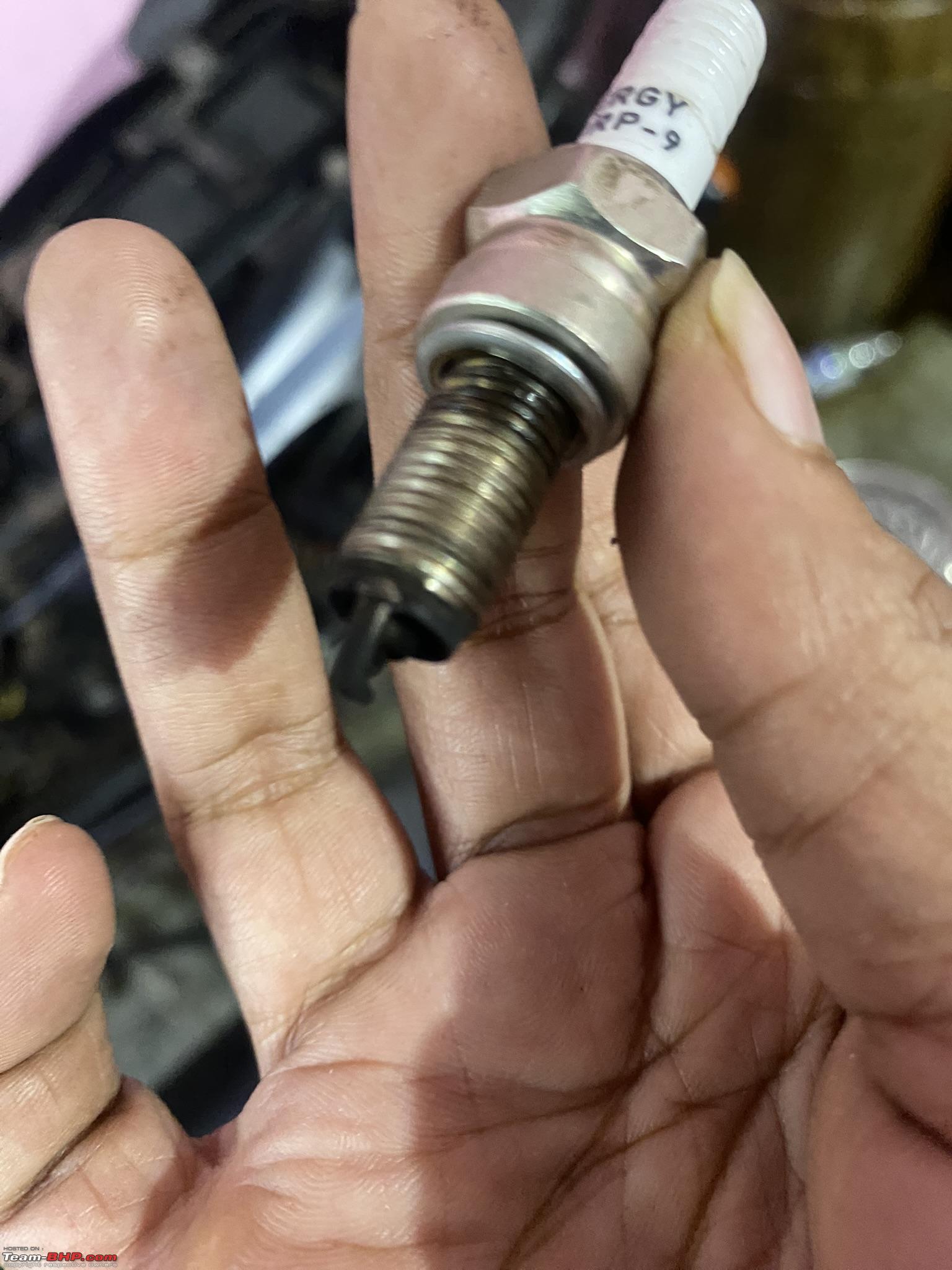

TVS Ntorq | Ownership Review and Mods for a 110 km daily commute-7b3c91de045746d895b634f4ab9d620f.jpeg
Out with the old.

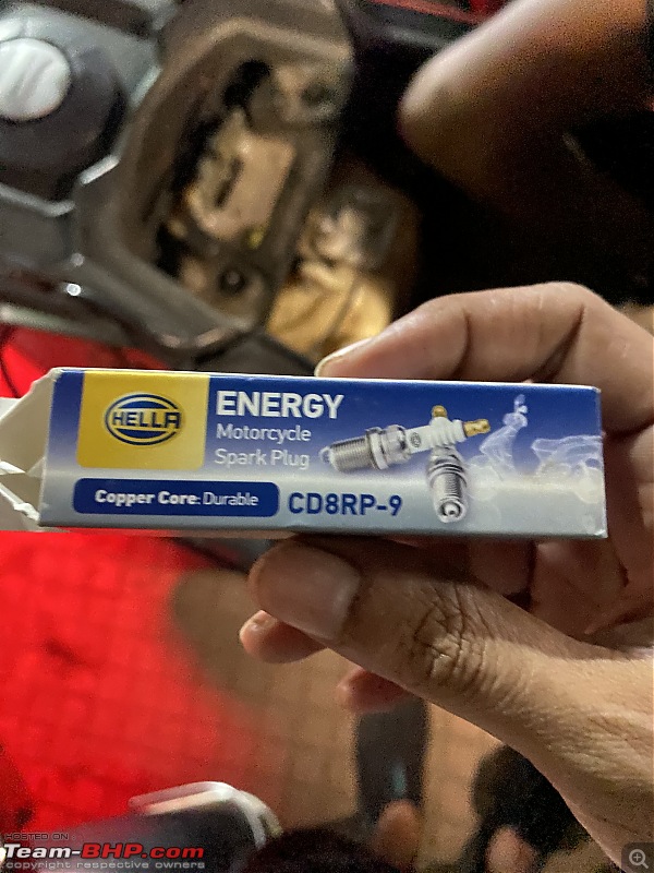

TVS Ntorq | Ownership Review and Mods for a 110 km daily commute-f3b65bfbc098408781c9a280f241fd4b.jpeg
In with the new.

The plug in the picture looks like it is running rich. Please tune the carb a bit leaner. Rich mixtures tend to foul the spark plugs easily. Before tuning make sure air filter is cleaned thoroughly and engine is sufficiently warm.Please check the plug rating.Hella plug rating CD8RP-9 must comply with the manufacturer's spec. data in the owners manual. My choice of spark plugs is NGK for any day. Enjoy your N Torq.
Very informative. Thank you. I'll have this checked out.

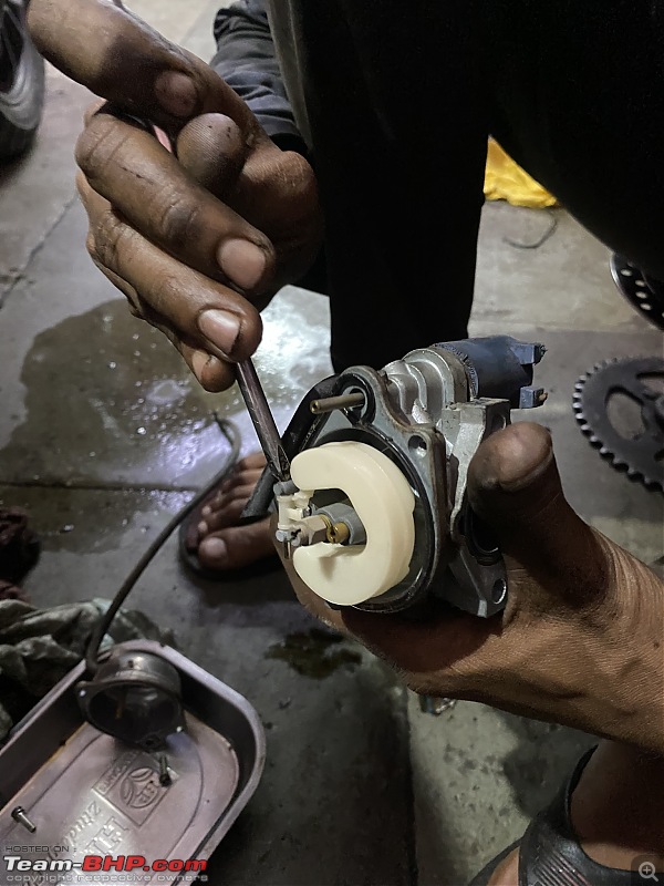

Yesterday morning the scooter was fired up after sitting for a few days. As expected had some starting trouble. The battery seemed weak. Anyways after a few kicks she was up and running. Drove up to work no problem while filling the petrol tank towards the end. After finishing work as I was about to fire the scooter up my worker came up and said he noticed a few drops of liquid near the side stand. This was right where there’s a rubber drain pipe. I checked to see if there were any leaks. Thought it could be some excess fuel and started driving. In about 10-12 kms I was on the Kharghar bridge (same one where my accelerator cable snapped, but in the opposite direction). I felt the scooter jerking and buckling under me and then there was no power. Somehow coasted to the side and parked. Turned on the parking lights which I had recently installed (they have now paid for themselves). Gave it a few kicks and she fired up. Drove again thinking it was a one off. Another 7 kms and same issue. This time ot took longer to get started but she did start. Now I knew I had to see a mechanic asap. So I took the stadium service road as I had no intention of stopping on the side of a highway again. The scooter again stopped in 3 kms. Kicked again, took longer but started. Managed to reach my usual mechanic, Subhash Automobiles, behind the petrol pump (opp. DY Patil). The minion mechanic available took a quick ride and said he couldn’t notice anything! However, I asked him to evaluate all possibilities. So he then proceeded to clean the carburettor.
Taking the carb apart:
TVS Ntorq | Ownership Review and Mods for a 110 km daily commute-4490ef0f963048d3ab4e6ca0a2f37a26.jpeg
Cleaning with petrol (taken from my own tank). A lot of crap was removed

The black washer (circled in red) needs to be aligned correctly and is tricky to put back in.

Then he checked the spark plug. As mentioned in my earlier post the plug hd just been replaced a few weeks back. Shockingly, it had gone bad. Maybe the grade was incorrect or the tuning was lean as mentioned by Enviroclan in a post above. I couldn’t find the manual so not sure what the grade ought to have been. Anyway, he put in a Bosch plug. I repeatedly asked if it was the right grade and he said they were using it on Ntorqs. Will get the carb tuned when the head mechanic is in next week.

Your spark plug looks to be fouled badly. It looks like petrol fouling which happens due to carburettor overflow. Overflowing carburettor seems to be a common issue with pre-bs6 TVS products. We have a TVS Wego and gen 2 Victor in our family. Both of them have left me stranded on road multiple times due to this overflow issue and both of them needed premature spark plug replacement. I also have a Honda Dio and I have never faced this issue with it. Also my Dio runs like clockwork even after running 40k kms with no special care. TVS products are really fun and comfy, but this bad experience makes me skeptical about their reliability.

Just got mine two weeks back, Ntorq XT model. It comes with blue tooth navigation. Was looking a replacement for my 2015 CB Xtreme which has just finished 1,52,000 Kms. Due to budget constraint had to settle for Ntorq. It now comes with hazard switch, and auto start stop.
Has been maintaing 30 to 50 kmph. Got 46 kmpl on tank to tank method. Scooter is good for city driving. Engine is smooth and initial pick up and engine braking is good. It comes with synchronized braking. Pressing the left lever brake is applied to both wheels, Pressing the right lever only front brake is applied. Still getting used to the brakes, no sharp bite, linear braking.
Suspension is not bouncy and for my height (5.9) I am able to sit comfortably. Once even travelled about 60 kms in city.
Was planning Yamaaha Aerox, but as per many reviews - hard suspension, flimsy side stand, no grab rail for pillion and more over it is costing over 2 lakhs in Bangalore plus varied millege ranging from 25 kmpl to 40 kmpl.
The Smart connect is good for most part. It records your jounrye details, kms, average speed. But somebody stupid has decided to omit Average FE, Instatenous FE which Jupiter gets. The navigation is Map my India. It gets to most places, but not like google maps. Another problem with navigation is somebody sends their location in whatsapp, you cannot open that link in the TVS app.
Completed about 500 kms. will update - Sorry for hijackning your thread
