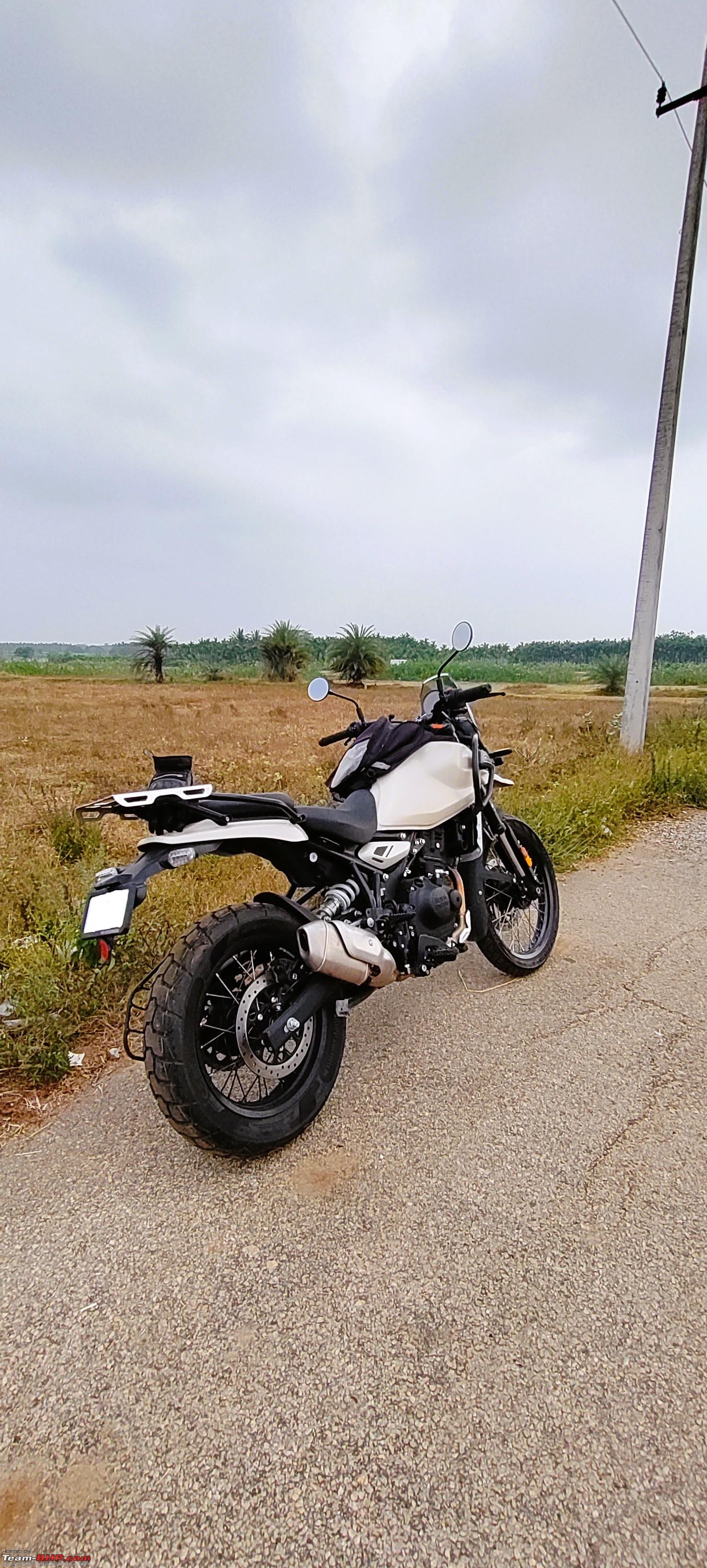

My wife & I headed out for a ride today morning towards Bellur Cross.
We initially stopped at Dhruvathare but decided to head to Hotel Mayura a little further for breakfast.
The handlebar realignment has made a significant difference as it has reduced my arm pain to a large extent but the pain persists while I am riding. I am positive it is due to the buzz from the handlebar, specifically from the right handle grip from 5000 RPM onwards. I am in the second stage of the engine run-in and hence not exceeding 6000 RPM, so can't say if this buzz disappears with higher RPMs. Will get Grip Puppies installed soon as I've heard it reduces vibrations to quite an extent.
My wife also complained of right knee pain from the buzz in the rear right footpeg. I guess a pair of riding boots will solve this issue.
However, as soon as we're off the bike, the pain is gone.
Some pics from today's ride:
