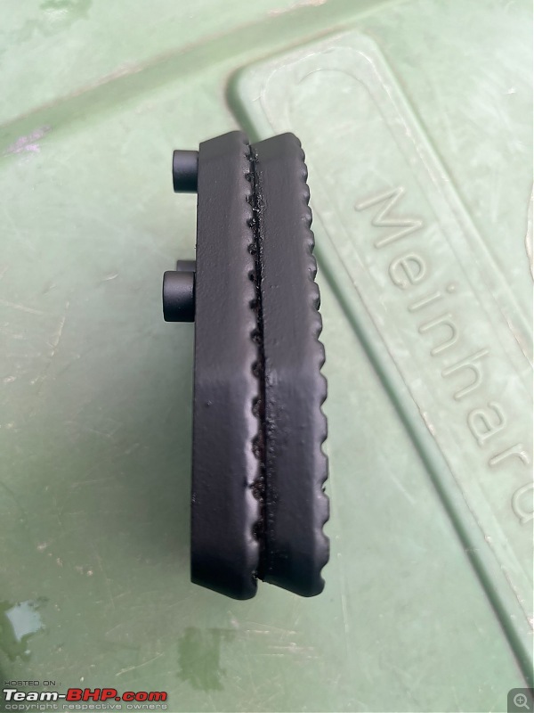

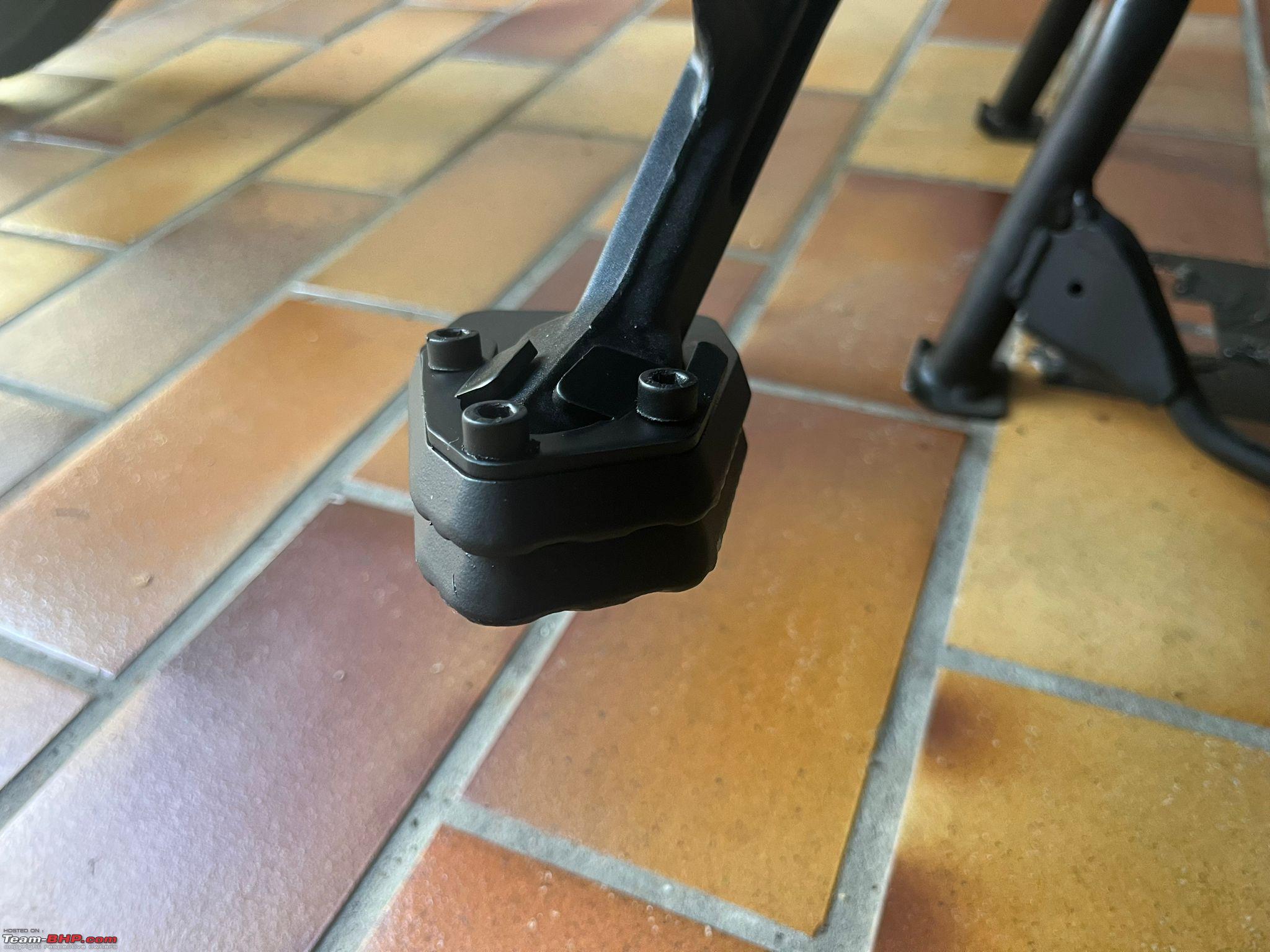

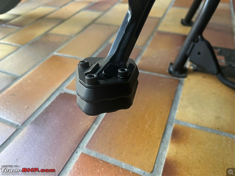

Originally Posted by Nilesh5417 View Post
Another query - has anyone found a solution to the extreme lean angle of the side stand? I was looking up on side stand extenders but not one has any dimensions nor foes the product description talk of whether how it impacts lean angle.
That's truly my top priority, to find an accessory that might fix this lean angle.
Thanks!
You can use the Zana side stand extender. There are two variants available:
https://www.zanamotorcycles.com/prod...tainless-steel
or
https://www.zanamotorcycles.com/prod...-himalayan-450
Both are stackable, which means that you can get two of them, get longer screws from a hardware shop, and have extra height increase. A friend of mine did it for his Himalayan 450:
I use one too, and it has helped considerably. Stability is top-notch when extended.

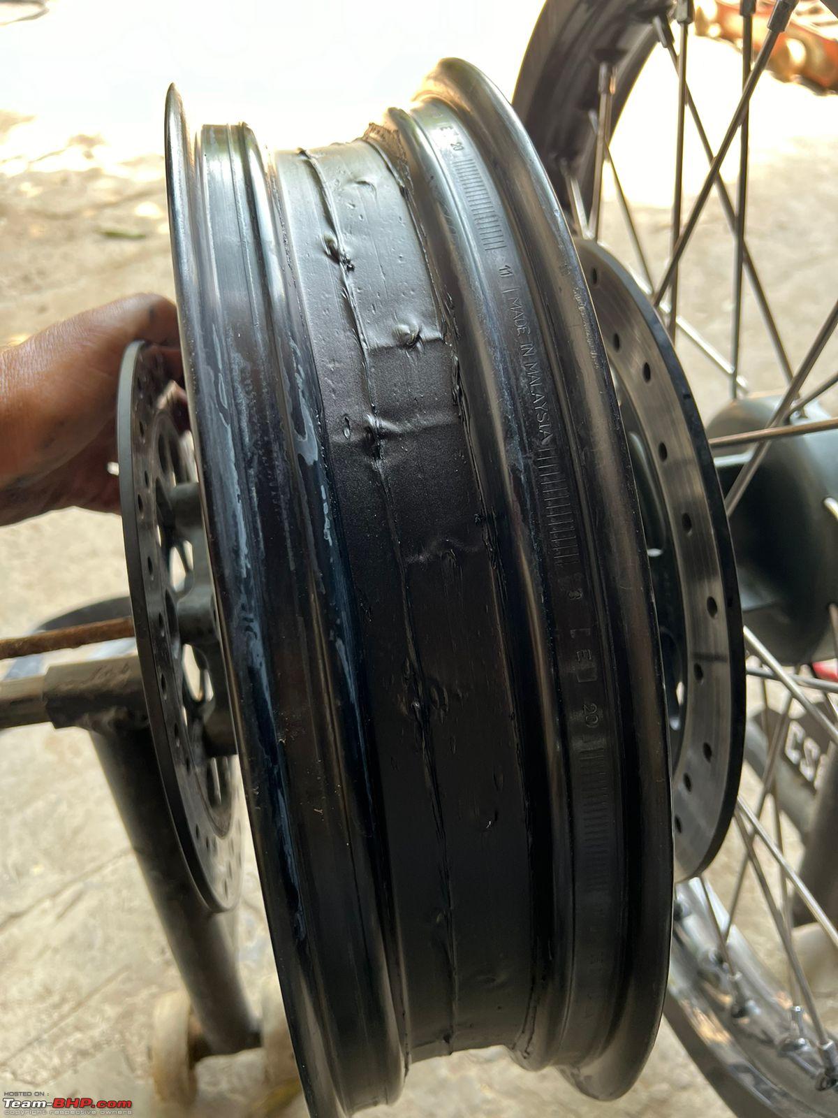

Originally Posted by Captain Slow View Post
The Black ones are made in Thailand - In the end its the same Company that makes them, Excel Rims
Mine said made in Malaysia. Reference image of my rim attached. It could be that different lots of Rims came from different manufacturers? Although ALL of them have the same problem - truing issues, causing the right side pulling issue.

Please don't generalise. Mine doesnt have right side pulling issue, and 'Im checking on every ride.
Whats happening is, because the suspension soaks up everything riders are just roughing it. I dont take potholes, and am careful on bumps. Can see how other riders are riding in our group.
*After this application, try and balance the wheel
Sebring is offline   (2) Thanks

Well nearly everyone I know who owns a Himalayan 450 in India and other countries has the issue. It could be that your dealership fixed it with rim alignment before delivery (idk when you got yours) or during service, or the newer lots have aligned rims. Although, my friend got one day before, and it has that issue.
The plant engineer I spoke to said that it is a rim misalignment problem. Mine occurred during the first 50km of riding the bike, was notified and then fixed by RE, similar to the handle damper issue.
I’m not generalising, RE has accepted the issue in 100%of the cases I’m aware of. A lot of people I know are okay with the problem and don’t want to go through the hassle.
Accepting that a problem exists is not a bad thing to do. I’m glad your bike does not suffer from that problem and wish you thousands of miles of happiness on it.
