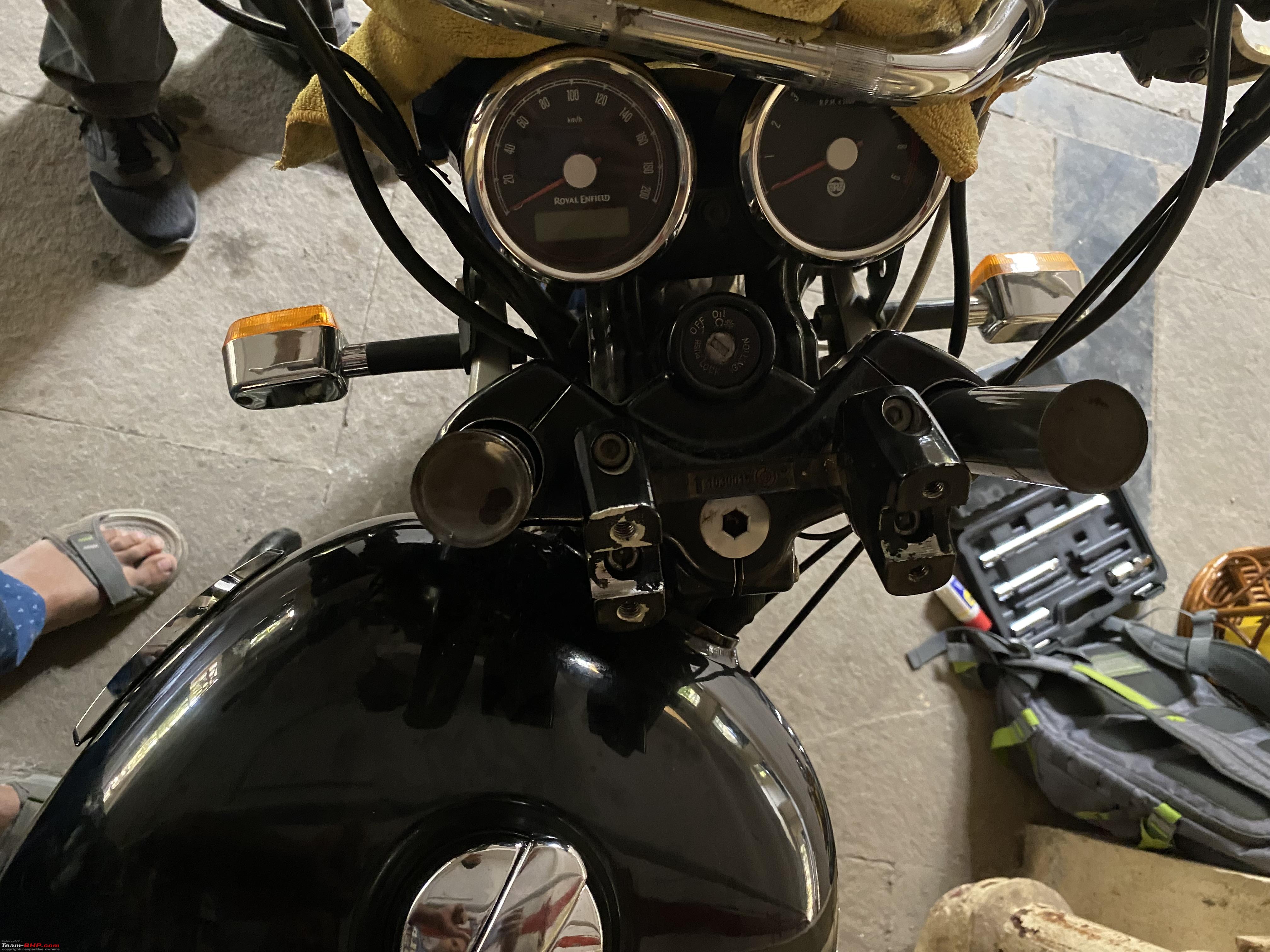

Big shout out to bhpian sukiwa; Not only did he order the preload adjusters (way back in October 2022) but also came down to my place, fully prepared with the necessary tools and installed them over the weekend.
Here's the man in his element!
DIY: Fitting of Marsh preload adjusters on a Royal Enfield Interceptor 650-img_6067.jpeg
I recently installed handlebar risers and that made the bike ready for the front fork preload adjuster upgrade.
After some planning and rescheduling, we decided to undertake the DIY on Sunday 4th Feb.

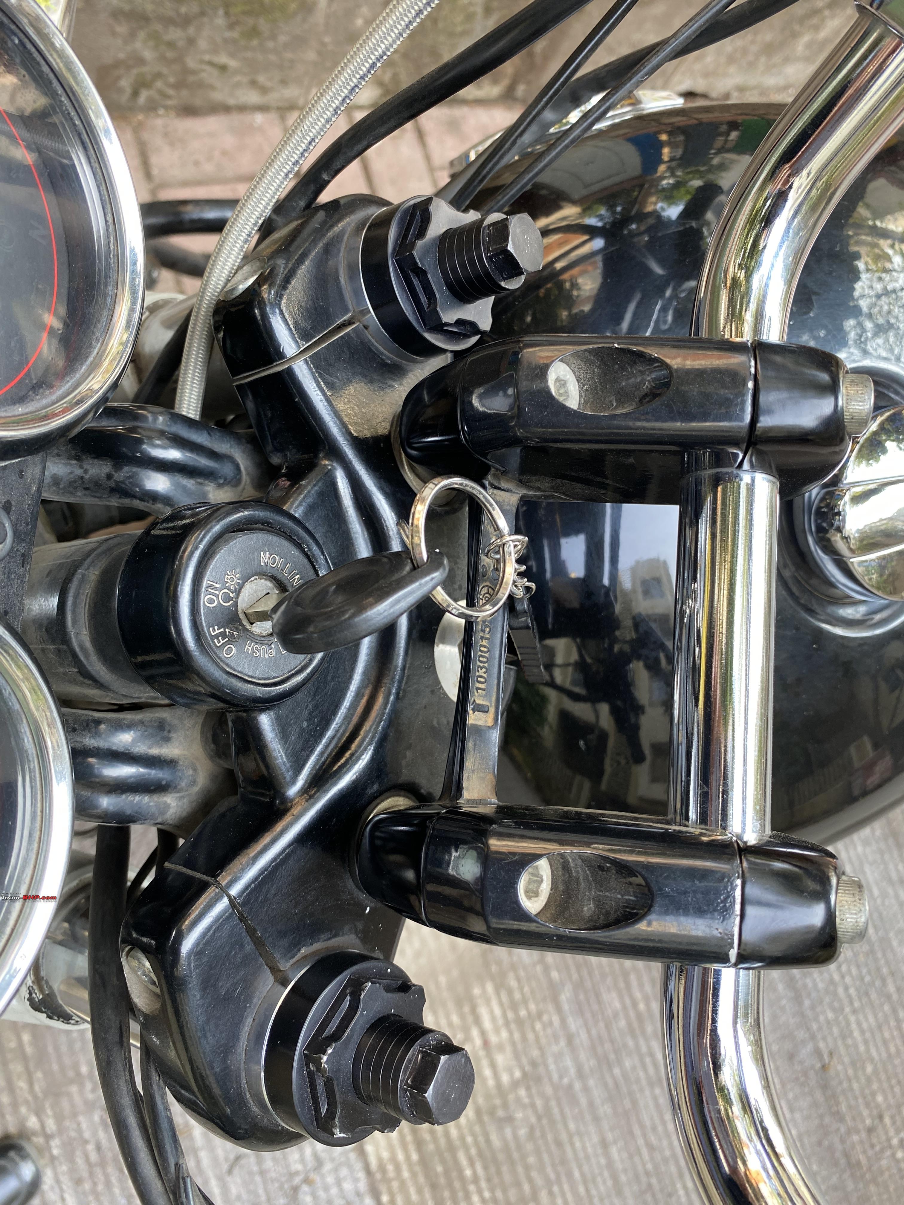

Step 1 - The handlebar was removed and flipped over to rest on the fly screen.
Here you can see the risers and the stock fork cap

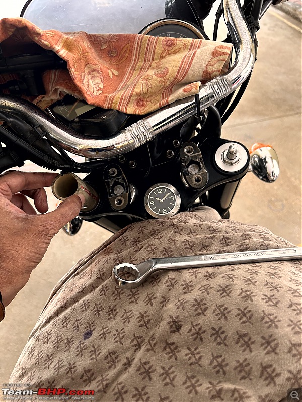

The cleaning cloth proved to be a good packing material to keep the handlebar in place
DIY: Fitting of Marsh preload adjusters on a Royal Enfield Interceptor 650-img_6069.jpeg
Step 2 - Removing the stock fork covers.
This proved to be a bit difficult as the stock fork covers were a bit over tightened. I had the fork oil replaced during the last service and I'm guessing that my mechanic went overboard while tightening the fork covers.
We took turns but the nut would not budge.
Eventually some wd40 was sprayed at the right places, the steering was turned to the lock position in such a way that the steering stop would provide support while we tried to undo the fork cap.
It needed a fair bit of pushing and heaving but finally we managed to get it off.

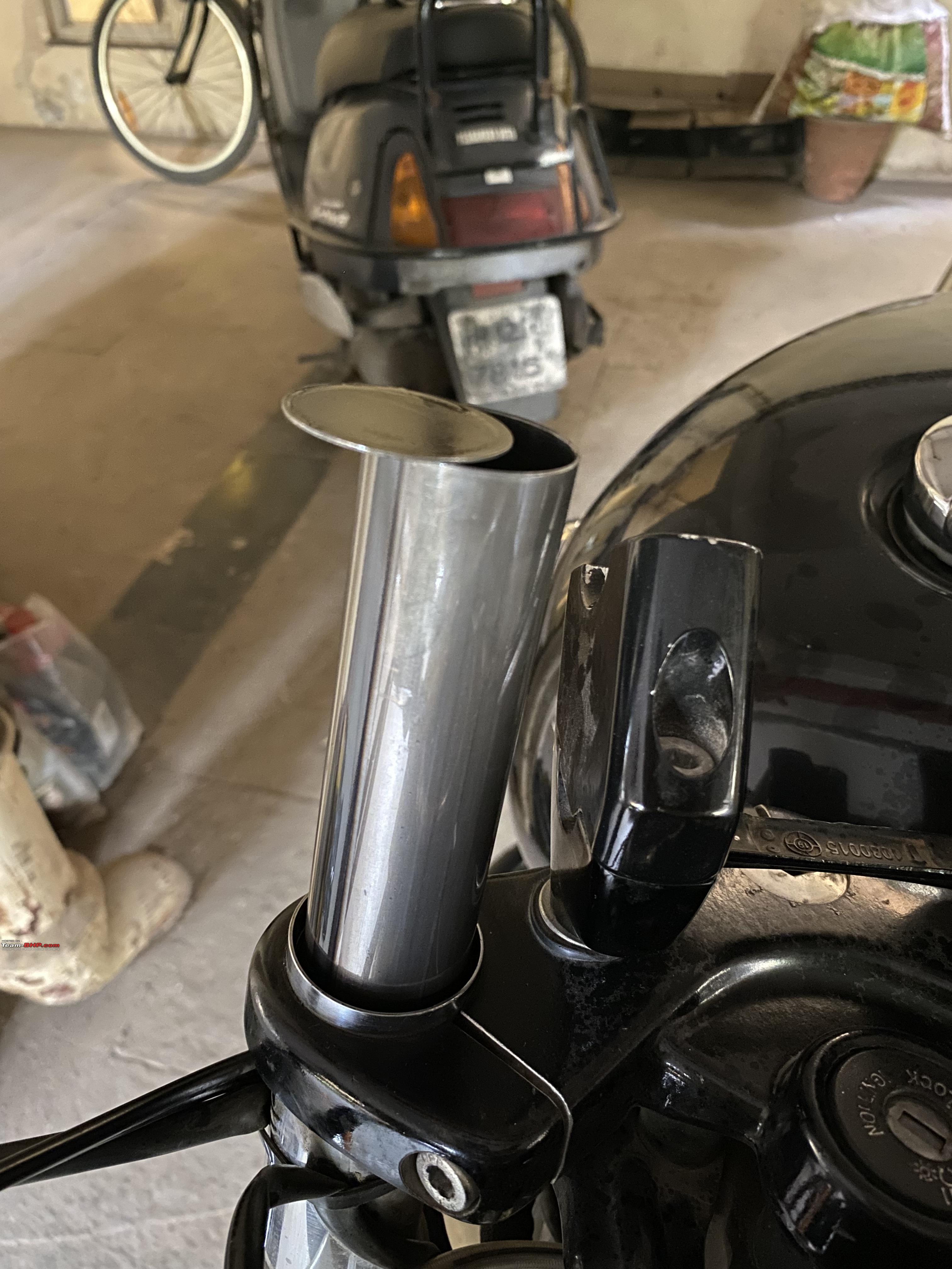

Caution - We undid both fork covers one after the other. This caused the forks to compress fully under the weight of the front end. This can be avoided by working on one fork at time.
The fork has fully compressed under the weight of the front, notice the difference in position of the triple clamp
DIY: Fitting of Marsh preload adjusters on a Royal Enfield Interceptor 650-img_6071.jpeg
Clearer picture, you can see the spacer jutting out from the fork
DIY: Fitting of Marsh preload adjusters on a Royal Enfield Interceptor 650-img_6070.jpeg

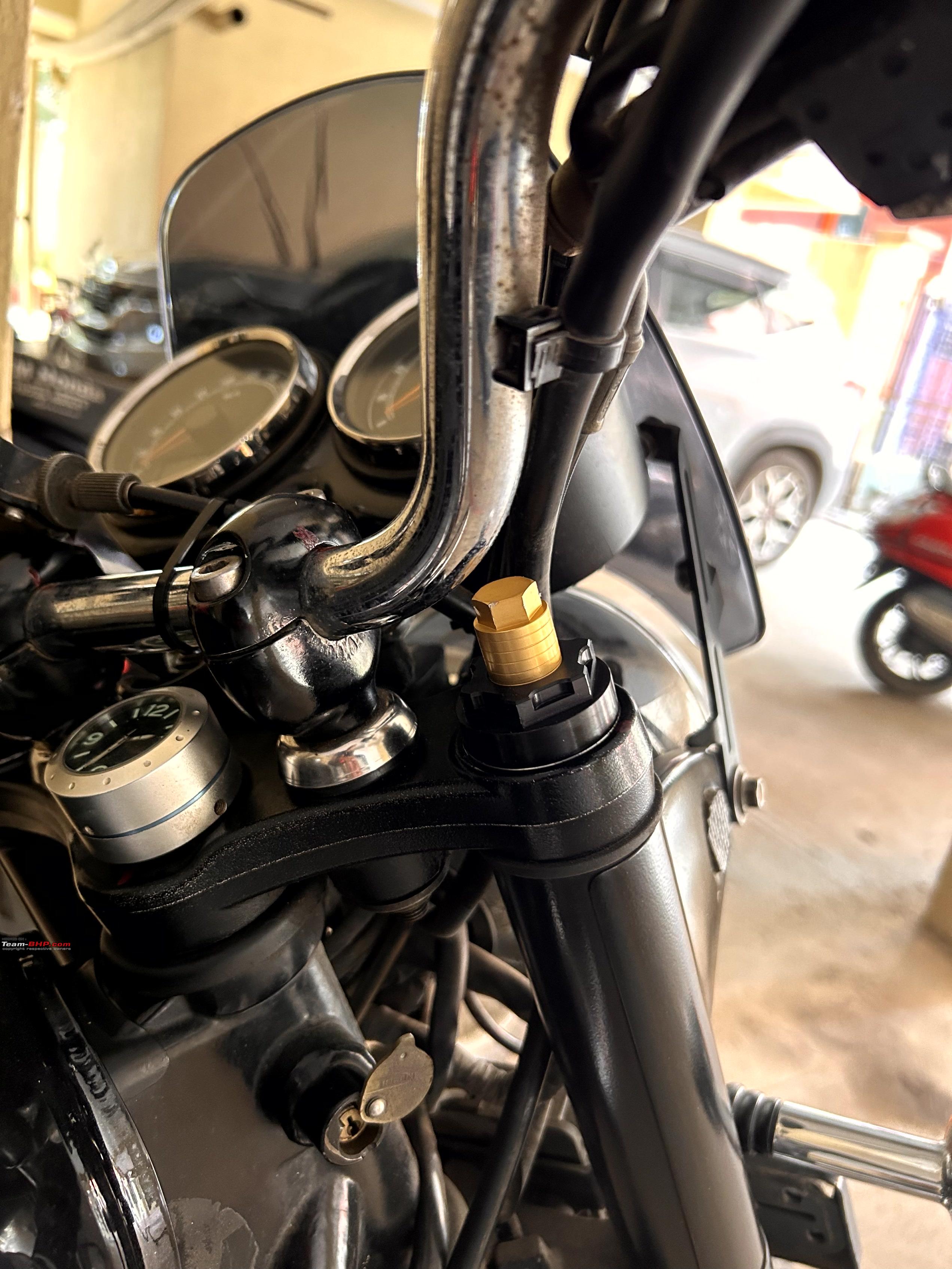

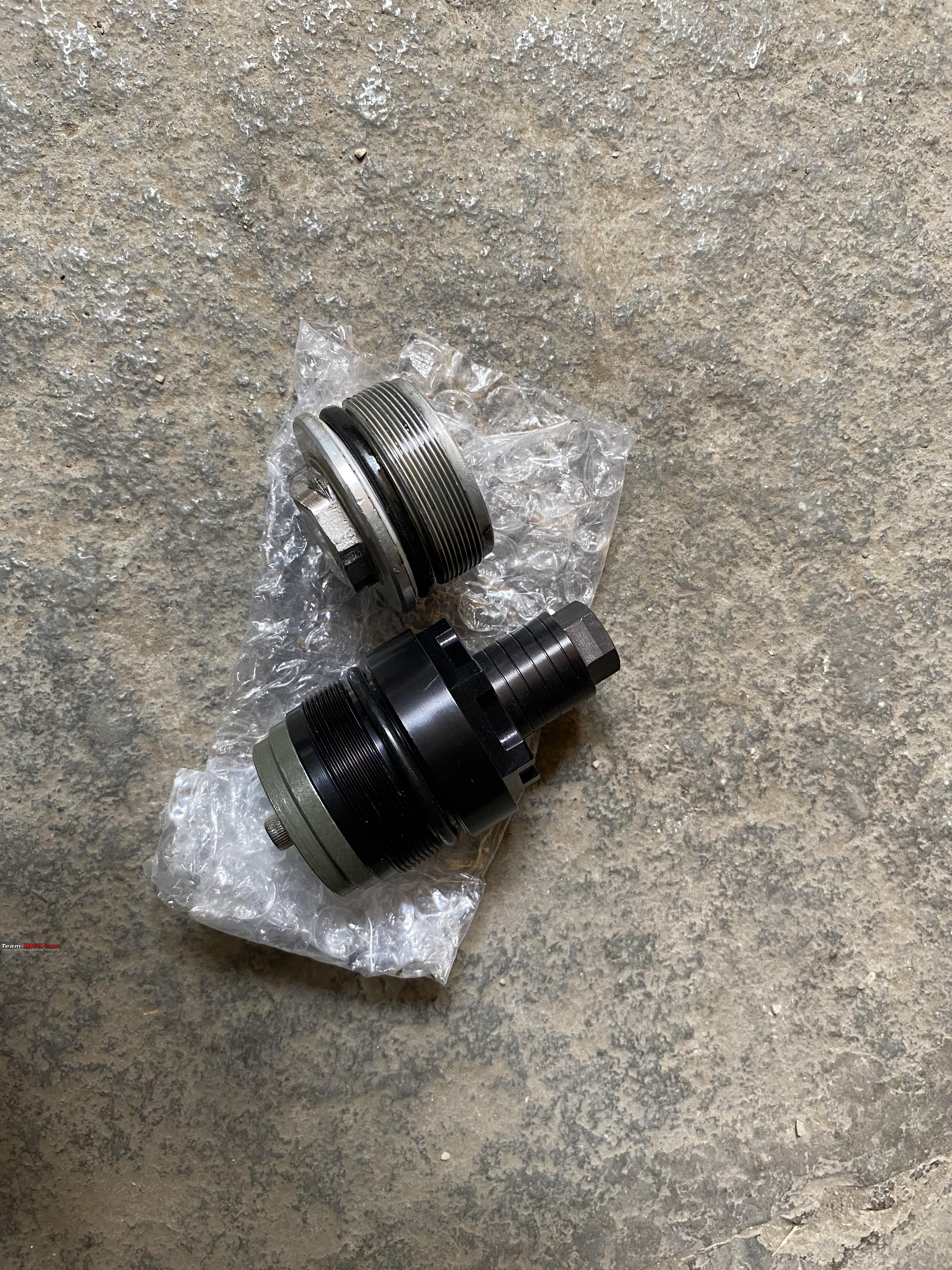

Step 3 - Fitting the fork adjusters
Since the fork was fully compressed, we had to push down the back end of the bike to extend the fork. Owing to the front heavy weight distribution of the interceptor, this is not an easy task.Sukiwa managed to push and hold the back end down while I fitted the adjuster on the RHS fork. Its a fairly easy process - you need to push down against the spring and rotate the adjuster in the fork tube until it latches onto the internal threads. Once this was done sukiwa could let go of the rear end of the bike and I continued to tighten the adjuster by hand. The spring does not offer much resistance - I could tighten more than half of the travel by hand.
Stock vs Aftermarket
DIY: Fitting of Marsh preload adjusters on a Royal Enfield Interceptor 650-img_6072.jpeg
DIY: Fitting of Marsh preload adjusters on a Royal Enfield Interceptor 650-img_6073.jpeg
The LHS fork proved to be a menace!
I could screw on the adjuster onto the RHS fork very easily but on the LHS it would not turn more than a quarter turn. It behaved as it there was something jamming the threads.
After taking turns in trying to fix the adjuster, we decided to inspect the threading. The spacer was removed and kept aside and the threads were checked. I could see some metal shavings stuck in between the threads. On the adjuster, we found that the black paint on the threads was coming off. Both threads were cleaned - first by a toothbrush and then by a cloth and then we tried fitting it onto the fork tube again.
This time we were able to get it to latch on but it was not screwing on freely like the RHS.
Nevertheless, we tightened it with a socket (M21) and proceeded.

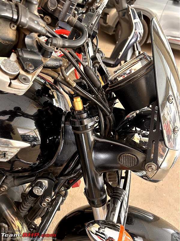

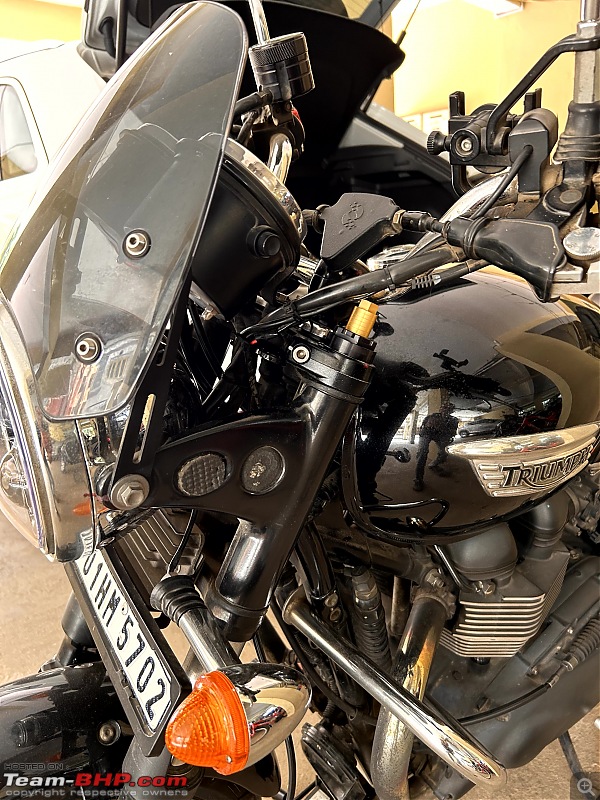

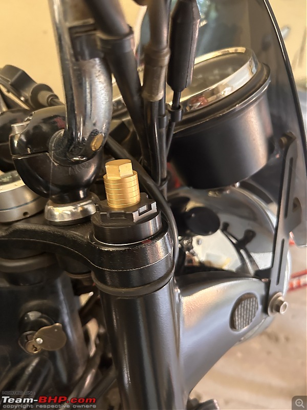

This increased reading # 2 from 460 to 465mm which meant the sag has reduced to 35mm.
Current position - 5 rings visible (5th is flush with the bottom surface)
DIY: Fitting of Marsh preload adjusters on a Royal Enfield Interceptor 650-img_6078.jpeg
DIY: Fitting of Marsh preload adjusters on a Royal Enfield Interceptor 650-img_6077.jpeg
We decided to leave it at that and for me to make further adjustments after trying out the bike over varying road conditions.
I use the bike for my daily commute to office and find the following changes:
1. The front feels tighter, the very persistant khat khat sound from the front end has reduced quite a bit
2. I feel that the front wheel is staying in contact with the road surface much better now. Extremely sharp speed bumps taken at moderate speed do not feel as scary as earlier.
Further adjustments would be made over the weekend (sunday morning ride) Will update this thread from time to time.
Suggestions if any are welcome.

The Marsh preload adjusters for the RE Interceptor got delivered couple of days back and as expected it was a straight fir for my Bonneville. Since I already had experience installing similar adjusters few years back the the same bike, I knew exactly what to do. Planned to do it today, so got everything ready by yesterday. First things first - The build quality of the March adjusters are really good, far better than what I have been running on my bike. They are heavier, built very well and the design is far superior. The Marsh adjusters are made for the Interceptor which means the existing spacer tubes can be used and it provides a 4mm additional preload than stock at stock setting. The spacer tubes of the Bonnie cannot be used in the same way as the Inty, so I calculated the length of the tube needed so that I get a 3mm softer than stock preload at softest setting and 15mm harder than stock at tightest setting. As I had done earlier, I used a 1.25inch CPVC pipe for the spacer. I have been using a similar setup last 5 years and it has held up well. When I opened the fork tops today, I could see that the earlier CPVC tubes were as good as new.
The following preparations were done beforehand
- 2 spacer tubes in CPVC of the desired length\
- 2 washers with center hole to be placed on top of the spacer tubers before the adjuster is screwed in
- The required tools
- 32mm ring spanner to tighten the Marsh adjuster
- 19mm box spanner to remove the old adjuster
- Stanley socket and allen set
- Scissor jack to push up the bike so that front wheel is off the ground and the forks are fully extended
- Rags and clothes
- White petroleum jelly to lubricate the threads before installing
- Masking of the marsh adjuster mounting nut and adjustment nut with teflon tape to prevent damage
Went about the job in the morning and could finish it in 45 minutes since everything was planned and things were in place. Really happy with the outcome especially the looks - the black adjuster with the golden stem really looks good on my black bike. Performance as expected was good and similar to what I already had. Happy to have the same performance from a made in India product of much better quality and good looks.
The process is not being explained as it is similar to the ones explained earlier in this thread.
Some pictures of the install

If you do not want the risers, just get the preload adjusters for Royal Enfield. It is listed at a price of 2899. This is what I bought and installed on my Bonnie. It’ll be the same for the Street Twin as well as it has also got 41mm forks. Just check if there is space for the adjusters under your handlebar. In case there is no space you might anyway need the risers. In the Bonnie the bottom of the handlebar was slightly offset and so I did not need the risers. See the attached photo. Ideally you might also need a shorter length spacers inside else the spring might be compressed more than stock when you use the adjusters, so at the softest setting the preload will be more than stock if you use the same spacers.
This will also work well when you change the springs, just make sure you use the correct length of the spacers depending on the difference in length of the springs. In fact, I'm using progressive springs from Tec Bikeparts since the last many years
