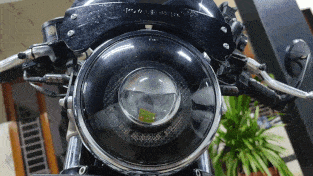

The Headlight Saga :
I appreciate RE for going with LED headlights with this generation, but I find them to be underperforming for my needs. One thing I wasn't happy about was the new plug they have for the headlights. They resemble the old Harley 4-pin coupler and this makes it a hassle to install aftermarket headlights.
For my 1st aftermarket headlight I custom made a coupler by extending wires from the H4 plug to the OEM socket. This was troublesome as I did not want to modify the original plug so I can revert back to OEM headlights in the future if there be a need. Though it was good, i though the high beam performance could be better and wanted to switch to a different one. This time, I had no patience to make any custom couplers and outright added a H4 socket to the OEM harness. I've added a picture to understand what i mean. Now, I have both the OEM socket and a H4 socket for aftermarket options.
Royal Enfield Continental GT 650 : 10,000 kms User experience, Review & Modifications-h4-headlight-connector.jpg
I purchased my second aftermarket headlight based on popular internet opinions but found the high beam performance to be bad. Was looking for a replacement and landed with the 3rd one. I definitely would have settled with it if not for one issue. The high beam was good and all but the beam was too strong and too wide that it literally blinded everyone in-front of me. Many may not consider this to be an issue at all but I cuss at people for using blindingly strong lights and I don't want people cussing me for the same.
Royal Enfield Continental GT 650 : 10,000 kms User experience, Review & Modifications-old-headlights.jpg

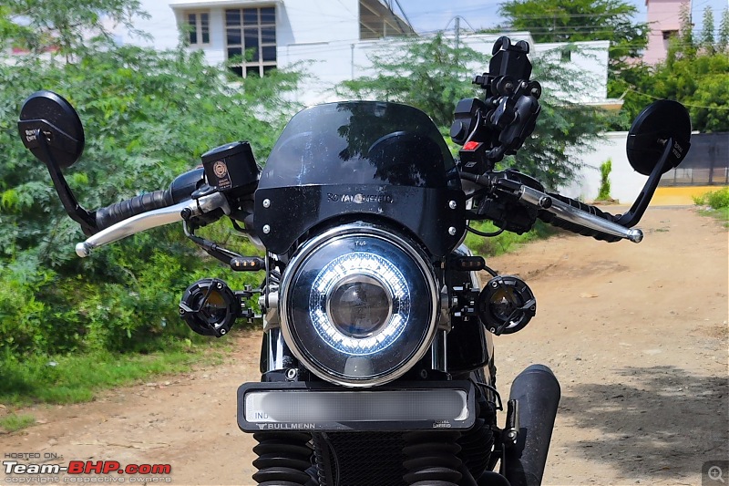

I was in the market for headlights again and that's when a friend suggested I look into Vaishnu's LED projectors. Though they were pricey, the YouTube reviews were promising and after 1 week, I had it in my machine. Lo and behold, this was just perfect. I've attached several images of the headlight's performance and I believe the pictures would speak for themselves. And you know what, they had a version that plugs into the original harness. A win-win situation for me. Remember to adjust the dome elevation if you too plan on installing this headlight.
Royal Enfield Continental GT 650 : 10,000 kms User experience, Review & Modifications-headlight-drl.jpg
Royal Enfield Continental GT 650 : 10,000 kms User experience, Review & Modifications-white.jpg
Royal Enfield Continental GT 650 : 10,000 kms User experience, Review & Modifications-yellow.jpg
Royal Enfield Continental GT 650 : 10,000 kms User experience, Review & Modifications-mixed.jpg

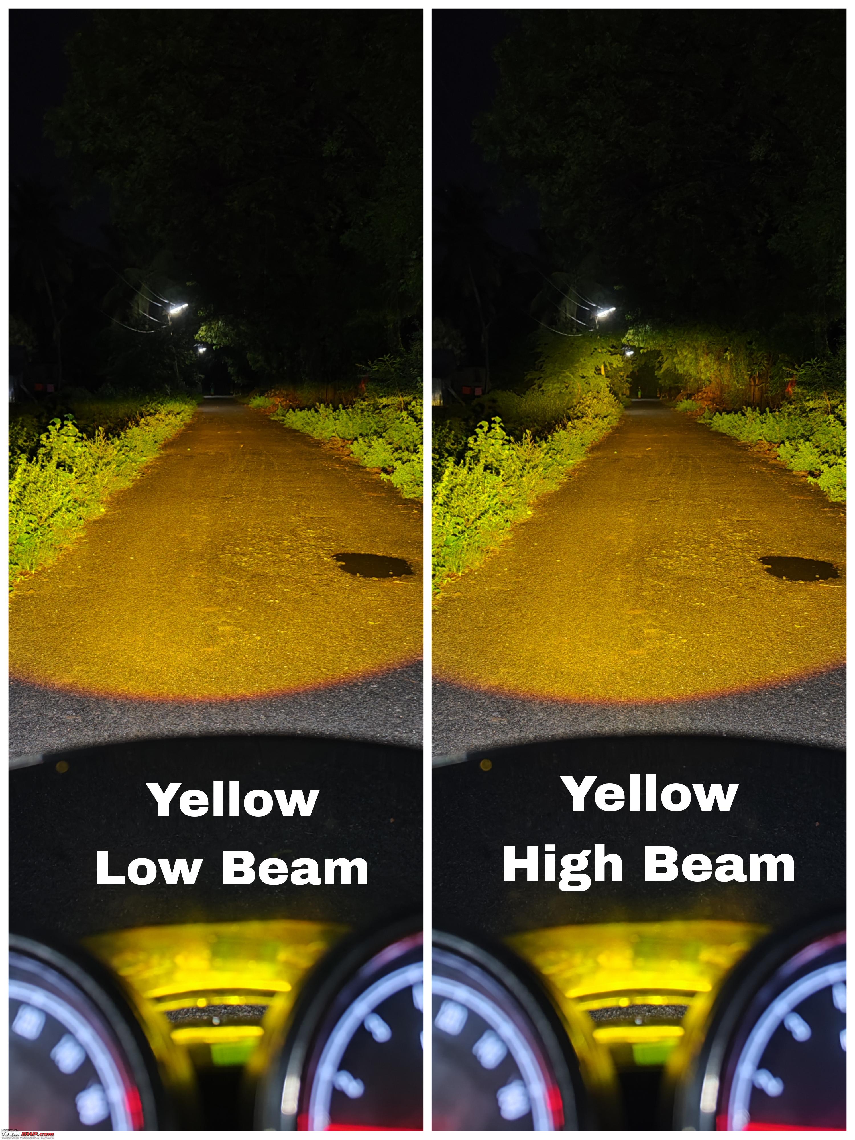

Vaishnu projector headlight : 8k-9k (depending on the model)
Pros :
  1. Brilliant road illumination.
  2. The cut-off level for low beam doesn't disturb oncoming vehicles. This one I love.
  3. The power consumption level is similar to that of the OEM headlights, meaning they won't take a toll on the battery.
  4. Comes with a DRL, so the projectors don't have to be running all the time (BS6 compliance).
  5. The high beam is focused to a spot. No unnecessary spreading.
  6. Comes with 3 colour modes. Pure white, yellow and Mixed.
  7. Comes with its own harness and it's direct plug and play. No cutting of wires necessary.
Cons :
  1. The price. Many won't find it logical to spend close to 10k on a motorcycle headlight.
  2. The high beam performance on the pure white only mode lacks range. The yellow mode doesn't have this issue.
  3. Make sure the controller relay connectors don't get exposed to water (during water washing) as those aren't water tight and can lead to a short (personal experience).

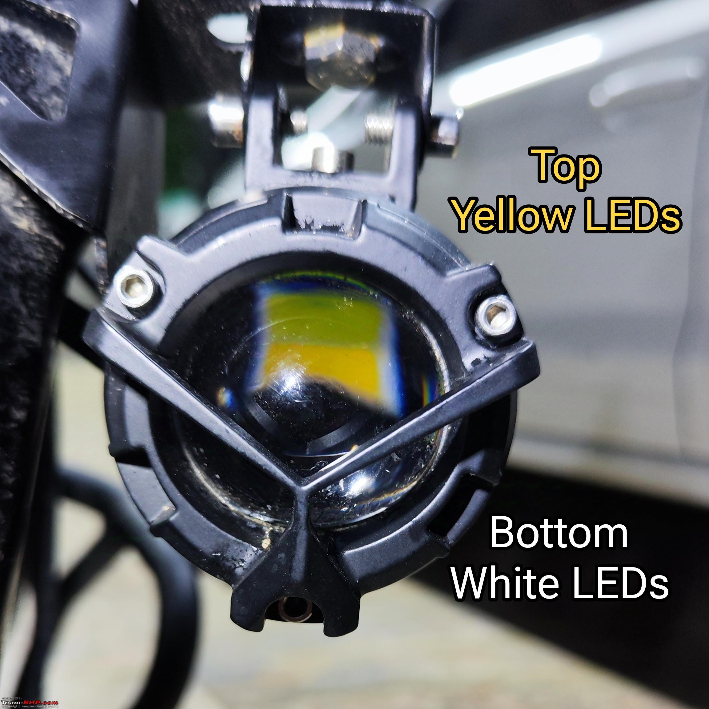

Auxiliary lights :
Sometimes, I find myself riding through deep and dark forests all alone and would have a difficult time trying to visualize the periphery of the road. There a no street lights, it's pitch black surrounded by a dense forest. Road visibility wasn't an issue but I preferred to have some peripheral illumination too. This led me into the market for some good auxiliary lights. I wanted to go with projector type lenses instead of the more common reflector type lights as I can have better control over the direction of the light beam.
After some surfing, I landed with the HJG Megadrive fog lights (locally known as the HJG mercedes / Y fog lights). This too came with two sets of LEDs, pure white and yellow. The perfect match for my headlights. Check attached image for the performance.
Royal Enfield Continental GT 650 : 10,000 kms User experience, Review & Modifications-fog-light-close-up.jpg
Royal Enfield Continental GT 650 : 10,000 kms User experience, Review & Modifications-white-yellow-fog-1.jpg
Royal Enfield Continental GT 650 : 10,000 kms User experience, Review & Modifications-fog-coverage.jpg
MotoTorque fog light mounts : 800/-
HJG MegaDrive Fog Lights : 3800/- locally, 4500/- on amazon
Fog lights without the harness : 2000/-
Pros :
  1. Being a projector type lens, beam direction can be adjusted according to requirement.
  2. Three different modes. Pure white only, yellow only and both running simultaneously.
  3. Comes with its own harness. No wire cutting necessary. (There is also a version without the harness but I wouldn't recommend it as the power draw puts a strain on the original harness. Will only suggest for people with an already existing auxiliary light harness)
Cons :
  1. This is one thirsty set of lights. Each unit is rated at 60W max and you get two in a box. Make sure your alternator output is sufficient enough so you don't drain your batteries on extended use.
  2. Never, I repeat, never use it when there is oncoming traffic. The guy in the opposite vehicle would not only cuss you but your entire ancestry. These are lights that are meant to be used in heavy fog and in some cases like mine and not for general road use.
  3. While running both colours simultaneously, the brightness is lower than running them individually. Maybe a power limitation.
  4. For some reason, there is a button for strobe light function. These lights are already too bright and this will just annoy other vehicles even more. Just forget that it exists.
  5. It's bulky. This restricts where it can be mounted

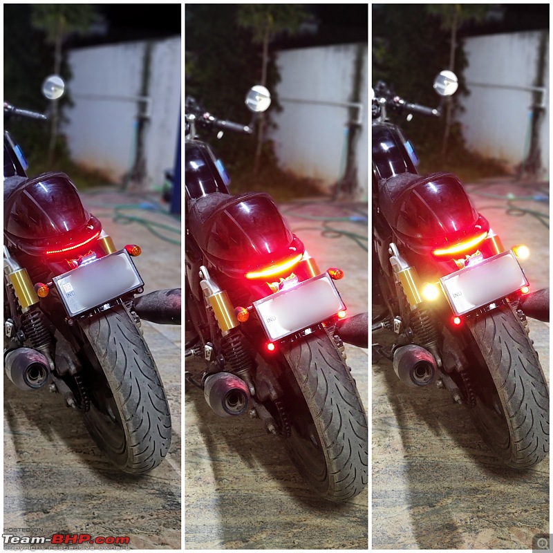

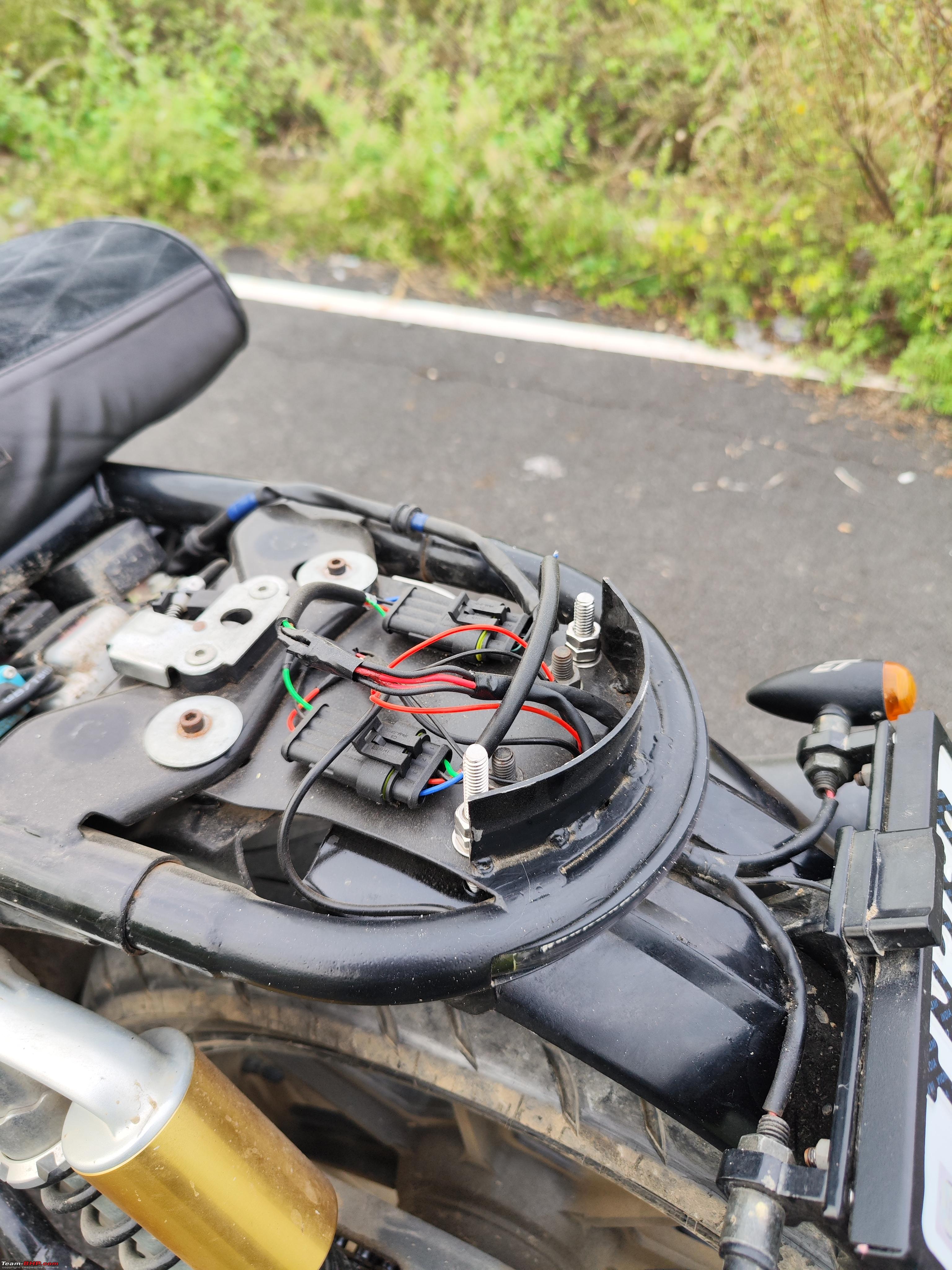

Rear Short Frame :
This mod was one of my long term wishes for my motorcycle. Many adviced me against this as it not a practical mod and you can't have pillions anymore and so so. But, being a hardcore fanboy of cafe racers and the GT being not a comfortable choice for pillions to begin with, I just went for it.
I did make a bad move at one step though. Choosing the right shorty tail frame vendor. Long story short, I regret going with JD customs, should have gone for the MK designs one.
If you don't wanna know the full story, skip the next couple of paragraphs.
So, made up my mind to chop my frame. Found two online stores who make custom shorty tail kits for the 650 twins, MK designs and JD customs. What made me go with JD customs were these things.
  • The photo on their website showed a flush set-up with no gap between the cowl and the frame.
  • I liked having the rear lights on the frame rather than having it sit on a separate frame.
  • It was 500/- cheaper than the MK designs one.
Also, I confirmed through a WhatsApp conversation with JD customs that whether the lights are plug and play type with their own harness plug and he said "YES", but did it actually come with it. You guessed it, IT DOESN'T. Just blunt tips from the LED strip.
The frame chopping part took only a couple of minutes and the installing the shorty kit was quick. Drilled a few more holes on the kit for the numberplate frame too. But, as soon as I put back the seat on, that's when I knew I got screwed. A huge gap between the frame and the cowl base. Believe me, it did not look good at all. Verified if I was missing something or doing something wrong and No, I wasn't. Had to weld in a piece of metal and spray paint it to match the body. Check out the added pics to see why I'm mad. Now I understand why MK designs made a separate frame for the LED strip. Knowing I have to cut the harness, I actually bought an extra from RE and chopped it up.
Royal Enfield Continental GT 650 : 10,000 kms User experience, Review & Modifications-tail-without-shroud.jpg
Royal Enfield Continental GT 650 : 10,000 kms User experience, Review & Modifications-tail-shroud.jpg
JD Customs Shorty kit : 6000/-
MK Designs shorty kit : 6500/-
Additional costs incurred for installation and welding : 600/-
OEM Taillight harness from RE : 850/-
Pros :
  1. The shorty frame kit does look good from a distance.
  2. The LED taillight strip is bright enough, even for daytime use.
  3. Would recommend only for committed cafe racer fans (also recommending to go with the MK Designs shorty kit). If you have second thoughts, maybe you best wait.
Cons :
  1. No backsies. Once you've chopped the frame, you have to live with it. You can switch for a longer frame if you want the longer seat but a cut frame is still a cut frame.
  2. The pictures on JD custom's website were misleading. That gap between the frame and the cowl is bad.
  3. Without the welded piece, Dust and debris don't have any trouble making it under the cowl and seat.
  4. No plug and play stuff. You have to tamper the harness and solder it.

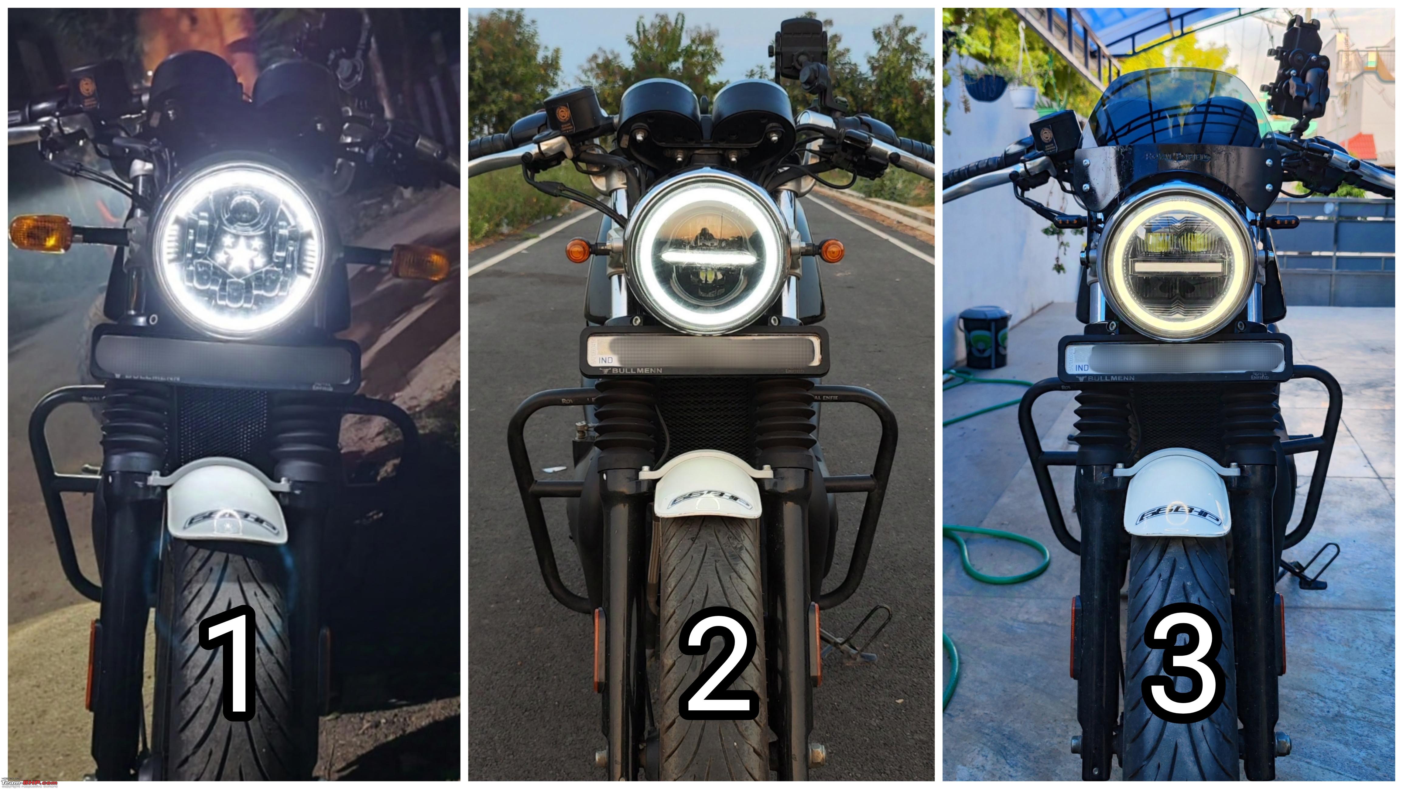

Thanks for sharing the details. This is a perfect thread when I am looking for headlight upgrade for my Meteor 350.
Now I can see the dual tone headlight price has increased to 12k . Now I am confused where to go for Vaishnu's touring headlight or keep the stock one (Non LED one ) and add Aux lights .
Checked the pricing myself after reading your comment, Sir. Yes, the price for the newer Type C DRL is a jaw dropping ₹11,900 . The older type A & B are now at ₹9k & 10k respectively. If they are not to your liking, you can definitely go for a good set of aux lights which would only cost you half as much.

Regarding the headlight upgrade, Vaishnu was the first and only upgrade I considered because it was the only projector option when I got it (still is afaik). And it was definitely brilliant as you said.

For the Halogen bulb connector, did you strip the original wiring loom insulation and join the wires to that? Do you have photos or color codes for the positive and neutral connections? I do want to attempt this modification. Not that I ride at night or need brighter lights. Just for the heck of fiddling around and learning the process.

For the lights, yes I stripped the insulation from the original harness and connected the wires. I don't exactly remember the colours, but I'll share the pin config. ( This is the config as far as I remember, but just to be safe, please do test it yourself if the connections are correct before finalising the set-up. )
