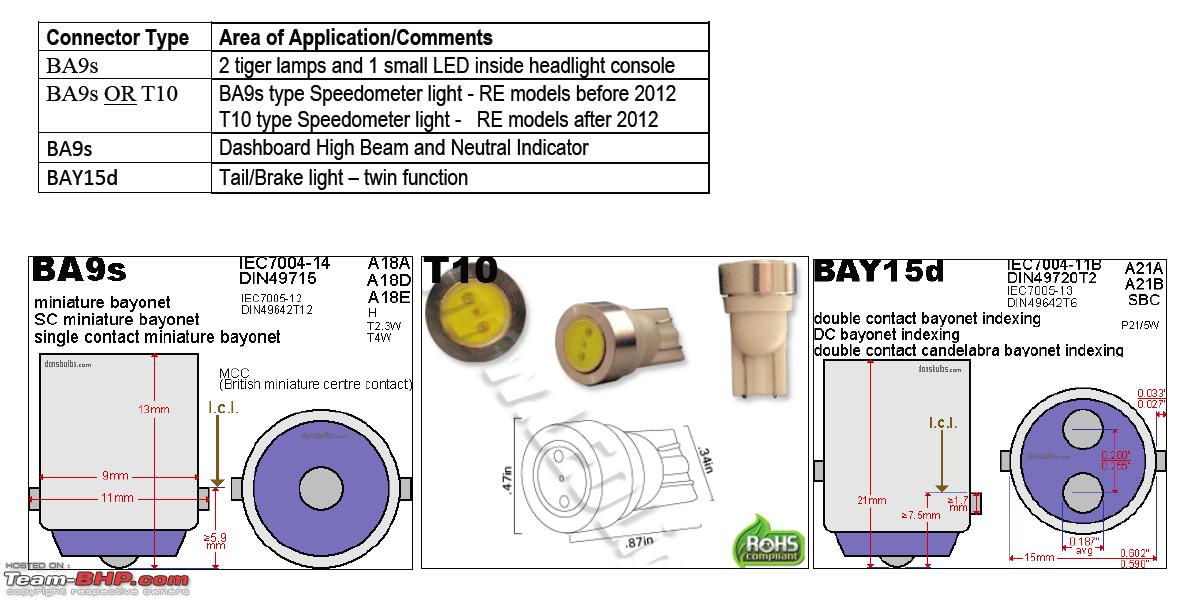

Has anyone replaced their pilot lamps with white LEDs? If so is there any specific bulb specification?

here you go ... 12V and a wattage significantly lower than the original fitting, other than that there really is no fixed specification. it all up to the creativity of the assembler. most have multiple SMD LEDs (6, 12, 14, 27 etc)
SMD manufacturer is more important. e.g. Cree, Vishay, Philips, Kingbright and a host of Taiwanese, Chines & Korean makes!

Ok, this helps a lot. Thanks a lot for sharing. I tried to just search BA9S leds on amazon, and found the prices in the range of like 700-800+. Are these so costly?
Now this is where it gets tricky. The market is flooded with ultra cheap Chinese fakes in the absence of any established brands. Installing such lights is barely legal in most countries.
On one of my recent recce trips to Karol Bagh market I saw some selling as cheap as Rs. 80/pair.
Rs. 700 to 800 for each sounds expensive but is not unusual - some are sold as 'luxury LED' upgrades on eBay with ridiculous price tags. It might be a USA branded one rather than from a no name Chinese source. Check with the seller about the origin and warranty.
Decent quality ones should be within Rs 150 to 600 each. (i.e. approx. US$ 2 to 10 each). I ordered mine from Aliexpress but it's a jungle out there - very difficult to spot the real ones from cheap imitations. I ended up with some lemons too in the process.
