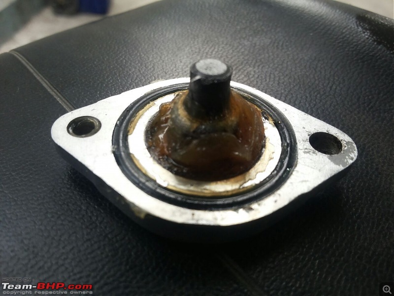

Now when I saw the drain plug near the Brake footrest, I found out they (RE SC) used some kind of goop to keep it from leaking, when I complained to them each time that oil was dripping.

Now I drained the oil again, removed the restrainer from the engine, replaced the oil filter again, tried to get as much of the oil as possible from the drain plugs. put back everything together....
Here's how the drain plug looked like,
One of the left screwed up by RE, and the new one on the right.
