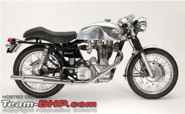

My goal is to turn it into a cafe racer, something more along the lines of this:

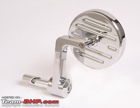

One more question: anyone know where I can get bar-end mirrors like this?

About bar-end mirrors, you can get the from abroad. Don't think its available here.

Do you have a higher resolution version of the 2nd picture in your 1st post?
eBay - New & used electronics, cars, apparel, collectibles, sporting goods & more at low prices
You will come across many links from Hongkong & Singapore, I bought a pair of O.E.M. replacements for my 954 that cost me 1500 INR inclusive shipping. The fit and finish is definitely on the better side, and they are superb bang for the buck compared to the 6K quote I got for a pair of O.E.M. mirrors.
