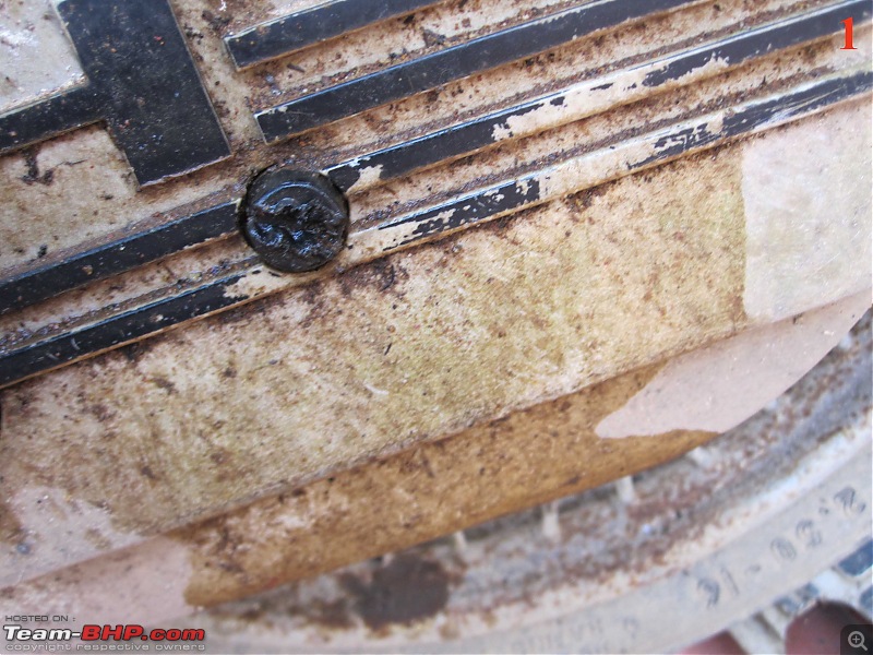

Also in the last pic .The screw which covers the plastic chain cover refuses to come off .It has a rubber head.Where can i purchase these type of screws?
It's a regular 10size bolt with a plastic head. The plastic head is pretty soft and if you have to use a thick - screw driver to get it out without destroying the plastic head. But anyways since the plastic head is almost gone in that picture you will have to pry the plastic head off and use a 10size tube wrench to get the bolt out.
