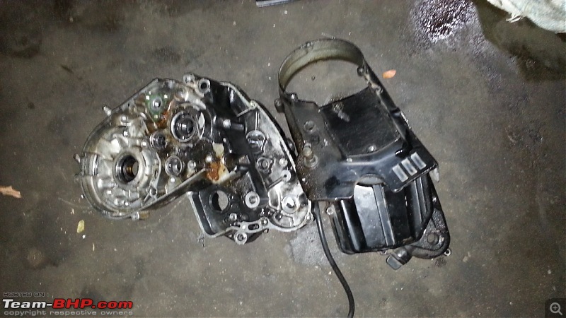

The engine was demounted from the bike yesterday.

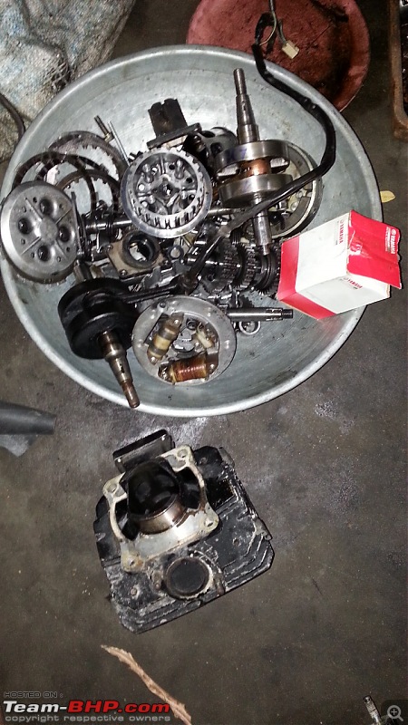

Engine opened up for the first time in the life of the bike.
Running on stock engine for the past 14yrs.
Anyways the piston is completely gone. Major carbon accumulation in the bore and head.
Connecting rods needs change.
First over size planned.
Work will start over the long weekend.
Bore sent to Bangalore for the needed work.
Some more parts bought.
