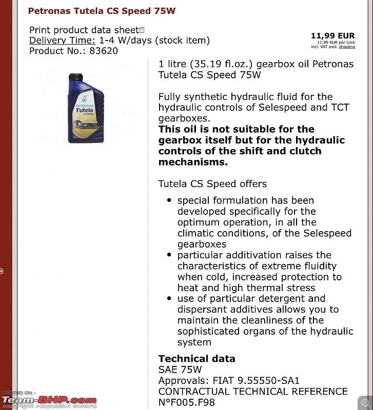

Apologies buddy. But yes, no information on grade as such.
If you want to look for other brands, you can check what goes for Suzuki‘s AMT, Renault’s AMT, etc. I suppose that’s worth a shot to check grade information.
However, for Tutela Cs-Speed, Petronas website as well as few others shows below technical information-
However, for Tutela Cs-Speed, Petronas website as well as few others shows below technical information- Attachment 2036505 |
Hm this is indeed problematic
1) Said Tutlea Cs speed is not available on the market for me as on writing this entry.
2) Considering that 75W is the specified grade I wish there was a way to confirm the same, I will be skeptical on relying on other brands AMT as thier systems might be different.
3) Lastly is gear oil/transmission/amt fluid the same?

Since Maruti as well Tata uses Magnetti Marelli's AMT, I suppose it will be similar.
Also, gear oil/transmission/amt fluid aren't the same. This is mentioned in the screenshot shared by me earlier.
Also, gear oil/transmission/amt fluid aren't the same. This is mentioned in the screenshot shared by me earlier. |
Gotcha hydraulic fluid 75 w grade; time toask the local suppliers
