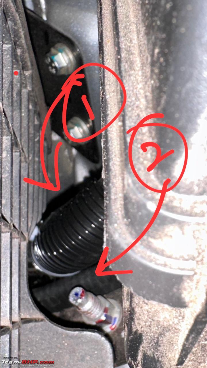

Details on the service action:
Issue: There is a possibility of the insulated cables coming out of fuse box rubbing aginst the metal part and shorting as shown in below pic.
Fix:
They will put in a plastic case around the cable marked as 1 in below pic and a rubber beading along the metal ridge marked as 2.
