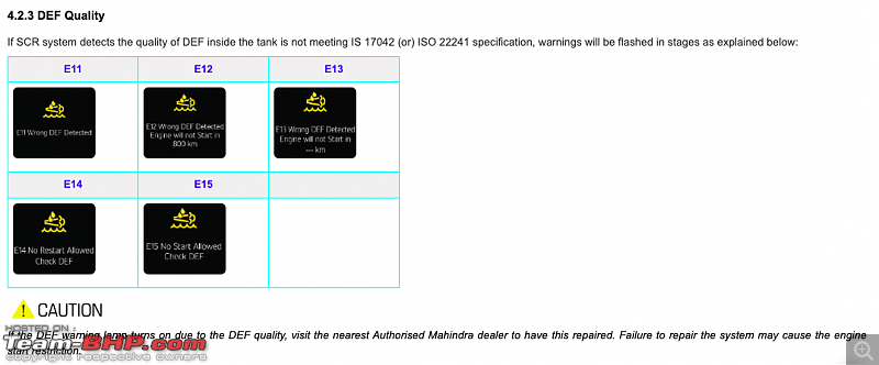

Found this in the owners manual.
Seems to be either a quality issue with DEF or a possible contamination.
Any chance water or other fluid found its way in DEF tank? Heard about a similar incident where a sleepy fuel pump operator opened the DEF cap to fill the fuel but the alert owner stopped him in time.
Anyway, whatever the reason you need to head to the service centre as soon as possible as the alerts are going to appear in stages as shown and soon the engine might be unable to restart to prevent further damage.

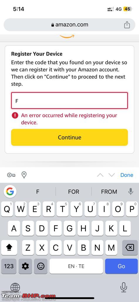

I received my XUV700 a few weeks ago, and I've been trying to link Alexa to it. Every time I enter the code on Amazon.com and grant permission, I receive the following error: 'An error occurred while registering your device,' as depicted in the image below. Does anyone have any suggestions on how to resolve this?
Attachment 2505641
Check with "amazon.in"
I have tried both Amazon.in and Amazon.com; however, even the .in site redirects to .com
