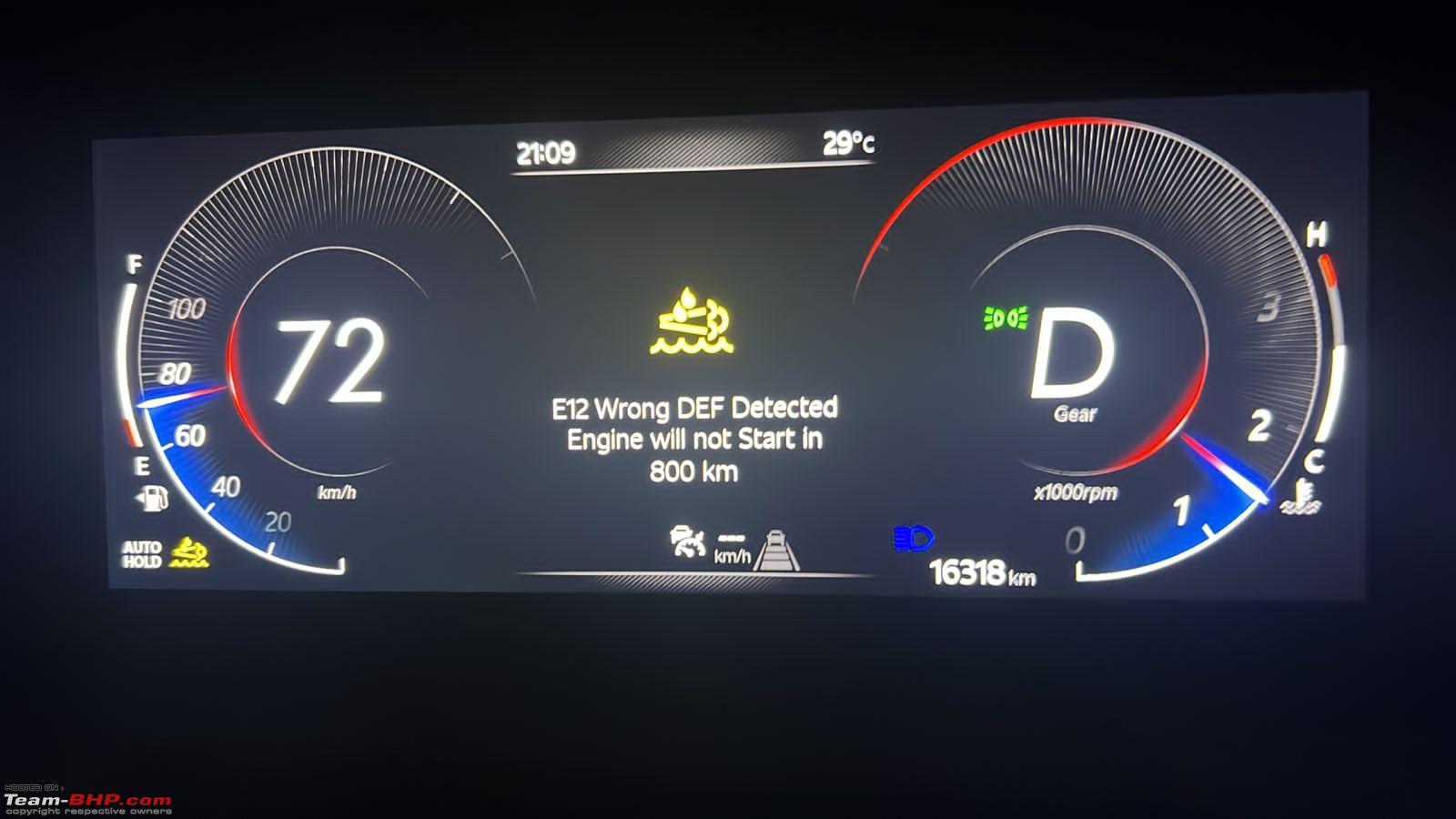

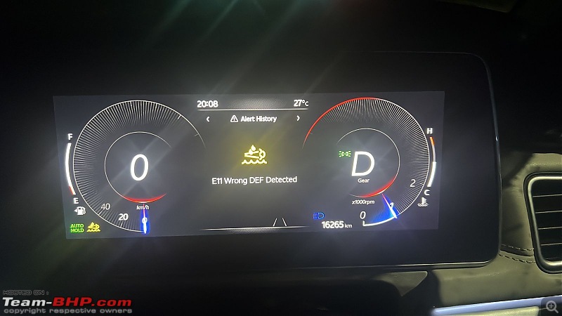

Hi Everyone. Need a quick suggestion about a DEF error that I have encountered while driving on the highway. An error message related to DEF has suddenly popped up on the screen. The exact error message is “E11 Wrong DEF Detected”. The DEF level is currently at 52% and nothing new has been added since the last service.
I am currently on the highway and want to know if it is safe to continue the journey or should the car not be driven in this state. Attaching picture of the error for reference.
Any information will be highly appreciated

The error message has now changed to “ E12 Wrong DEF detected. Engine will not start in 800 Kms

Not a XUV700 Owner but here is what is mentioned in the Owner's Manual.
The instrument cluster clearly shows that it is a DPF error.
As mentioned above in the picture you can continue driving but you need to visit the Authorised Mahindra Dealer as there seems to be an issue with the DPF Quality.
Did you refill DPF somewhere outside?
Found this in the owners manual.
Seems to be either a quality issue with DEF or a possible contamination.
Any chance water or other fluid found its way in DEF tank? Heard about a similar incident where a sleepy fuel pump operator opened the DEF cap to fill the fuel but the alert owner stopped him in time.
Anyway, whatever the reason you need to head to the service centre as soon as possible as the alerts are going to appear in stages as shown and soon the engine might be unable to restart to prevent further damage.

Thank you. Did not fill DPF from outside. The last time the DPF was filled was at the service Center and have driven about 6000 km since then.
Attachment 2504863
Attachment 2504862
Thank you. Heading to the Service Center today.
Attachment 2504865
