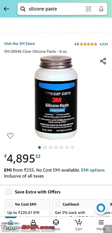

Originally Posted by sridhar-v View Post
Go step wise. First get the caliper pins greased properly. And check for rust on the discs. If the problem persists it may be the caliper pistons sticking.
Thank you Sridhar. The problem has emerged again today while on my way to work. However, when I crossed a speedbump at speed, the sound vanished. After that, I tried going over a speedbump again at speed and this time the sound reappeared. I tried this again and after the sound vanished, I drove as slowly as I could over any pothole, speedbreak, unpaved road, etc. The sound hasn't come back yet. I'll visit the nearby FNG to get the caliper pins greased first. I read that Silicone Paste needs to be applied to ensure lubrication is proper. I have no idea where to get that in our rural area.
Is it okay to lubricate it with WD40 or just grease?
Edit: Just checked on Amazon for Silicone Paste. It's around Rupees 4895 for 8 oz. Can members suggest alternatives for greasing caliper pins?
Do not get this large can. Any good spare parts shop in your area will have small pouches of caliper pin grease. 1 pouch for 1 pin. Maruti service centres definitely carry this, so your local FNG will be able to source it. WD40 may not be the best as it can chew up the rubber boots of the caliper pin. Just a small squirt in an emergency perhaps.
More likely it is a case of some improper tightening of the brake caliper assly mounts that is allowing the caliper assly to move more than desirable. Are you driving on roads with a lot of loose stones/gravel? Because your speed bump noise issue could be because of small stones getting stuck between the caliper and disc. Though that normally gives a continuous grinding or screeching sound.
Do not get this large can. Any good spare parts shop in your area will have small pouches of caliper pin grease. 1 pouch for 1 pin...
Thank you so much. I'll try and source the caliper pin grease from the parts shop in town. Otherwise, as little brother is in the city, I can ask him to source some from the Maruti Service centre.
I had to quote this in full because this exactly describes the situation. I am driving in the non-existant roads of rural North East India. I'll try and upload a picture of the road to my house today after returning back from work. The road is full of loose stones, potholes filled with water and the works. When the sound last happened, I pressure washed the tyre section, especially laying attention to the disc brake area. After the wash, the sound was gone.
With regards to the sound, it's a continuous grinding sound. I had hoped the sound would remain gone after last post but the sound has reappeared and the grinding sound is continuous now. I'll try and pressure wash again after reaching back home. Fingers crossed. Thank you btw for all the help. I appreciate it a lot
