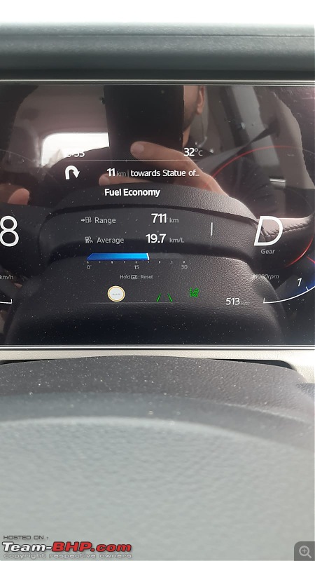

Hello, booked XUV 7OO AX7 L DSL AT in March 2023 and got it in the first half of July 2023. The SA offered us and we took the offer although forgoing the colour of our choice. The SA said that it's a "finance quota" car... asked him the details, didn't get a satisfying answer. Nevertheless, they didn't force any accessories and the insurance quote was matched promptly. All in all a good deal I would say.
Having driven the car for about 600 Km, I would say it's a good progression from XUV 5OO W8 MT(owned for 10 years).
But, it revs hard and becomes noisy almost embarrassing in the initial gears, this is the only complaint I have. Also, wireless CarPlay and Android Auto is sketchy. But, I am happy overall.
Also, got the average fuel economy of around 19.5 km/l on the first ever longish trip. Drove it at 80 km/h, is this possible ?
Yeah, at 80km/h it is possible. My Tucson, and E-class gives 20+ FE at 80 km/h with cruise control on ECO mode.
aseem23 is offline   (1) Thanks
