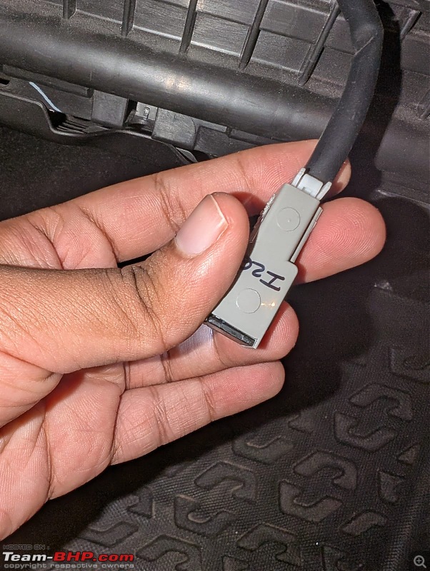

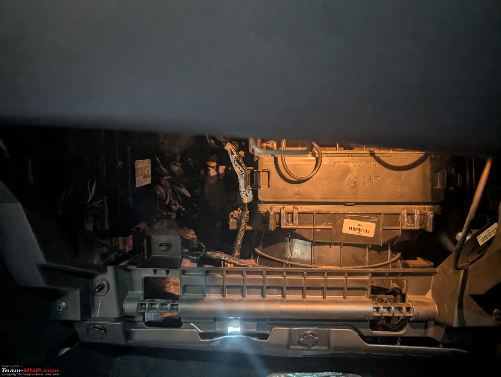

This is the view after removing the glove box.
The footwell light from above. Pull it upwards to remove it.
Once removed, just pull the white cable which gives it electricity.
You can now swap the footwell light with any other color of your choice.
Repeat the steps in reverse order to put it back in place, I hope this post was helpful.
