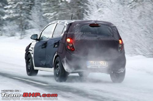

Chevrolet has already started working on the next gen Spark which is the Beat in India. Caught undergoing cold weather testing, the redesigned Spark is heavily camouflaged but it seems that it will have an evolutionary design with a sloping roofline and an upward sweeping beltline.
Chevy is showing the Beat facelift at the soon to begin Auto Expo and the all new car is expected in 2015.

I have been searching for news related to facelifted Beat (2014). Had heard a lot about the redone exterior and interiors, here is what the US spec offers .
