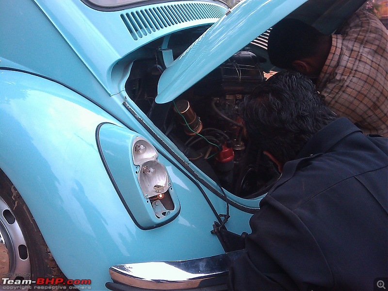

Long time ago when i was usually driving on office work, i passed via old Airport road, the night was approaching and in those dim lights i saw this Beetle parked on one side of the road. I felt sad as i could not take a close look at the car.
Days passed, almost 5 - 6 years, and i never saw it, But as luck would have it, i was destined to meet this ailing car My cousin wanted to buy a Honda Dio and as usual, all Automobile query in my relatives group leads through me. I went to Haiku Honda - Old Airport road. Something struck me and i met the MD of that company while completing the booking formalities. And to my surprise, he owned that Beetle i had seen years ago. We sat and chatted for a long time and finally he invited me to take a look at his Beetle.
A few weeks later, i was at his residence to take that first Close-up view of that car, all excited. Took a first look at that MAGNIFICENT CAR. The car was all good in every terms, but was ailing from loads of Running issues. Mr Subramanian - OWNER doled out his unending list of woes with the cars maintenance since a long time. I returned promising him to help get rid of all those niggles and issues with his car and make it a RELIABLE car as it should be.

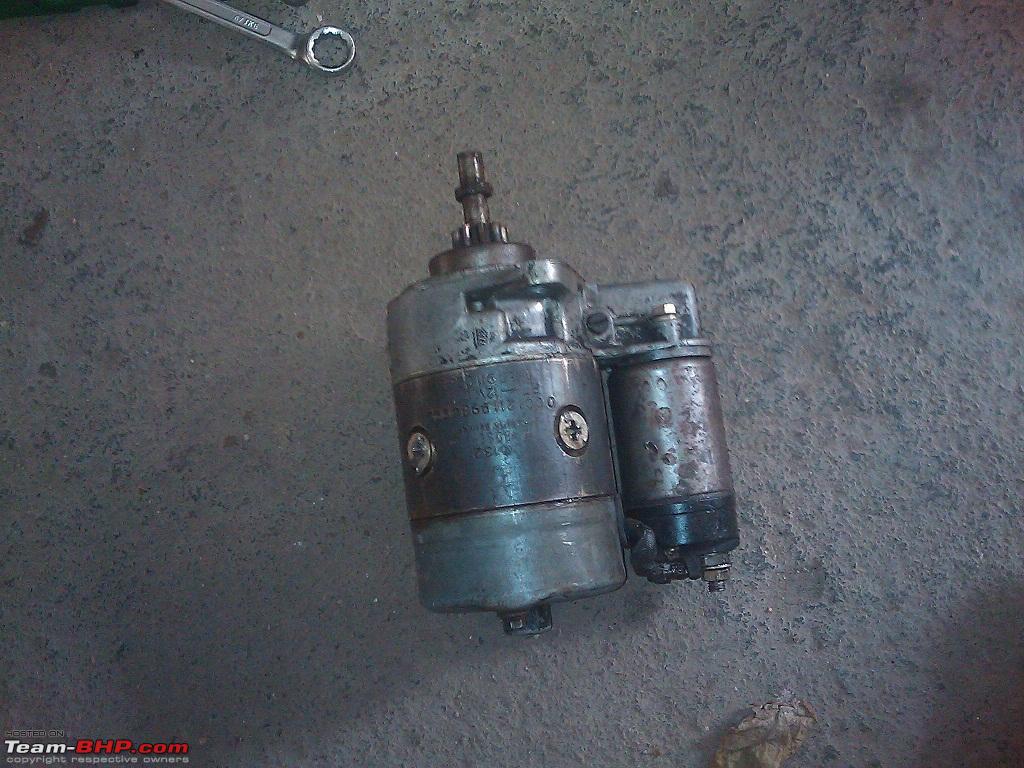

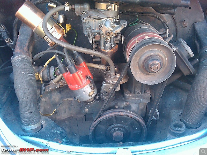

And..... I did return with my mechanic after few weeks. My mechanic found the following issues.
1) Starter not working
2) Carb not tuned well
3) Tappets/valves stuck. Too tight
4) Brakes weak
5) Plugs fouled
6) Points / condencer weak
Overall there were lot of issues by virtue of which mr Subramanian deemed the car impractical to use it the way he wants to.
We began Trouble-shooting each problem, even roped in the electrician in the coming day, went around solving all those minor issues. Finally after 1 week of work, the car was in good running condition.
I found few more missing links
1) Correct Tail pipe's missing
2) Exhaust leakage
3) Damage on the Rear Right fender
4) Little electrical issues
5) Few hoses to the air-filter missing
6) Bad wheel alignment and balancing
7) Too much of paint overspray on so many parts on the car
8) A proper clean-up with the extra dangling wires
9) Fuel guage had error, it showed 4 litres excess
The car came home and i went around doing lot of stuff myslef, drove around in the car, couple of days to office, weekend errands to relatives and overall close to 250 kms in 4 days, Issues sorted out and to this day, the car is in VERY GOOD running order.

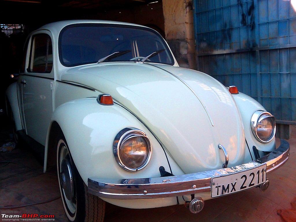

Today the Bug went back to its original Master. Close to 300 kms in the last 4 days and never missing a beat. Got each and every aspect of the car thoroughly checked, from the detailing to the blown out fuses, bulbs, missing knobs,Fuel guage error, Starter now working, Wheel balancing & Alignment, Reverse switch botched up,paint over-sprayed unnecessarily, or be it the extra unwanted wires dangling around, etc., etc.,- CHECKED & DELIVERED.
A happy me cant be more than beaming with pride about the way this car turned out to be. Now its with its master, i wish him all the best and hope to see it only every 8 months for its regular service.

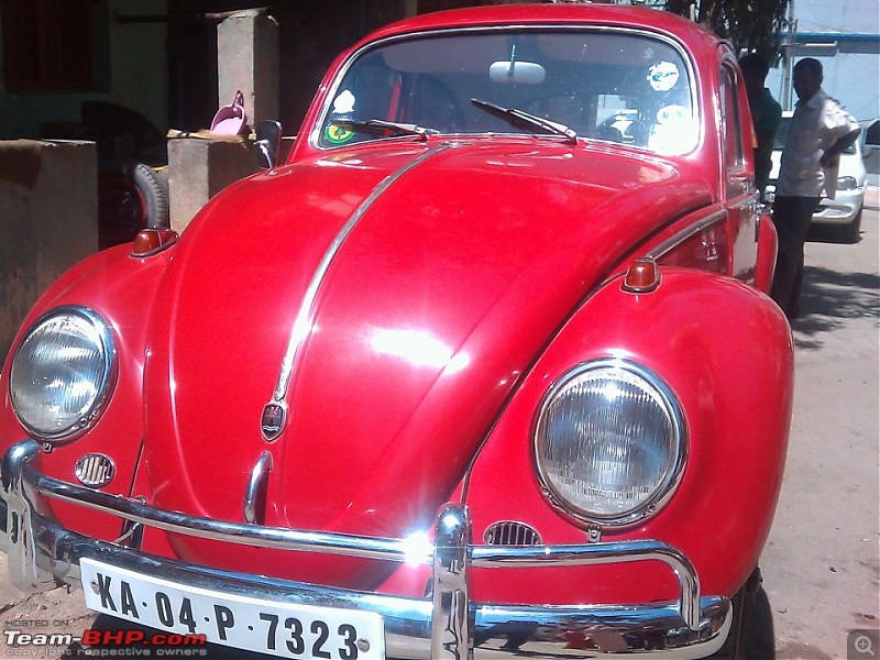

REFRESH a 1958 VW Beetle
Again, its a case of the right car with the wrong service back-up.
Being a late 50's Beetle, this car looked fabulous everytime i used to see it, but the reality was something else.
1) Originally a 6 Volts, converted to a 12 V using a modern Alternator - I am leaving that as it is, since too much money is spent in the modification few years ago.

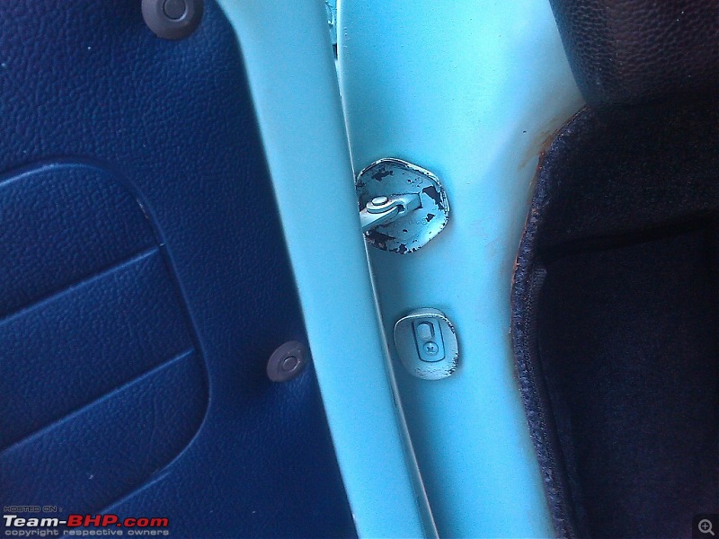

2) Car belonged to Mr Subbu ( 1972 SkyBlue Bug featured at the starting of this Thread ) and was in a fantastic shape before being sold off to Mr Ravishankar during 1996, Painted Twice since then and more than 4 lacs being spent, yet yielding mediocre results, Brakes not working, Engine looks like its lost 30 hp out of its 36 hp engine - NOW Trying to Refresh it completely and make it a more daily drive kind of a car.
3) Upholstery and Paint - Upholstery is in tatters, Corrosion on the RHS panels and too much of Rust bubbles on the RHS. BUT, we are not doing that now, will attend to it after Mr Ravi gets to enjoy its drive for a few more days.

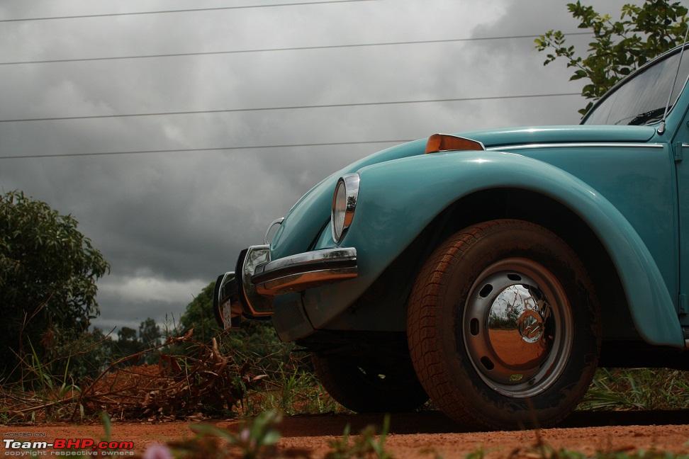

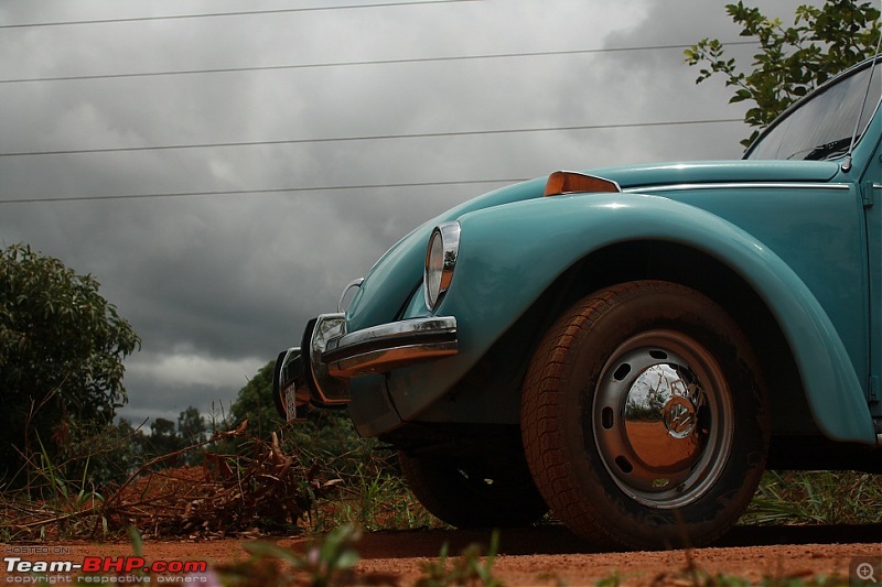

Well, 4 days with me, every thing about has been checked for and done,
1) Front Steering overhaul
2) Suspension overhaul
3) Brake overhaul
4) Valve adjustment
5) Wheel balancing
6) Engine tuning
7) Essential oil replacement
Drove this 1100cc 36 hp motor and what a feeling it is , its just heavenly feeling driving a car like this.
