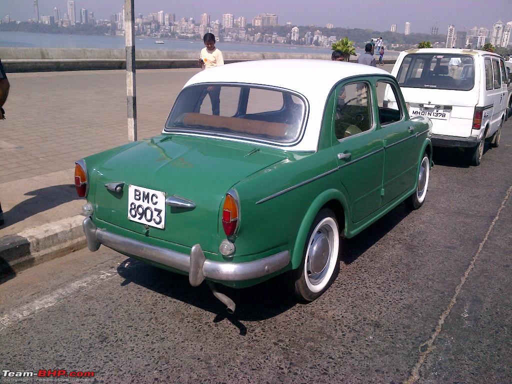

Dear all - I am attaching some pictures of BMC8903 taken at Mumbai's famous Marine Drive yesterday. The event was the annual mega meet and drive of the Fiat Classic Car Club of India. I have also done following mechanical work on it.
I brought all my engine tune-up equipment from Pune to Mumbai and reset the dwell angle and ignition timing to specifications as I just cannot work blind! Dwell angle was found 75 degrees, set to 60 degrees as required. Ignition timing was way off specifications (don't ask, I am yet to figure out how the engine was running at all HaHaHa! ), reset to 10 degrees BTDC. The engine is running much quieter, cleaner and better now. The carburettor still needs to be changed, though. No time!
Exhaust manifold packing disintegrated, replaced.
Measured circuit resistance in the charging circuit, it was way off specifications, alternator checked for output, found completely erratic, with such nonsense in place, the diodes are expected to short out. The root cause was high electrical resistance in the additionally fitted ammeter circuit. Strangely (this is beyond me), the dynamo voltage regulator was still connected in the circuit, although it is not required to be there at all. Removed the ammeter and the voltage regulator from the system. The Lucas TVS SA15 alternator (it is from a Maruti 800) must never be used with the ammeter connected. I was expecting a 3500 rupees expense as I did not expect the alternator to work, but it worked, how I just don't know! Immediately the lights became brighter, the engine rpm increased and the general clatter went down. I wonder how the electrical system of a car can be so bad and still work!
Removed the fuel guage unit from the tank and tried to repair it, not possible because the potentiometer wires have disintegrated after 53 years in petrol and there is no float in the circuit at all! This needs to be sorted out in totality.
Clutch pedal free play found less, link was fouling to the sub-frame, adjusted to specifications, I am not satisfied, need to sort out in totality by replacing the clutch completely.
For body related changes, please see the photographs. Comments welcome of course!
