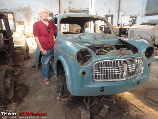

Last night's posts got me motivated and I went to see the progress this afternoon.
Here a few photos that I took and I am going to make a point of visiting more often. I was surprised that so much work had been done in such a short time. It's going to be a show stopper!
One of the questions Shriv asked me that I couldn't answer was; did it come with the concealed gas cap or had it been modified? I know that on my WBF1 it had the exposed filler pipe with a non original locking cap. I went through the pros & cons and decided that based on photos of the Italian Fiat 1100 Deluxe models I would have a concealed one fabricated and would "restore" the car to the Italian Deluxe specs as closely as possible.
When inspecting the metal work around the door opening, there was no typical welding marks that would indicate that it was not a modification. I'm no an expert on these fine details and would be interested in any comments.
The Body is in remarkable good shape and I would tend to agree that the 24,000 miles showing on the odometer are correct. It definitely was not very well maintained but is a low milage car. When I recall the shape of WBF1 when I first purchased it, I thought that the 42,000 miles must have once around, now I feel that it they must be the actual miles and well maintained.
I had suggested that Shriv might post a detailed journal of it's Restoration and much as he would like to, he's got 7 cars under restoration at the moment and just doesn't have the time. So he's quite pleased to have me post whatever photos I can. As we will be returning to Toronto the end of April I am hoping that it should be almost completed.
I'm particularly pleased that he is being such a "purist" and so concerned that everything is as close to original as possible.

All selects came with external fuel filler pipes (1959 - 1960 2years) and all super selects (1961 -1962 2 years) came with flush mounted fuel filler openings.
The exact month of start and end of production of selects and that of super selects is not known.
Further in Selects we had both screw type and later quarter turn twist type For Elegents it was screw type and any change in specific parts was purely on the basis of availability of kits.
I had a select from Dec 1960 with a external but quarter turn twist type
And my current car is April 1959 and has screw type external fuel filler.
In all probability the car in question came with external fuel filler, if it is an early registration, then a screw type is the period correct one.

Seeing the body scraped panel around the petrol lid, one can be dead sure that the area in concern has not been patched, thereby sujesting that the petrol lid was always there. I was even of the opinion that the petrol filler cap should be external on the selects, but after inspecting the area concern I am pretty sure that it has'nt been modefied.

Here is an interesting point to discuss. We always assumed that Selects (from 1958 to 1962) had external fuel filler caps, and assumed those that had the flap were later alterations. Maybe most of them are later alterations, but this is the second case we see where there are no welding marks at all. We somehow always overlook the possibility of a 'run-out' change. Many companies would have a running change of some part, often towards the end of production depending on parts supply. It wouldn't be uncommon to see bits and pieces carried over to other models, like we see later slotted wheels on some Elegants.
I'd say if there is no evidence of the flap being grafted on, its quite likely to be original. Final call on what to do would of course be taken by the owner.
From my side I can say my 1960 Select and Rony's 1961 Select both have the external filler, and both are 100% original. What year is your car? Can you share the chassis number, so we can compare if earlier or later than ours?

I can be almost 100% certain to say no, it would have been a later alteration. A commonly done one at that, in both Fiat and Ambys. One reason is of course theft, but the other reason, espcially Ambys, is water seepage in the rains.
If you scrape down the fender you will see welding marks filling the hole where the pipe would have been.

Your fuel filler is an alteration indeed, reason to bring it in was fuel theft, water running down the pipe, (all mentioned by Karl)and in the case of my Amby additionally the cap needed to be protected from the elements as the lock did get rusted and I was stranded, could not open the cap to fill fuel. Accessories were not always quality products.

1962 will make then super selects and then these had the flap and consealed fuel filler, Am I right?
Any reference to the other case that you talk about. Also what Shriv has mentioned in the opening post is 1959 Select which would make his car an early model, thus for sure having external fuel filler.

1962 was a transition year, we see both Selects and Super Selects.
I would normally have thought that the filler neck should be external, but when no welding marks are visible, it makes a strong case. Never say never. The investigation continues.
EDIT - maybe if this was my car I would ask some really old timer denters who would normally do the alteration, how they did it and where the seams would normally have been.
