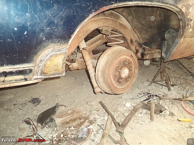

On the progress, its been slowed down due to excessive rust and dis-integrated metal, I have been trying hard to get lots of pics from the internet on how a particular part of the vanished bodypart should look like. Every day, i go to the workshop with photos from the internet, my tinker deciphers it and later re-creates the particular portion. Its nerve wreaking so far, but i hope this is the only way to do.

We sprayed Industrial based Epoxy primer on the inner panels of the fender and firewall, got the hinges repaired.
Next action happens on the RHS of the car, i am so looking forward to the completion of this car, its still too far before we finish the RHS. There is also a King size bed ( BOOT ) waiting for us once the front end is done

We generally use 18 guage sheet metal for body panels and for structural areas we use 16 guage.

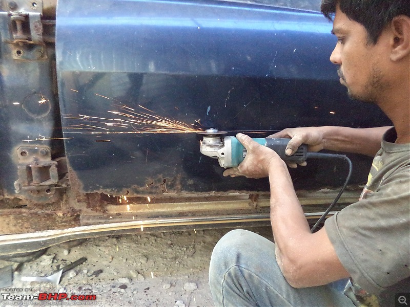

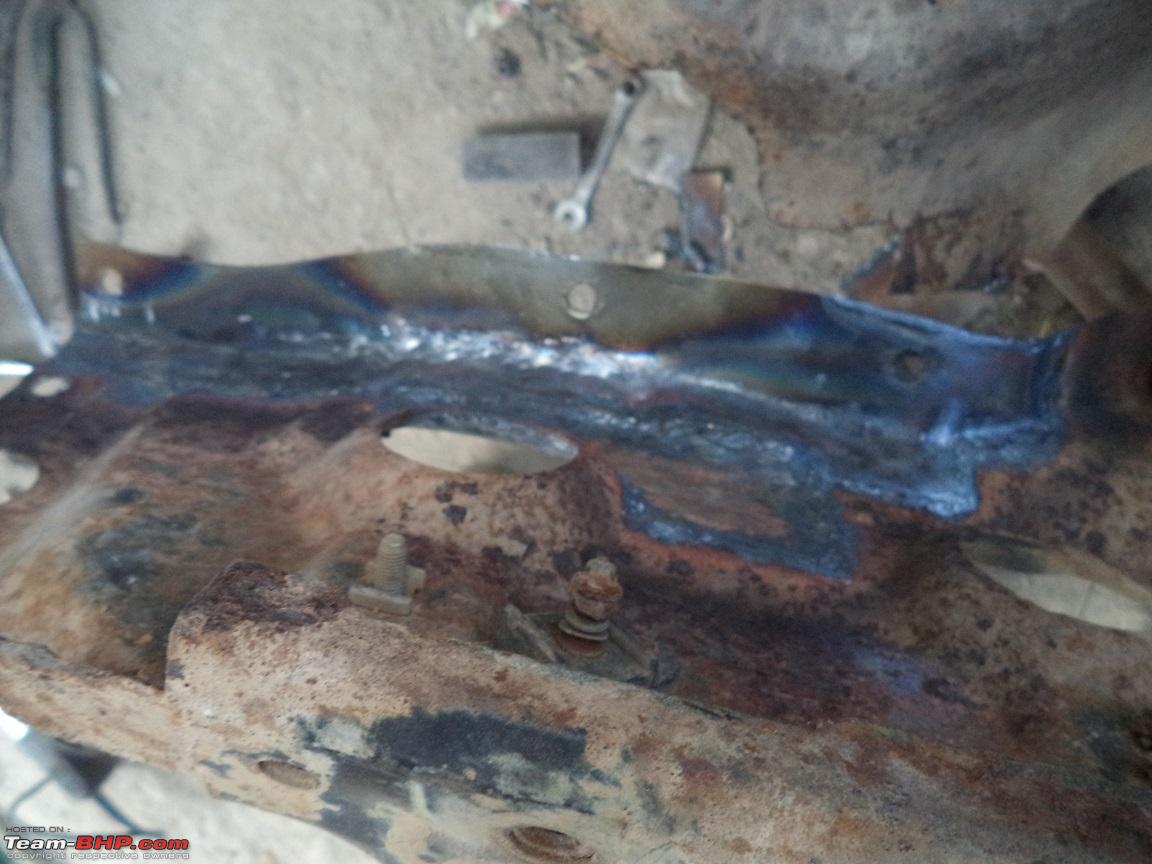

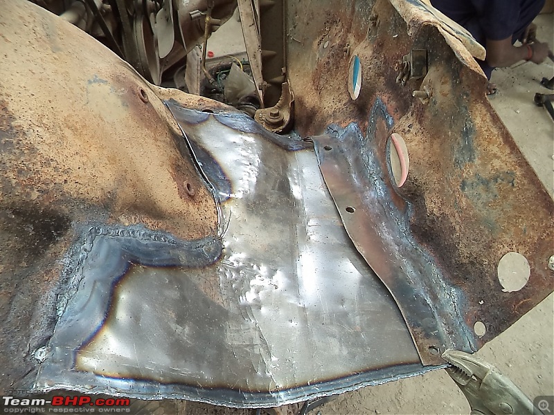

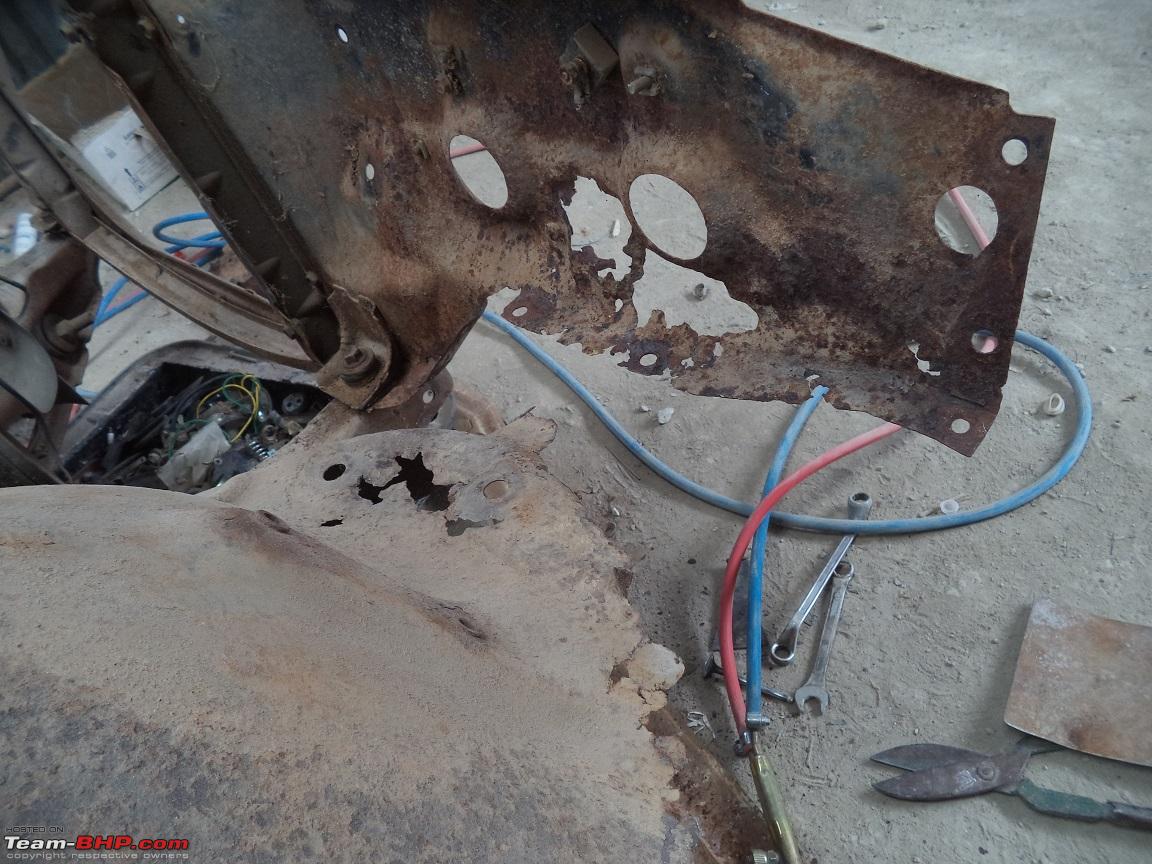

Finally after a long long wait and welds and seams and more of welds and sheet metal replacement, my tinker managed to complete 100% work on the LHS of the car.
We now move to the RHS, and things get worse this side

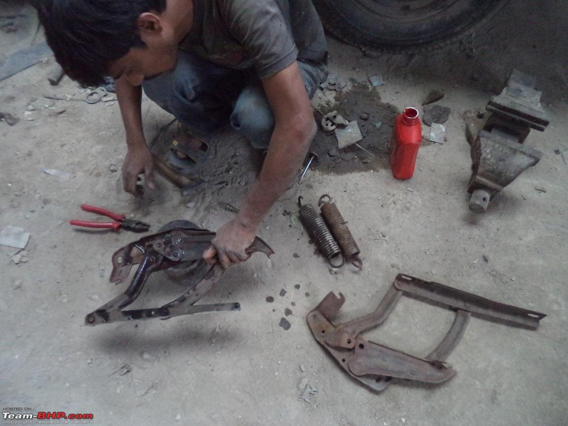

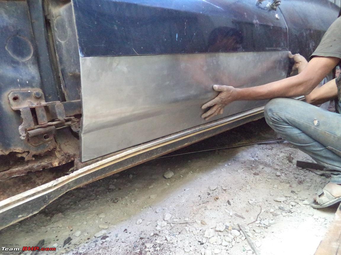

The LHS is somehow turning out to be a cakewalk to my tinker He's just racing to finish. All the months work on this car, looks like he's got used to this car so much that he's finding it a child's play to work on.

OMG! Look at that new sheetmetal for the door!! Simbly AWESOME!
'tis like a mirror!
How I wish every tinker got such 'virgin' metal as replacement for patchwork!
You've got the right man for the job, Pavan! Or, was it YOUR selection by any chance?
