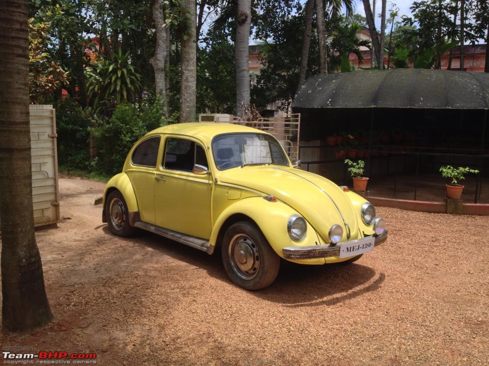

Yes, yet another 1968 VW Beetle belonging to Dr Philip Varghese, Ex-Bangalore car came down from Gods own Country. Looked Solid, a decent runner, but the paint job was past its prime, Engine used to overheat on short runs and a few electrical and mechanical Blunders.
A Straight forward approach and the goal towards achieving a simple Stock look with No modifications whatsoever and inching towards originality. But knowing me, i added my own touch in concurrence with Dr.
