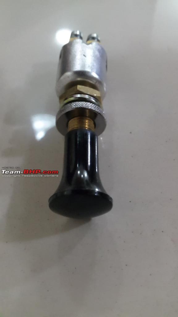

More work is getting done and more parts are trickling in. With some parts, I am at cross-roads - they are not quite the original and it is darn near impossible to find the originals. For example the dashboard panel switches. Since I have haven't been able to find the 1962 model switches, I got these from Holden Vintage Car parts in UK. Any opinion on whether these are close enough for the Ambassador switches in 1961/62 models ? The Holden website mentions them as parts for MGBs of that era and they look similar to early Ambassadors (from what I vaguely remember and what I have seen recently in team-bhp photos), perhaps inherited from the Morris Oxford.
They come with a plain knob and you can buy lettered knobs for its hexagonal shaft like these -

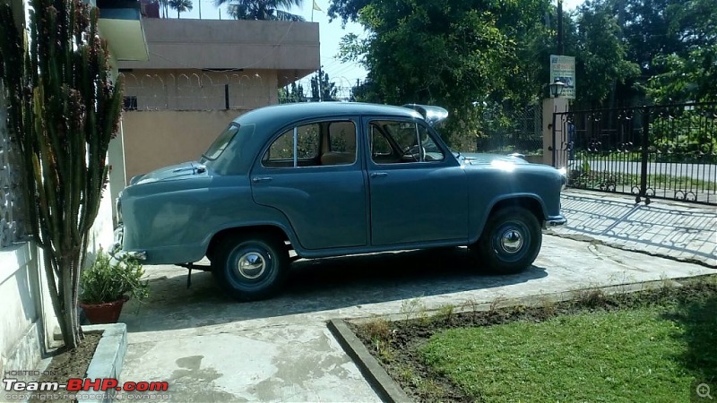

I haven't had the time to put up the next part of the restoration story, but since we have made some good progress, here is a photo of the current state of the car. We are still doing some minor work fixing things and replacing faulty parts.

Brings back memory of Amby and my leaves spent in workshop.
Kudos to you in finding most original parts and for the level of restoration. I too vote for Mark I type front.
Even before restoration, there wasn't much of rust and once the paint was scrapped, the body lines looked clean! Was it restored before it was parked for long time?
Keep her running regularly and please share more photos
