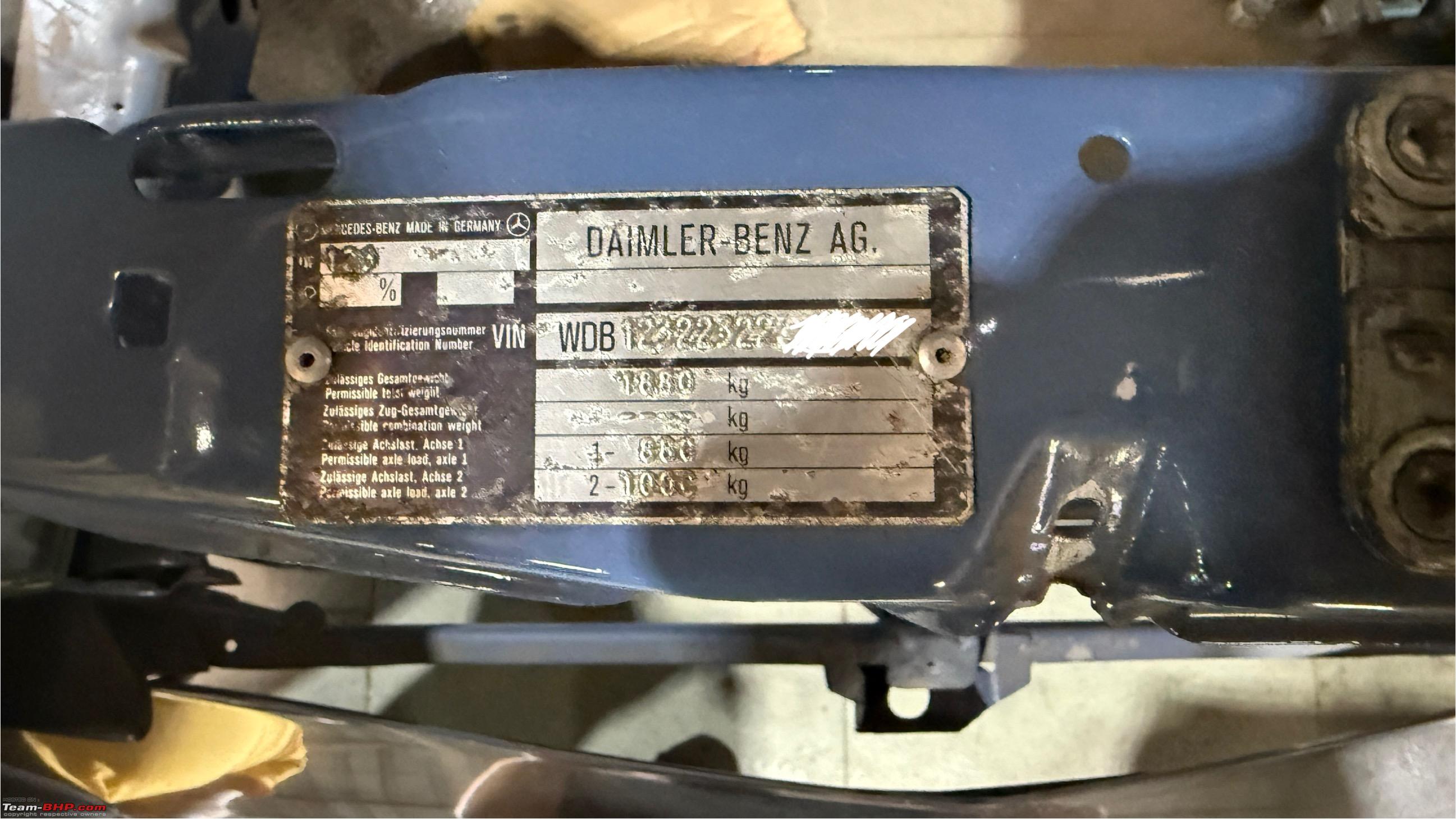

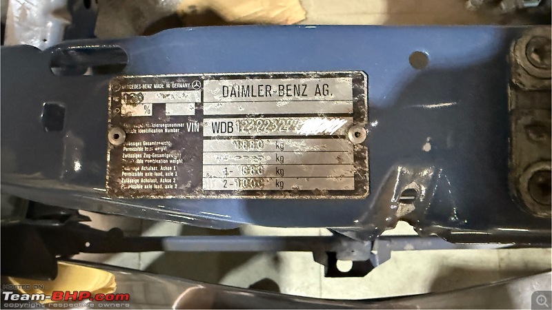

VIN Decoding:
WDB: Mercedes-Benz (Daimler AG)
123: Series Code
223: 230 E M102 (Sedan & Type Designation)
2: Right-hand drive
2: Automatic gearbox
XXXXXX: Production serial number
What makes this car particularly special is that it seems to fall right in the transition period for the W123:

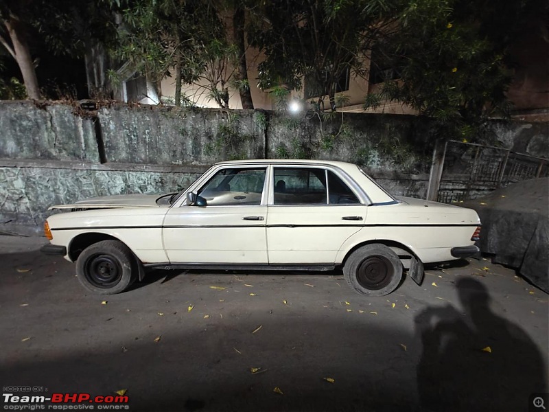

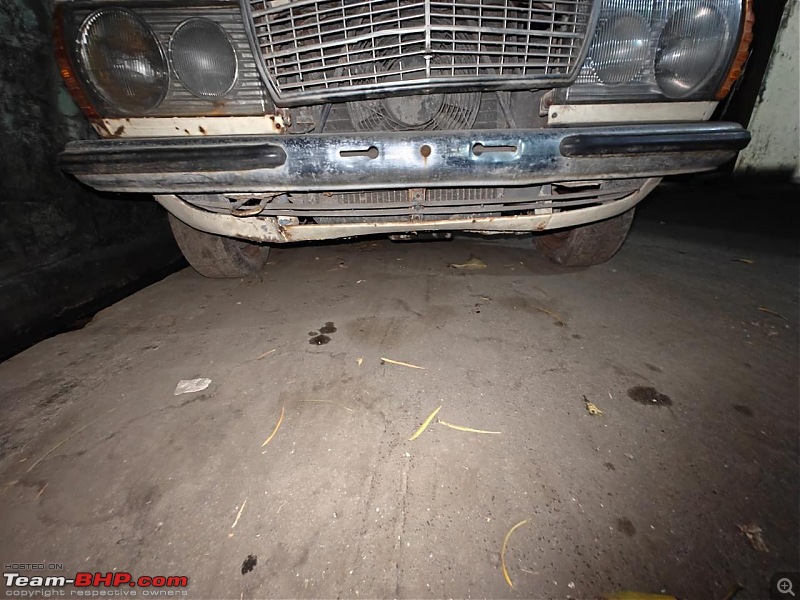

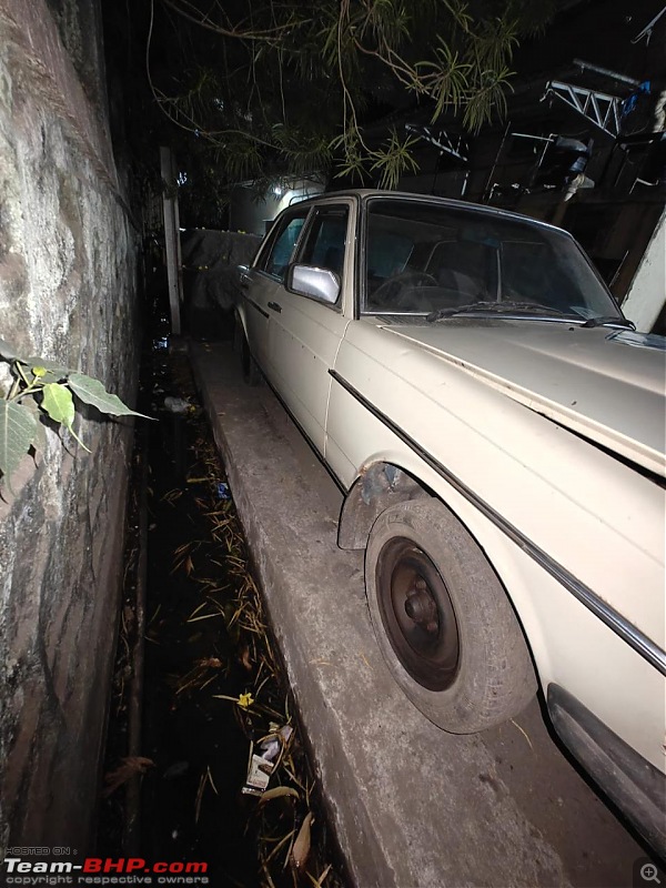

Interestingly, this W123 has had quite a story even before I entered the picture. Jatin sourced the car back in November 2024 — it was sitting in Madras (Chennai) in less-than-ideal condition and had it transported to Bombay to save it.
Two generations, One garage spot | Which Classic Mercedes wins? 1968 W115 Vs 1979 W123-f726cdb0ba5a4ebaa928d29dcdac2cdb.jpeg
Two generations, One garage spot | Which Classic Mercedes wins? 1968 W115 Vs 1979 W123-15310603eb62482581316de17f1f0e55.jpeg
Two generations, One garage spot | Which Classic Mercedes wins? 1968 W115 Vs 1979 W123-0837959a079e433280b61245c5b41e5a.jpeg
Two generations, One garage spot | Which Classic Mercedes wins? 1968 W115 Vs 1979 W123-226b40feaba247159a71736a71eecca3.jpeg
It caught his eye for one big reason: it’s a rare early 230E with the M102 engine.
At first glance, the car appeared to be a beige white shade. But while unloading, a few fallen-off trim pieces revealed a hint of China Blue underneath.
Two generations, One garage spot | Which Classic Mercedes wins? 1968 W115 Vs 1979 W123-img_1220.jpeg
That small detail led to some digging, and after locating the original paperwork and also via the cars Datacard, it was confirmed:
This car was factory-delivered in China Blue! With the Sunroof, Autobox, Manufactured in 1979 at
Since then, Jatin’s team has been working meticulously through the bodywork, sorting all the rust out properly — no shortcuts. The shell is now solid, and we’re finally moving toward the next big phases.

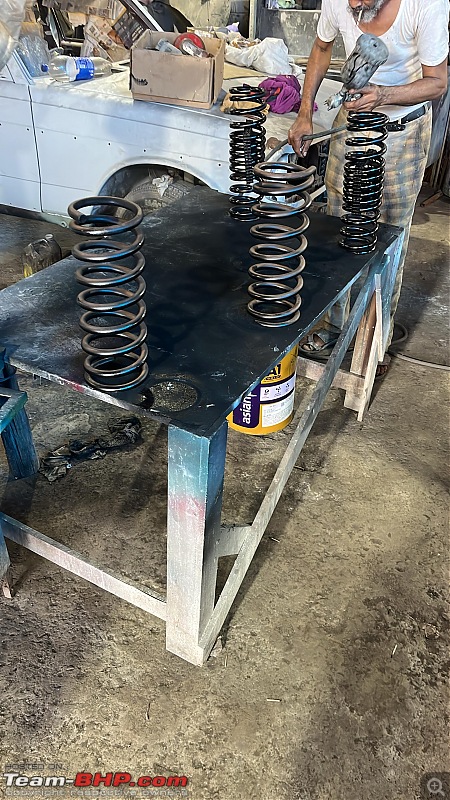

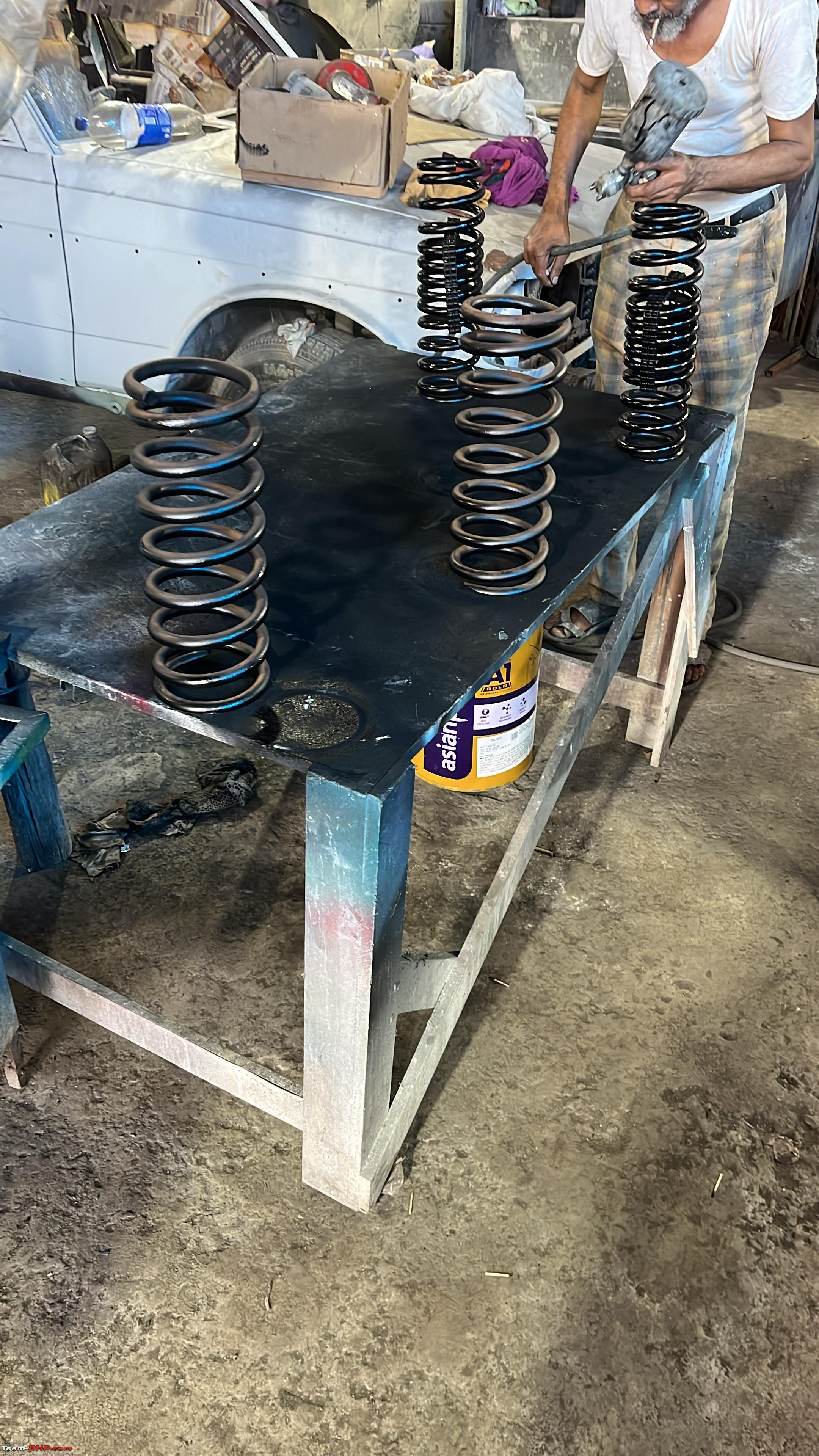

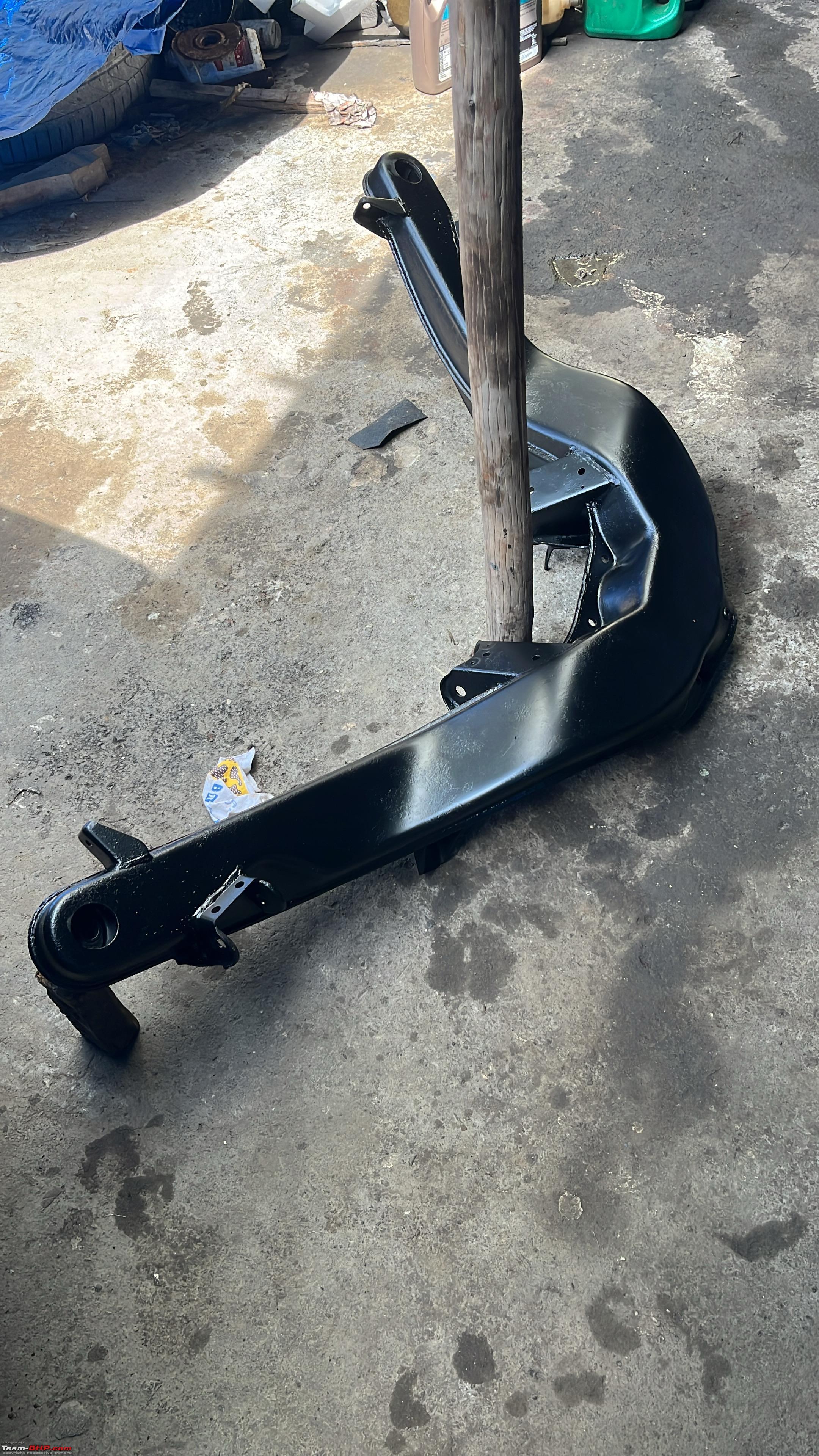

  • Engine, gearbox, and suspension rebuilds are in full swing
  • All bushes, dampers, steering and suspension linkages have been replaced
  • Suspension and steering components are being properly painted and finished

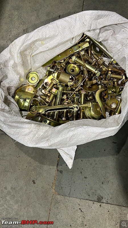

  • Every nut, bolt, bracket and washer is being zinc plated to factory spec
  • We’re not aiming for “decent” — we’re working to ensure this will be the most detail-accurate W123 restoration in the country

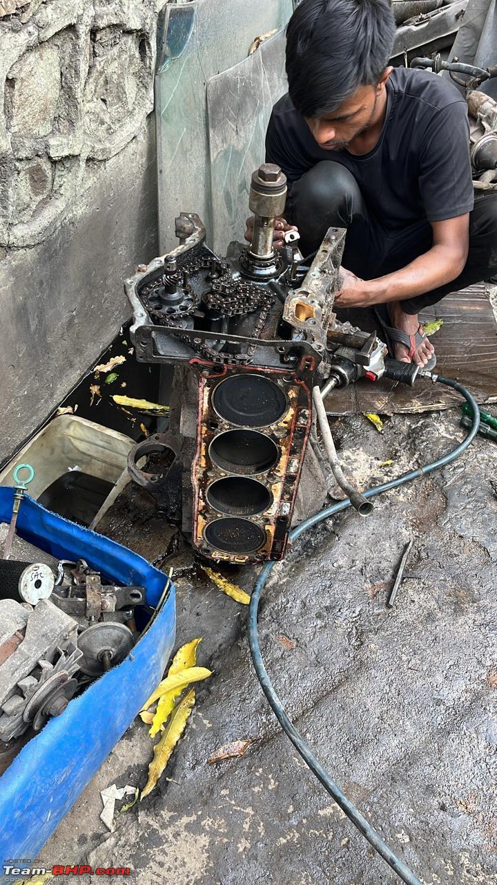

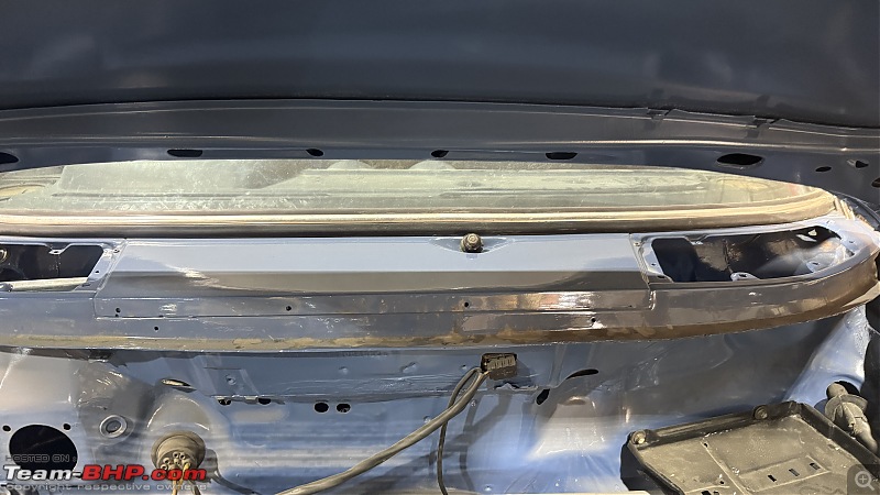

One Unexpected Setback
During teardown, we found that one of the crankshaft lobes was slightly bent. We’ve ordered a brand new OEM crankshaft — now en route.

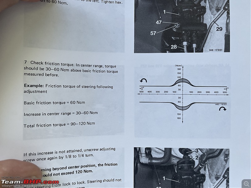

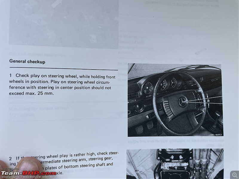

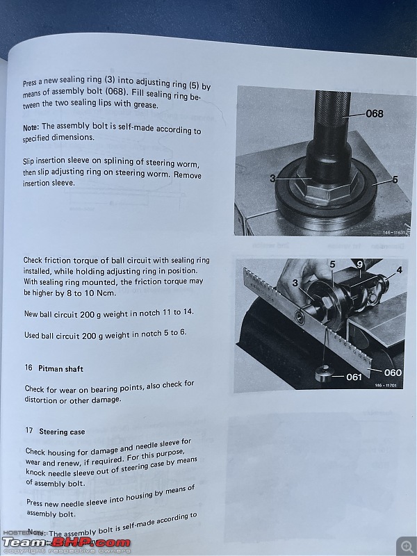

Just a couple of practical pointers on the steering set up. Many W123s suffer from steering play. If the ball joints are all good you need to check the slave steering box. It can be easily re-sleeved.
However, the most prone wear component is the steering box itself. And mostly because mechanics adjust the play by feel. Yes, it will tighten up the box a bit, but it will make the problem worse over time.
The Mercedes workshop manual stipulates a maximum of 2 cm play measure on the rim of the steering wheel. Almost all W123 I come across have more.
The official adjustment procedure requires some very special tooling, in particular a torque wrench with a very low setting.
I will post the relevant pages from the American Mercedes workshop manual (so it’s in English).
Once a steering box has been adjusted manually, which just about all of them have over time, you can’t cure the play anymore and the box needs a full overhaul.

As promised, some information on the adjustment of the steering box.
There are several variants of the steering box across the W123 range.
They are identical in the way the final adjustment is made via measuring the torque on the Steering Wheel.
As I mentioned, the maximum play permitted is measured at the steering wheel circumference:
Two generations, One garage spot | Which Classic Mercedes wins? 1968 W115 Vs 1979 W123-img_1629.jpg
Here is the procedure for adjusting the play:
Two generations, One garage spot | Which Classic Mercedes wins? 1968 W115 Vs 1979 W123-img_1622.jpg
Two generations, One garage spot | Which Classic Mercedes wins? 1968 W115 Vs 1979 W123-img_1623.jpg
Two generations, One garage spot | Which Classic Mercedes wins? 1968 W115 Vs 1979 W123-img_1624.jpg
Two generations, One garage spot | Which Classic Mercedes wins? 1968 W115 Vs 1979 W123-img_1625.jpg
Two generations, One garage spot | Which Classic Mercedes wins? 1968 W115 Vs 1979 W123-img_1626.jpg
Note that this measurement and adjustment need to be done with the pitman arm removed and the engine idling!
Notice how you should be able to see an increasing torque as a function of the Steering Wheel angle. Also, notice that the torque is stated in Ncm. That is Newton Centimetres, not Nm (Newton meters).
You mentioned that you are already in the process of overhauling the complete Steering box? The above is the final step of the course.
But overhauling a Mercedes Steering Box is not for the faint of heart. I had mine overhauled three times. All steering box specialists. But the first two times it developed play within 10000km again!
I finally found a guy who really knows what he is doing. Or rather, somebody who just follows the official procedure to the letter and has the equipment to do so.
Because you need some special tools and a set of special (thrust) washers in different sizes!
I am attaching some images of the various steps, and you will get a feel for how delicate this is. Some parts need to be checked against a 3 Ncm (Newton centimetre) torque!!
Two generations, One garage spot | Which Classic Mercedes wins? 1968 W115 Vs 1979 W123-img_1614.jpg
Two generations, One garage spot | Which Classic Mercedes wins? 1968 W115 Vs 1979 W123-img_1615.jpg
Two generations, One garage spot | Which Classic Mercedes wins? 1968 W115 Vs 1979 W123-img_1616.jpg
Two generations, One garage spot | Which Classic Mercedes wins? 1968 W115 Vs 1979 W123-img_1617.jpg
Two generations, One garage spot | Which Classic Mercedes wins? 1968 W115 Vs 1979 W123-img_1618.jpg
Two generations, One garage spot | Which Classic Mercedes wins? 1968 W115 Vs 1979 W123-img_1619.jpg
Two generations, One garage spot | Which Classic Mercedes wins? 1968 W115 Vs 1979 W123-img_1620.jpg
Two generations, One garage spot | Which Classic Mercedes wins? 1968 W115 Vs 1979 W123-img_1621.jpg
A summary of the most important torque specifications, all in Ncm!
Two generations, One garage spot | Which Classic Mercedes wins? 1968 W115 Vs 1979 W123-img_1628.jpg
