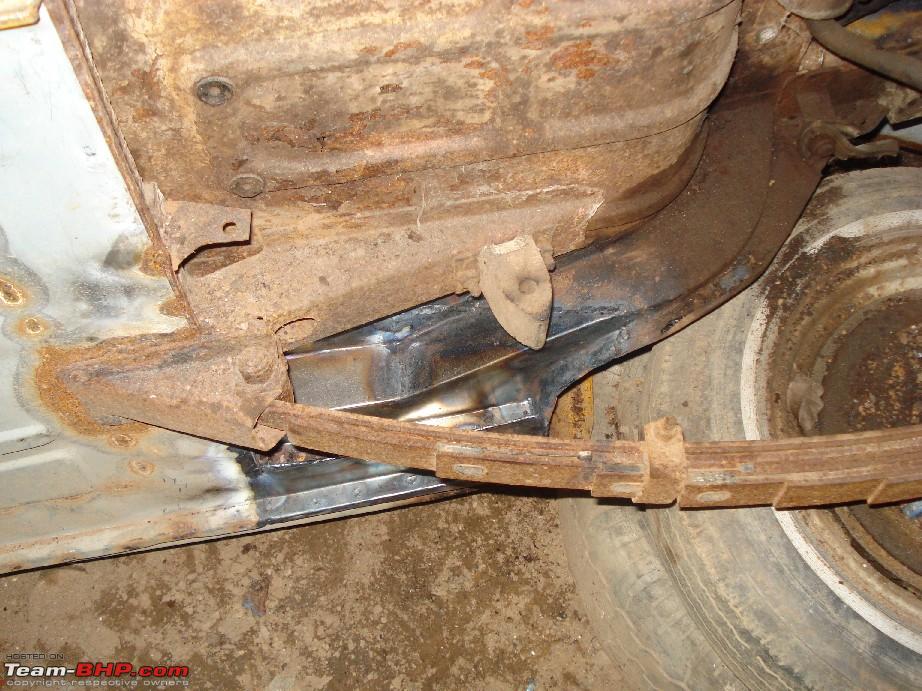

Yes Indrojit that would be the ideal way of doing it, but since tinker is a kM away from my mechanic, transporting the car back would be issue. As for updates, the progress is very slow, but tinkering is in its last legs and in couple of days it should finish.
Once at mechanics place all of the mechanical will be removed and unberbody will be scrapped free of rust.
