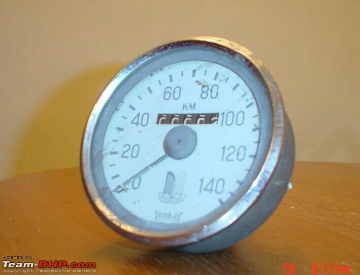

The single, white dialled Smiths speedo in the Herald gave way to smaller white Yenkay speedo and two smaller meters.
The Yenkay meters in Heralds were first LIGHT GREY, with dark grey lettering, as this one:
Then later models (around late 60s) had all-black ones with white lettering, which continued on the Gazels and even Standard 20s.
Attachment 247885
Thanks Stanher. Remember these and now have refreshed the memory.:)
