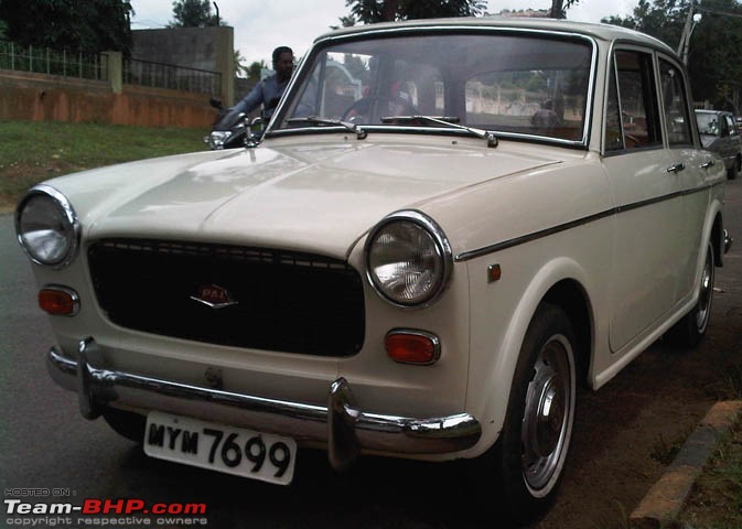

I grew up riding in a Super Select and it was also the car I learnt driving in! I have been trying to trace our old car for some time now! Owning a good Fiat has always been a desire . I came across this car in Mysore and just could not let it go! Now I am the owner and I drove it from Mysore to Bangalore in good time!
I have noticed "not so original" stuff on my car but I am not an expert !!! I invite all the Gurus and Experts to express their views and reflect on the car. I am hoping that I will get the assistance to source and bring the car closest to its originality.

Lovely car, maintained superbly. There are unoriginal stuff in and around the car, but that can be easily corrected if you want to or else you can drive like that. Con you post the pictures of wheel caps, are those with fiat logo??

Yes Manish, the engine and the body is very nice. I would want to bring it as close to stock as possible. The wheel caps are not with the logo!

1968 Delight Fiat 1100
Hi Srivathsa Satya,
You got a lovely '68 delight there.
Bodyline looks clean and in general you have the OH REE G NAL fittings like Quarter glasses, Bumpers, Speedo, Windshield rubber st. steel Pattis, Horn button, dicky Badge etc. Those Period thin white walls are still on and look great. They are extinct now. Do preserve them for as long as you can. Hope you have some good indoor parking.
You now only have to source the period aluminium show fittings and lights like side pattis, grill, wheel caps and Side indicators, Tail and number plate lights. Also try to change the front parking light lenses to the PERIOD white ones. They are still available from Sweet Trade. I would say just pick up and stock a dozen of them as they are breakable items and will be handy in the future, to keep the car looking fresh. Also the Tail light lenses are still available from Sweet Trade and the same goes for them regarding stocking up.
BESHT of luck and welcome to the proud FIAT Owners group in India.

Srivathsa_Satya ji very clean and 80% original delight you have got. Congratulations on the acquisition. Its a Delight to see the instruction book intact after all these yrs. Regarding the originality,as President guruji pointed out many hard to find items are intact. Though the car has been repainted it still looks factory fresh. The chassis plate must have been removed in the said process thats why its been screwed rather than riveted. The wiper motor is also from a later model, and those wheel caps are a good thought on those rims. That period reg. plate adds more classic feel to the car.

Dear Srivathsa Satya - that's a nice car you have purchased, please keep it carefully forever. I doubt that it is of 1968 model because I had 2 1968 Fiat cars MRC6903 with chassis number 014620 and MRC6621 with chassis number 013898. As your car has chassis number 019811, it may be a 1969 / 70 model. Please recheck your records.
Following parts are original:
Both bumpers, except the center bracket on the front bumper / radiator / instrument cluster console / instrument cluster aluminium plate, 4 jewel lights and speedometer / steering wheel / horn button / quarter windows / dicky lock / FIAT1100D monogram / center console with choke knob.
Following parts are not original as equipped on a Fiat 1100 Delight:
Grille / front side lights / side signal lights / number plate lights / headlights / headlight rings / side pattis / front and rear windshield glass rubbers with aluminium mouldings / seat covers / ammeter and fuel guage / ashtray (it used to be chromed) / outside door handles (they used to have a dull finish) / spark plug wires (they used to be green in colour) / fuel filter in the petrol line (no filter was provided) / routing of battery positive cable (it used to be on the chassis) / battery negative cable position and mounting on the body (it used to be a strap mounted behind the battery) / battery assembly (it used to be LH positive) / wiper motor (it used to be link operated in 1968) / wiper arms and blades (it used to be nut type fitting in 1968, wiper arms are fitted in reverse order, RH is supposed to be longer than LH in 1968 / wheel rims (it used to be clip type wheel rims upto 1968) / wheel caps / antenna (no antenna was provided in 1968).
Please post detailed photographs of the engine compartment / interior / dicky to enable me to comment further.

Oh I see those wheel caps are not original. Now let me give you insight on parts avalibility.
1. Original meters - Are availble in Gujari, I see one of yours is non original.
2. The white Park light lens - Available at Jadsons, you can have them easily.
3. The door handels, should be aluminium - I saw them at Jadsons (actually at his huge parts godown at his home). You can have them if he agrees to take you home.
4. Aluminium tail light, aluminum number plate light and aluminium trims really hard to find. I am also looking for the aluminium tail light. If shyam is giving to you nothing better than that.
5. Side repeator lights were there with mubarak meter works in gujari (aluminium body with orange lens). Please ask him, but he is costly.
P.S. The Bangy guys did had access to plenty of grils from delight but that's all, other stuff like lights and trims were only one set. For grill you can contact Arun if he has one, else Shyam is the source.
5. For wheel caps, look in gujari, ask arun if he has spare.
6. Aluminium window winding handles and inside door opening handels are hard to find if you dont have them. live with the current one, keep looking in gujari.

The following parts are available in Shivajinagar Gujiri:
1. Aluminum grill: Meet Ghee Basha.
2. Side signal lights: Mubarak Meter works.
3. White parking light lenses: Bade Bhai.
4. Mechanical Parts: Nadeem.
For the SAKE of originality just fit these parts. Till you find rest of the parts JUST ENJOY THE FIAT!
