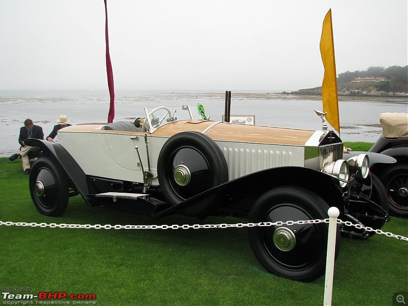

Originally Posted by Automaton View Post
May I suggest an white/eggshell body, polished wood all around and chrome where befitting. The white wall tyres would look great too with that combination. 20 foot cruiser on wheels.
Though I earlier veto'd a white body, it just struck me that with the woodwork it may look rather nice. Refer this Jodhpur car as reference

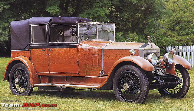

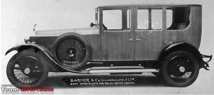

Originally Posted by shyml View Post
My two bits worth is that the Jodhpur car has the bonnet painted as sham wood. Pl check the gap between the radiator and the bonnet when viewed from the driver seat. It is exactly as in an aluminium bonnet and does not have any wood pasted on top. This was quite common and sham canning ( painted to look like it was covered in woven cane, was done on door sides etc.)
Shyml is absolutely correct. Faux painting was popular in the 1920's - typically Oak wood grain, sham caning etc.
Two famous India cars with "painted wood" were the Bhopal Hunting Bentley 6.5 Ltr (oil imitation of wood); and the Hyderabad RR PI 74OR (believe the original finish was "Oak")
Read more here, courtesy of RREC:
http://www.rrec.org.uk/Cars/Coachwor...and_Others.php
And doesn't Bhogilal have one too ?
I still see "Woody" PT Cruisers etc, so realistic looking wood "coverings" are probably still being made.
