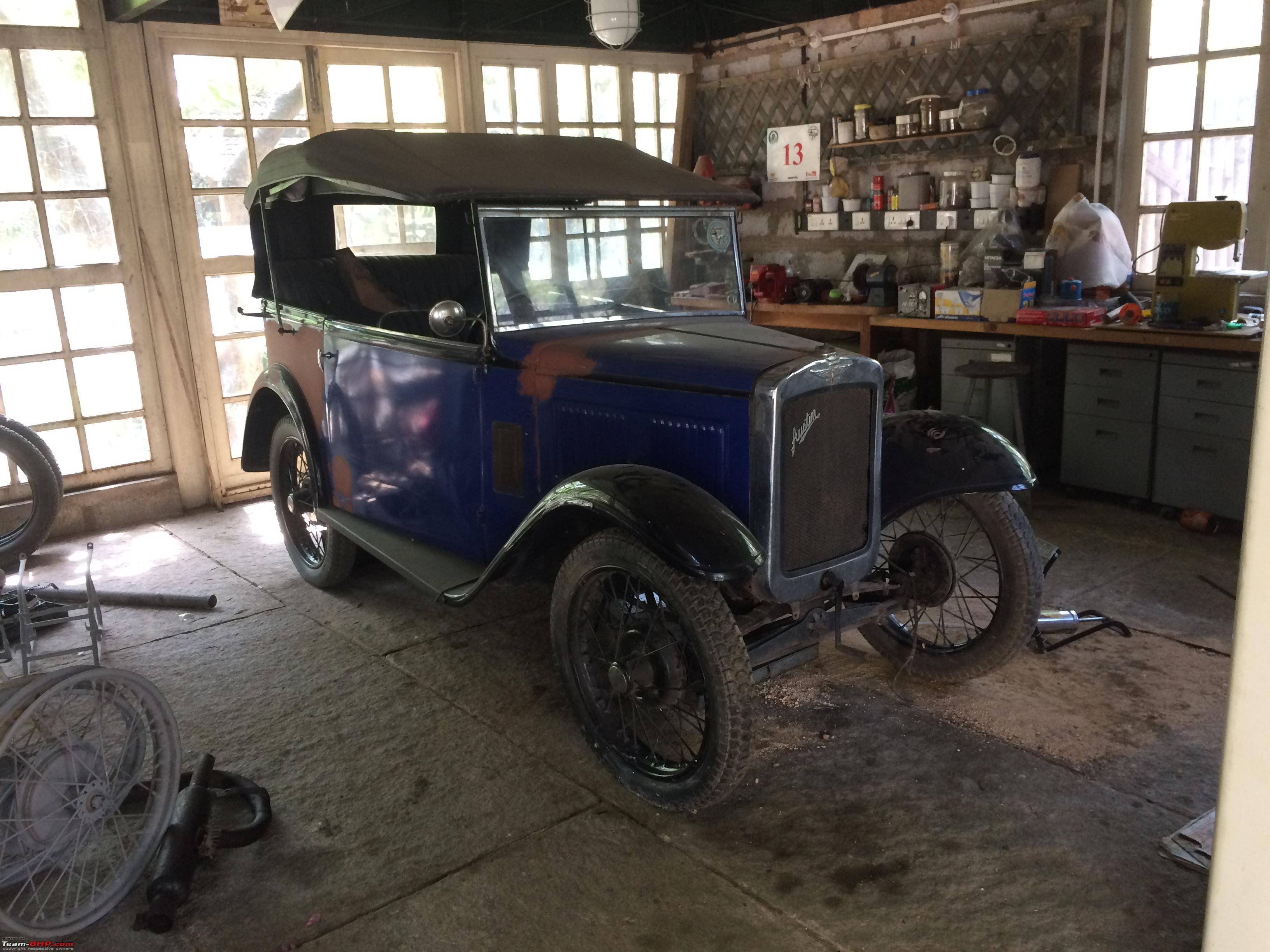

Am I the only one who feels that sending a car away for restoration evokes the same mixed feelings as when one sends a first born off to Kindergarten? A mix of relief, happiness and some trepidation?
And so it was, when Swami was pushed out of the garage and towed onto the flatbed, in August 2018.
I watched him receding into the distance and hoped for the best.

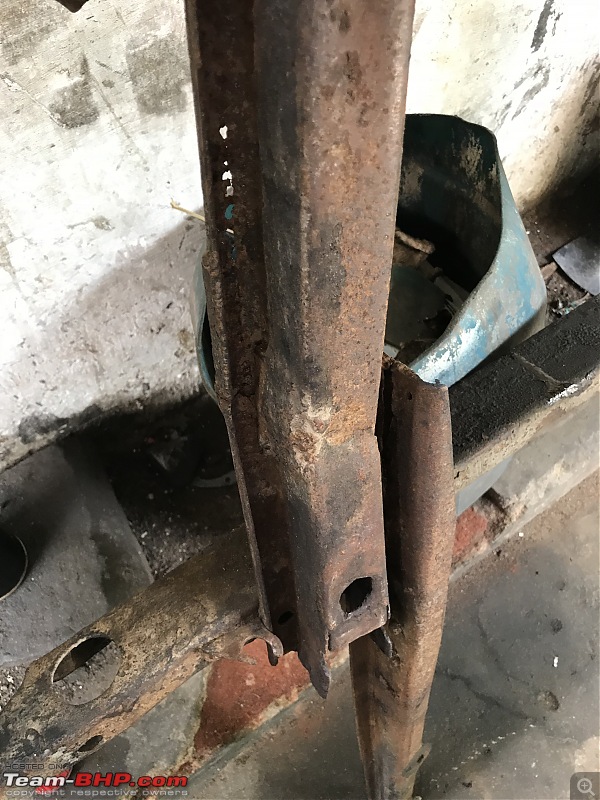

In Swami's case, the rear box section had worn thin on both sides and showed extensive cracks. The outriggers were also rusty. Some major welding and use of reinforcement plates were called for:

A closer look at the cracks and perforations on the chassis:
