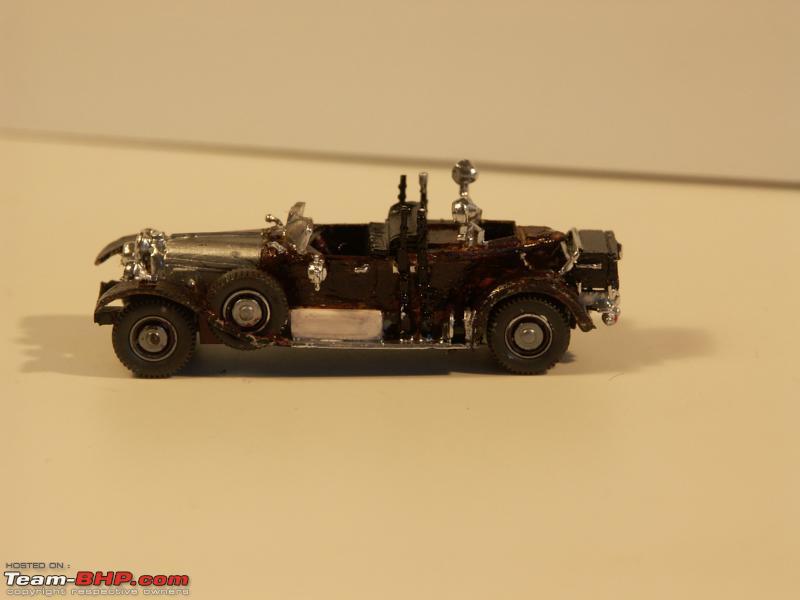

I built the 1926 Bentley 6.5l # 2563 in a scale of 1:10 and in Resin in 1:87 / HO.
Some pics:

These cars are handbuilt.
Hand-built scale model: 1926 Bentley 6.5L! UPDATE: More added-k800_bentley-hunting-car-006.jpg
Hand-built scale model: 1926 Bentley 6.5L! UPDATE: More added-k800_bentley-hunting-car-008.jpg
Hand-built scale model: 1926 Bentley 6.5L! UPDATE: More added-k800_bentley-hunting-car-009.jpg

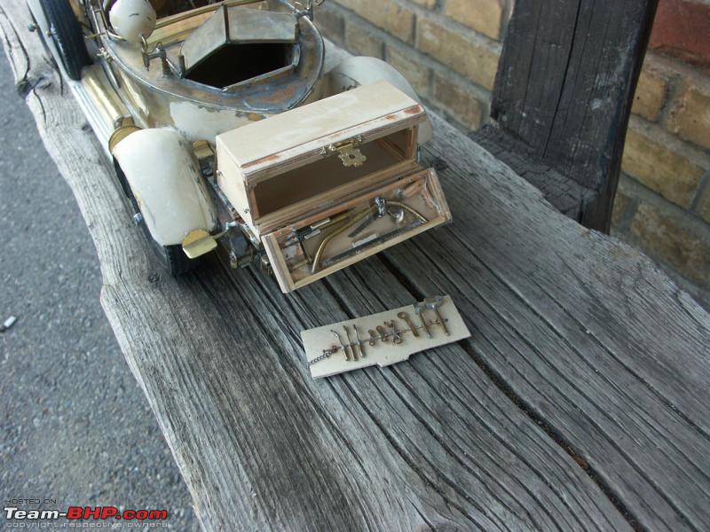

Now, I will show you the Bentley 6,5l #2563.
All models where handmade by me. There are no kit´s. The Bentley was made in separate parts, made of brass sections and Sheets. All these parts have been soldered. I worked for about two years on it.
The Fenders are fattened with fiberglass and sanded. All parts are movable. The searchlight is working with the steering.
The Model I built in 2002/03.
Archive Images I got from my good friend. K.J.Rossfeldt. www.rrab.com. He is a Book writer for Rolls Royce and Bentley. He was a lifelong gratitude. With his help, the data cloud be implemented into the model.
The wheels I have made of can lid. The spokes soldered to conical timber and connected with the rim. The weight of the car is about 3,5 kg brass.
It would be nice to know if the Bentley still exists.
Another good friend from me, looked in archives in England by Bentley, about this car. But nothing. No useful documents. Pictures / Photos from the left side there are plenty, but not from the right side. Nodbody know´s why not.
Hope you like and enjoy my construction phases.

Gregor, Simply no words to explain the attention you had paid for the details. The lights, tools inside the tool box, etc. Amazing talent, well utilized. clap:
