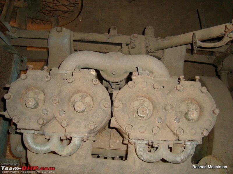

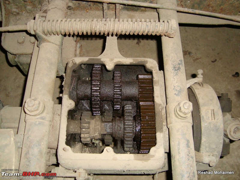

Hi Steve,
Sorry for posting the wrong picture. I will try to post the engine number asap. For the time being posting some new and detailed photos of the car.
Reshad

Hi Reshad and the mole,
STOP PRESS! The extra photos are great. However, they prove that the car is a 1910 TD22. The sump is square (1909 was rounded). The gearbox is 3-speed (1909 was 4-speed). The inlet manifold is cast aluminium (1909 was brass and copper). The handbrake is on the same shaft as the gear lever (1909 had two gear levers and a separate handbrake lever). The car has sliding front shackles (1909 had simple swing shackles on the front). There are damper springs on the rear shackles (1909 had none).
There was only one of these previously known. It's in the UK and is on the road.
The car has a CAV generator fitted for electric headlights, which was very rare in 1910. Luckily, these headlights are fairly readily available.
By the way, the pedal rubber is actually cast iron.
Cheers,
Steve Campbell-Wright
