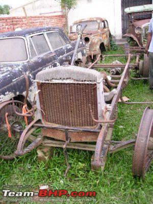

We have this 1909 Daimler(may be) over in Bangladesh, can you guys let me know more about this car. Do you guys think that this car can be restored? If yes then will you suggest me how to do this?
P.S: I don't know if it's the perfect place to post it. If not mods please remove this post.
Thanx in advance.

This is how it shoild look like. Attempt if you find missing parts in the yard.
If not it will be almost an impossible project.

Nice to see a post from Bangladesh.
Please post some more pics of this Daimler, let us see the engine and other mechanicals. We are working on a 1904 Daimler, in similar condition. We have built the wheels, thwey are wooden spoke wheels, made a new steering wheel based on the remnants of the old broken one and I have sourced a Bosch Magnetto. And scared to start serious mechanical work, but cannot avoid.
It will be nice if you could also inform about other cars lying in Bangladesh, one Opel is in the background, the car on the side is not so clearly visible but may be an Austin Cambridge.
Please post more pics.
There are restoration workshops abroad who can build an entire car around just one original component found, if the owner is prepared to bear the cost.
Assuming that's all that's left of the car as shown in pictures its a daunting restoration calling for the entire body to be rebuilt. Perhaps you should call Manvendra Singh in Indore as he may be the best bet in India to build a body from scratch.
Workshops abroad will return your car to how it left the showroom originally but it will cost you a lot of money.
Is this a family car? Do you have pictures of it seen in better days?

Thanx Ramanna, Harit and DKG for your reply.
@Ramanna: Buddy There's no more parts. It might be an impossible project but it's the oldest car in Bangladesh. So what do you say, worth restoring?
@Harit: I'll try to post some more pics asap. There's lotta other cars in Bangladesh, we have got some big time collectors too and many novice like me. But we lack in good workshops. Can you imagine the official dealer of Mercedes Benz couldn't fix a w116? Then also we have many very well restored cars. You are right that's an Austin Cambridge, and behind the Daimler that's a Ford model A.
@DKG: No, it's not a family car: it was bought as it is now. In Bangladesh we can't send our cars out of the country for restoration, and i don't think we will take the risk to try loopholes. I have heard a lot about Manvendra Singh, but couldn't really contact him. Can you provide me with some contact information?

Hello Reshad,
Now it is quite clear that your Daimler will probably not be restored, probably you will have to pass it on. You have mentioned that you are a novice, that we could see from the photograph you have posted. Actually nothing of the car's mechanicals is visible! I presume for my own reasons that this is a relatively new aquisition. Also, this is not a job for a novice!. All of us car restorers have had to do "hath safai" and sometimes the learning has been expensive. Though I have not lost a car till date, in the worst case I had to redo a car 3 times. And still not finished.
Suggestion: Do not get dishartened but face the realities and tackle the job systematically. First take good pics and closeups. Then list out what has to be done. There are major jobs and smaller ancilliary jobs. The first major job is the engine, get it running. While you are onto that, it may take 2 to 3 years (we have not seen it, so we are blind), do smaller work like the steering, the wheels etc. Make a list of parts to be sources and fabricated. And start sourcing irrespective when you require it. The headlights are required last but start looking now. The price of acytelene/carbide/kerosene lights is going up every day at least over here, I do not know about availability of old parts in B'desh.
Also, get the complete unit soaked in rust remover, kerosene,diesel whatever to loosen up the fastners. Sit down and understand all the systems, transmission, brakes etc. Only tyres you can source last as these are perishables. Are you allowed to import such items from abroad or do you have to use inguinity to bring parts into the country? Once you have the mechanical end in sight, I expect 3 to 4 years, then you can plan for the bodywork.
Can you tell us something about the history of the car and how come it was preserved for so long? And also some info on other cars over there.
About a Merc workshop not being able to do a W116 does not surprise. Such workshops are only good for current and max upto 2 previous generation cars, anything older they flounder. If only they would refuse to take such jobs in the first stage and not leave the cars stranded for others to clean up the mess.
Getting the car to India for restoration is a problem both ways, to get it into the country and re-export is almost impossible. Besides, Mr. Manvendra does normally not do mechanicals, he does bodywork. To get in touch you could PM Mustangman on the forum, his son.
Good Luck, do send greater detailed pics and we shall comment. Remember, commenting is very easy, but I will try to be objective.

Dear Reshad
Just check out if gear box and controls are in place. Also this Daimler had brakes only on back wheels.
I can get you pictures of the body and it can be built in Bangladesh.
Since I had a lot of trouble finding small parts for my Daimler consort which I have just completed. Mine is a 1951 model and you are speaking of 1909. My story appears in post 1950 cars.
I am meeting a very big Daimler classic parts stockist in London in a couple of weeks i will check out with him if he has information on this 1909 model and its parts. London Transport has one such bus but it about 8 years younger to yours.
Good Luck

The car certainly looks like a 1909 TB22 Daimler. The bevel differential and the rear shackles show it to be 1909, and the king pin caps indicate 22hp. There are now four of this model known to survive world-wide. The one in the UK has already been shown in photos on this thread. The other two are here in Australia, and one is in my possession. I'm actively restoring it now. The last one is a wreck, and I hope to see it restored too eventually.
Apart from these, there are only three other 1909 Daimlers known to exist. These are larger 38hp cars however. One is in the UK, and two are in Australia. All three are on the road. This gives a total of seven 1909 Daimlers now known to survive.
I also own a 1911 38hp Daimler, most of a 1914 20hp Daimler, a 1928 25/85hp Diamler limousine, a 1948 DB18 Daimler and a 1934 Austin Light-Twelve-Six tourer. I'd be very happy to assist with the restoration of your wonderful surviver. I have parts manuals, driving handbooks, photos and other information that may be of assistance. I also manage a world-wide datebase of veteran and vintage Daimler numbers, which helps me to date cars and engines for fellow restorers.
I'd be very interested to find out the Car Number of your car. It should be a four digit number starting with 5. You'll find it stamped inside the brass hubcaps (under all the grease). It should also be under the brass caps on top of the king pins as well as a number of other places that I could specify later. The engine number should also be stamped on the engine in a number of places - again a four digit number starting with 5 or 6. Are you able to advise these numbers?
As the oldest car in Bangladesh, I imagine there must be some history know of it. Do you know who its first owner was or any other history?
Congratulations on such a wonderful find, and please let me know hopw I can help.
