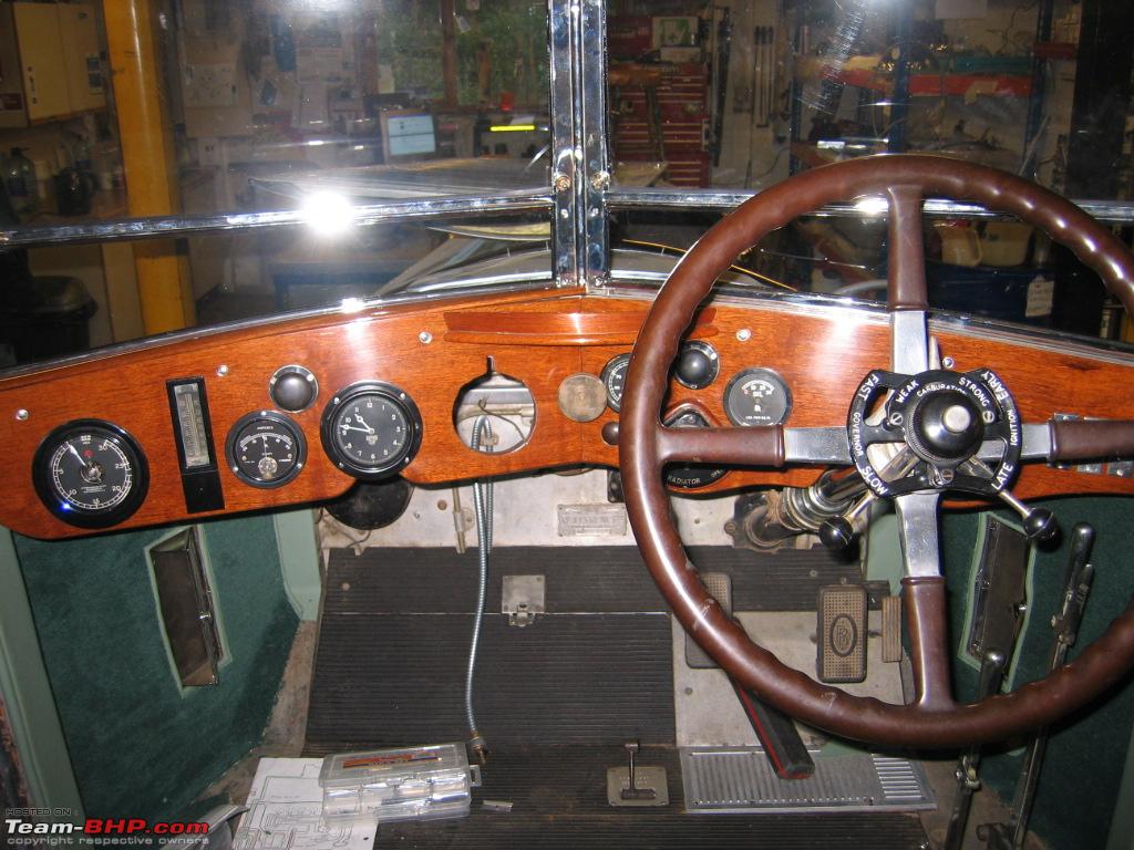

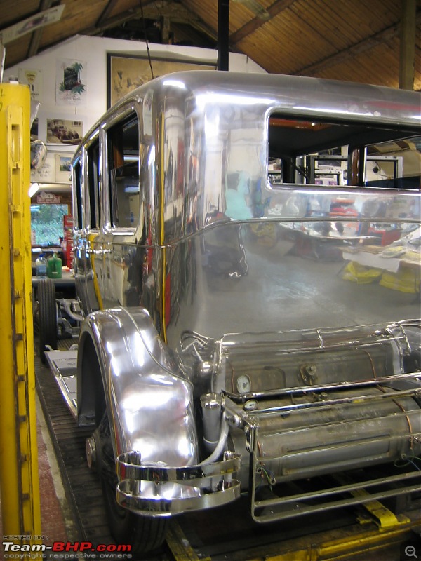

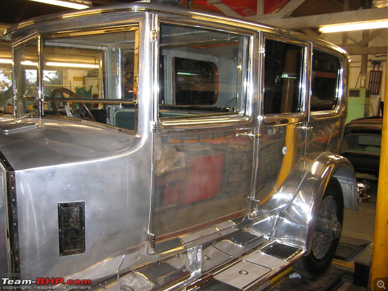

Hi Guys i am very sorry for the massive time delay in posting these pics. we have been very busy Restoring a 1930 Bugatti Type 46. i will post a couple of pics later if poss!

Thanks Steve. Earlier on you had mentioned steam cleaning. Could you please elaborate as to any chemicals/detergents you use with steam? On the engine how did you clean the aluminium crankcase? Same steam method?

No detergents were used alongside the steam cleaning, the hot water generally lifts most dirt and grease. The aluminium crankcase is cleaned using a scotchbrite pad and wire brush. the really difficult stains and marks we do use a ali cleaning chemical then again scotchbrite to an even finish.

The original interior seats and panels were of pigskin and unfortunatley this was not available over here on the timescale we had. so we gave the option of colours and materials as would have been available originally.
