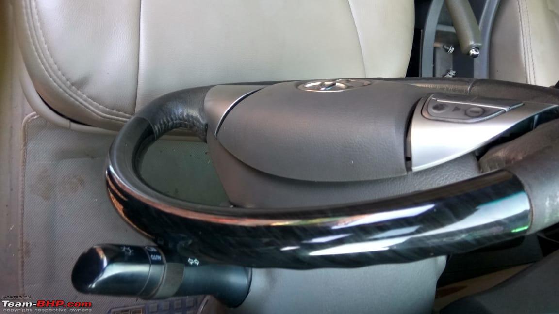

Shouldn't the airbags deploy in this case?? Look at the condition of the steering wheel

Something is definitely wrong here. How old is the car?
PS: Maybe Toyota has a backup system wherein the Steering Wheel bends to protect the driver's chest / head in case the Airbag does not open.
Originally Posted by samaspire (Post 4547281)
:Shockked:
Nope, that is just the sheer force of a locked up human arm. Or a chest colliding with the wheel.
