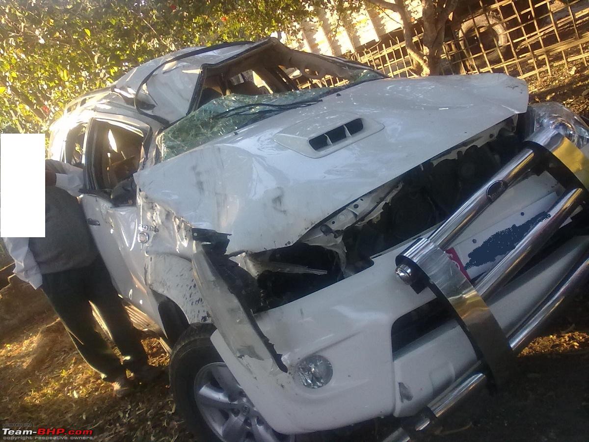

IMHO: The crash guard in the front has done a good job of protecting the sensors.
Originally Posted by bblost (Post 2627587)
A crash/ bull guard should never be used for vehicles running on public roads.
They KILL pedestrians.
Exactly!!
You have put a local aftermarket bull bar on your Fortuner. There is no way the airbags sensor will get activated even in head on impact with that bull bar.
As mentioned by everyone Fortuner only has front airbags which in a rollover are not supposed to deploy.

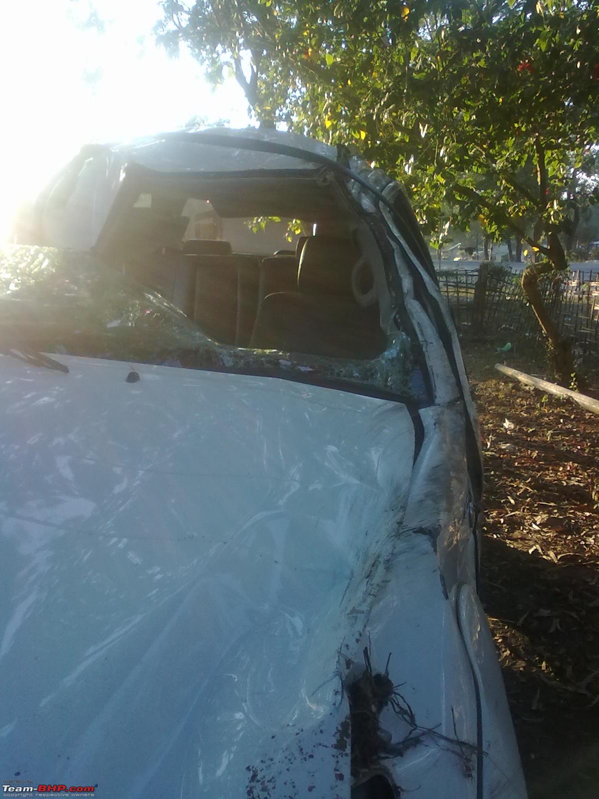

I am no expert, having said that, looking at the 2nd pics, if the front aig bags do not deploy, IMO, we are un-necessarily arguing on behalf of Toyota ! Sorry If I sound rude here.
Exactly my thought!

Well, it seems that the bull bars could also be a cause of the air bags not deploying. But, I still somehow feel that the sensors should be more sensitive in case of such extensive damage with or without the bull bar. Moreover, before rolling over, the front impact was just behind the headlamp as can be seen on the second pic and the damage towards the drivers seat is extensive with the A pillar and the fender caving in. So, I thought Airbags should have deployed. Too bad if the sensors are only behind the bumper as in such cases of diagonal frontal impact, they become useless then. BTW, the impact also cracked the OEM alloy wheel.

The airbags will deploy only if the frontal impact sensors sense deceleration beyond a threshold value. The Bull bar has messed up the game here.
Glad that your family escaped unscathed.
To me there are 2 reasons why the Airbags didn't deploy [these are already shared in the thread]
1. Roll over and no severe frontal impact. Looks like the A pillar took the beating.
2. Aftermarket bull bars !

Looking at the 2nd pics, still the airbags do not deploy, Toyota - better upgrade the sensors !

Will try & explain. The aftermarket one in the accident pics is different from the ones sold by Toyota. My doubt was whether the Toyota standard accessory is designed to be used with bumpers & crumble zones working as expected during the design of the car, which causes minimal damage to pedestrians if they come in contact with the vehicle.
Edit:: In the second pic, the bumper seems to be pretty much in good shape - no dents. So we can safely assume that the air bags sensors were NOT activated. Seeing the damage to the A pillar triggered my thoughts on mounting air bags on A pillar or air bags getting deployed on A pillar impacts.

Bull bars / crash guards do interfere with the air bag sensor activation. There are also cases described in the user manual when the air bags may not be deployed. This is the reason why I'd installed front parking sensors, so that any chance of collisions may be detected and whatever I can do to prevent may be done.

This incident happened with my cousin when he crashed the Fortuner 3 days back. The vehicle skidded under braking on a long sweeping curve on the highway, glanced a roadside tree on the RHS, then toppled and rolled over thrice before coming to rest on its side. Now, the major issue is that despite extensive damage to the front of the vehicle, the Air bags did not deploy. Thankfully, all the occupants of the car escaped with minor injuries with everyone wearing seatbelts.
I am not an expert on the Fortuner nor have I ever been in a major accident where airbags were required to be deployed, but seeing such damage I am wondering whether Air bags should not have deployed even before such heavy damage. The RHS of the vehicle bore the major damage and yet none of the front airbags deployed. Or is it designed to deploy only during more severe damage. (Then it is outright unsafe) or something did not work in this particular vehicle? (Then Toyota's much touted safety and reliability needs to be questioned.)
I am posting some pics below for your comments and advice. Sorry about the picture quality. These were hurriedly taken with mobile at the police station.

Sorry if I am sounding like a Pompous old fellow here, but in the end it is all driven by a program coded in somewhere, most probably the ECU.
The frontal Impact sensors need to be activated, for the machine to qualify to deploy the Airbags, but since the first impact is a side sweep here, the speed of the vehicle would be reduced and maybe did not deploy or register it as a frontal collision.
Secondly,the huge bull bar on the front, is a Indian mod for the Indian Roads, which I am sure was not tested in Toyota labs. any modifications ruins the manufacturer's assumptions and it is but natural that the Airbags did not deploy.
The logical question is, should be be questioning the ornamental bull bar or Toyota's safety standards.
