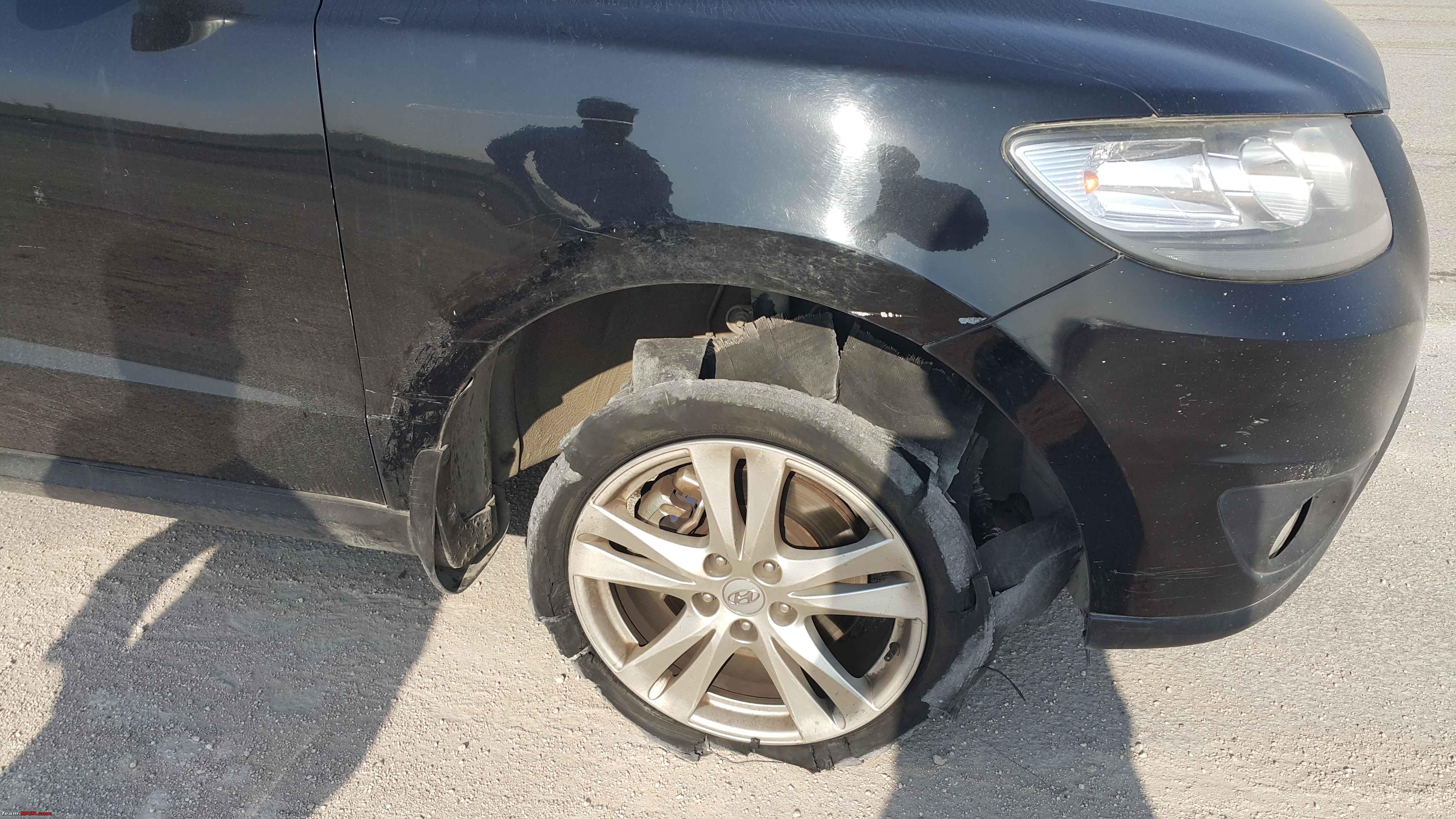

This happened to me a couple of days back and with the fancy speeds (can’t quote the numbers here) that people do here in KSA highways, I should say I am lucky to be in a position to post this here!
How to handle (and prevent) a Tyre Burst / Blowout-20161201_084222.jpg
Car: SantaFe, completed 6 trouble-free years in this November. 52K on ODO.
Tyres: 1.5 years old. Run for around 10k kms max.
How I handled this situation was exactly as GTO posted in the first page. Took off my foot gradually from accelerator and didn’t touch the brake pedal at all. There was trailer in my right most lane and once he cleared the lane I brought the car slowly to the extreme right lane and then directed the car to the sands. By then it was dead slow. I was lucky to have a few good drivers around me in other lanes who seemed to be quite familiar with such incidents on highways. They didn’t panic at all and took the left most lane and gave enough time for me to settle down.
This was all what was left!
How to handle (and prevent) a Tyre Burst / Blowout-20161201_111450.jpg
I tried changing this tyre but to my surprise all wheel nuts were jammed! I had to get it on a flatbed to the nearest gas station which was around 30kms from there.
