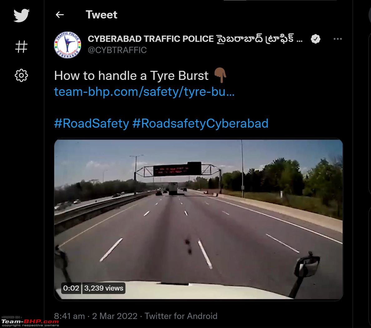

Big shoutout to BHPian ManneAtWheelz for sharing this! The Cyberabad Traffic Police shares my article on Twitter:
Link

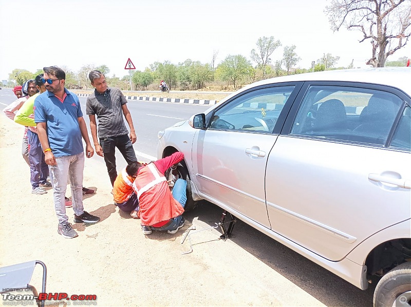

Tyre Burst @100kmph, NHAI petrol car came to Help.
So this happened during my ongoing long road trip. While the overall experience so far has been amazing, one tyre blowout experience gave us trouble in the middle of an empty highway.
So finally after driving for nearly 20 years without a single incident, I faced the dreaded tyre blowout at high-speed on a highway.
Here is the dashcam footage of the incident. The brick on the road comes in the video at 0.02 minutes.
Without panicking, my father stopped the car on the shoulder. I inspected the tyre and got right on to changing it. But the scorching heat at 11.35 am on our head and 42-degree temperature made sure that I was at the least efficient during this process.
In the next 20 minutes, I was only able to loosen the nuts of the affected wheel and lift the car halfway on the jack. The heat was literally draining the energy out of my body. My wife was urging me to call the RSA and not do it myself and my father was waving his hand for help to the few two-wheelers he saw on the road, but they didn't stop.
Contrary to common sense, I was not ready to wait for an hour or so which is the standard response time for RSA and was continuing my efforts to change the tyre (maybe the effect of extreme heat or the typical driver's ego - how can I take help for a trivial task such as changing a tyre!! ).
Just when I was about to give up on my EGO, I saw a red/blue Bolero pickup truck in the distance, IT WAS THE NHAI PATROL Vehicle coming. I waved my hand and they stopped and came out of their vehicle toward us.
After narrating the incident to him, the supervisor instructed his two helpers to do the rest of the work. In the next 10 minutes, they wrapped up the tyre change scene as well as checked the underbody for any other damage caused by the brick.
The supervisor also told me how this is a very common nuisance in this section of the highway because of the following reason. When any vehicle breaks down, the driver will put stones, bricks etc on the road surrounding the vehicle. Once the vehicle recovers, the driver simply moves on without removing the stones and this causes such incidents.
He also told us that on the highway one can dial 1033 for highway assistance, there is one patrol vehicle every 3 km for assistance.

Here are some pics of how this all went down and also the pic of the tyre where it got cut by brick.
How to handle (and prevent) a Tyre Burst / Blowout-img_20220417_114506.jpg
How to handle (and prevent) a Tyre Burst / Blowout-img_20220418_181933.jpg
How to handle (and prevent) a Tyre Burst / Blowout-img20220417wa0002.jpg
How to handle (and prevent) a Tyre Burst / Blowout-img20220417wa0003.jpg
While I didn't want to write this as the first story from this epic road trip across Madhya Pradesh on its magnificent highways, sharing it asap so as people can be aware of such nuisance and know about the help available to stranded vehicles.
Details of my incident
Road - NH39
Place- between Chhatarpur and Jhansi, more near to Newari.
Speed when a tyre blew- 100km/h on the speedo, 95km/h GPS speed.
Lesson learnt-
  • Always note down the highway assistance number (1033, or usually a mobile number displayed alongside the highway) and call them ASAP if in trouble, then call the RSA
  • I am going to keep a small hydraulic jack as well now. Never know when it could come in handy once again.
  • Be ready for eventualities on long road trips. Keep calm and choose the best alternative to recover.
Hope this helps.

Originally Posted by sunikkat View Post
Either the tyre blowout did not impact the car much at 100kmph or your father handled it like a pro by stopping the car calmly. At least from the dashcam hardly could find any impact.
I always thought it will create a panic situation
That is true, even I was pleasantly surprised, I would attribute this both to the experience of my father and the rock solid high speed stability of Corolla.
Originally Posted by sierrabravo98 View Post
I don't mean any offense but I feel compelled to ask this question. Why was your father straddling both lanes on an almost empty highway? The brick (and the resulting blowout) could have been totally avoided if the driver had chosen one single lane and stuck to it. Or were you merging back into the right lane after overtaking some vehicle in the right lane? If such is the case, then it is understandable. If not, please add this point to the lesson learnt section.
Again, I don't intend to any disrespect but drivers who straddle both lanes on an empty highway simply annoy me more than right lane hoggers. Such drivers force faster moving traffic to lose momentum and attempt dangerous maneuvers to get around the errant vehicle (the lane straddler).
Yes ,you are right. We were driving on this highway first time, it's a newly constructed highway, as it turned out 2 sections of it were still under construction and just before this incident we had encountered people using it as 2 way road. Hence we were driving cautiously in the middle section of road.
There are situations when and where we should modify our driving habits and adapt, this was one of them.
TPMS is present in my car, however you don't need it to detect a tyre burst, once it happen the car would pull towards the side of burst tyre (in my case it pulled towards left side) and any driver would instantly know the situation.
Originally Posted by Shubhendra View Post
This highway is recently built and is a treat to the driver. Being a new highway it does not have any trees nearby for shade. I cover this route once every few months, latest being last week
Dont want to offend but for a person of your age, changing a tyre in a car is not at all difficult even with the OE jack. Practicing that once in a while is really helpful considering this support is not available everywhere. May be heat must have got on you while tryin to change. You can also consider Hydraulic trolley jack, very easy to use.
Attachment 2299118
Apologies, I should have mentioned that I have partial disability in one leg, hence the difficulty in changing tyre. Prior to disability I had good practice. I have ordered the hydraulic jack today.
By the way, you are right, this highway ( & every other highway in MP I drove this month) is a treat to a driver, it shows the quality of work being done by NHAI, thought it has yet to take the test of time and weather.
I would really appreciate if someone could advise on the selection of spare tyre from the two options I have listed or may be suggest a better alternative.
My two cents..
To remove the nuts, I usually lay the spanner in a horizontal position, stand on top of it, and apply light pressure.
To loosen the nuts, insert a GI pipe (~1 m length - 1/2 " dia) into the wheel spanner, as long as the pipe does not scratch the wheel mudguard.
It is better to have have WD-40 or Zoric spray. Sprinkle all of the nuts and wait a few minutes before removing them.
