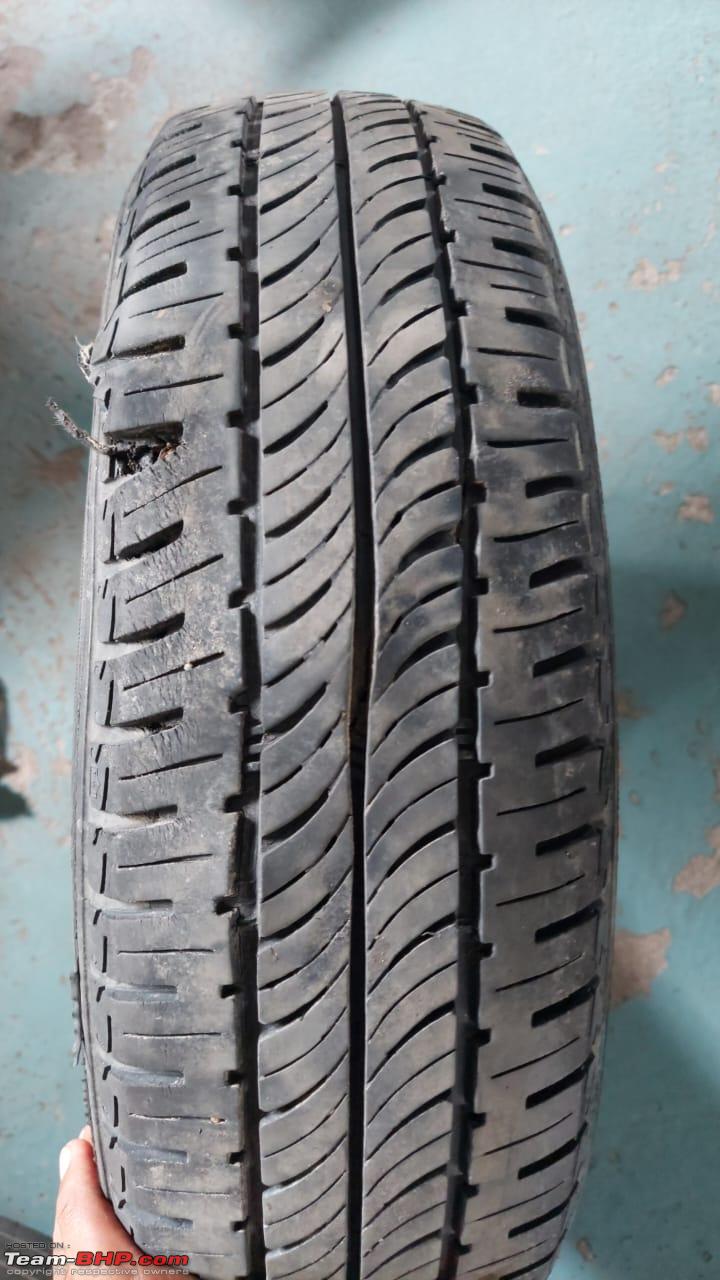

The following day, I had a look at the tyre, the rear right tyre had severe damages.
How to handle (and prevent) a Tyre Burst / Blowout-img_20220727_082613.jpg
The damage,
How to handle (and prevent) a Tyre Burst / Blowout-img20220729wa0003.jpg
How to handle (and prevent) a Tyre Burst / Blowout-img20220729wa0004.jpg
The dealer advised me to change all the four tyres. They said that the tyres had crossed their limits and should be changed. Thankfully there were no damages to the suspension or other parts.
I agreed, mostly because I wanted to be safe and safety is my topmost concern. At the same time, I wanted to upsize as well. I asked the dealer to replace the damaged tyre with the stepney and went to a nearby tyre dealer and switched to Yokohama 195/60/R15.
Throughout this process the Honda RSA team were amazing, kept reassuring me and following up until I told them that everything is fine now.
