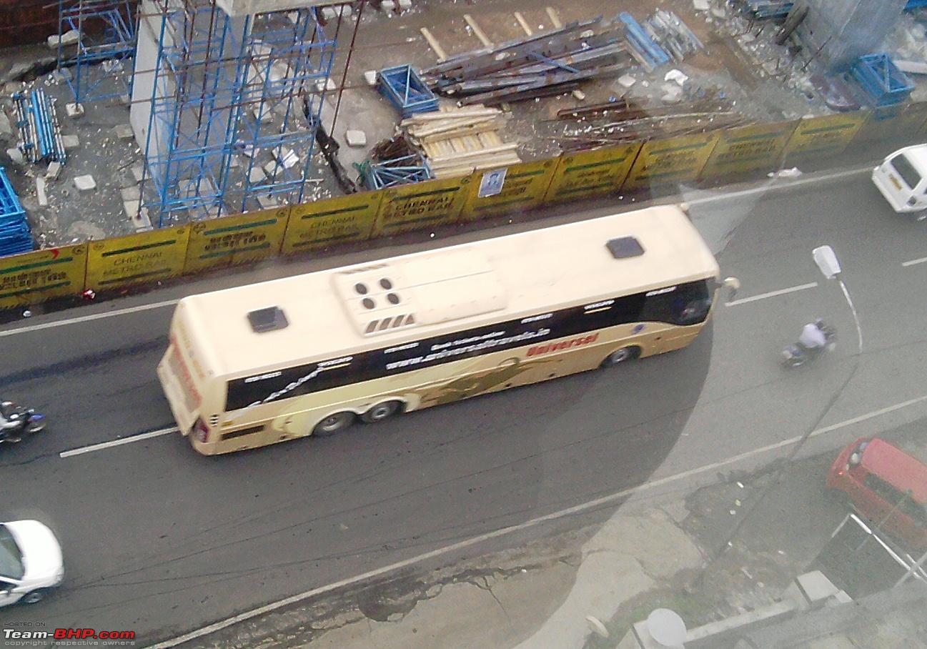

The only way out of the bus is to use the hammers and break open the emergency window. We did this, in the pitch dark, and took well over 10-15 mins to break the glass. Another 20-30 mins before all the passengers could come out of the bus using the ladder which was stowed in the luggage section. Thankfully, this incident was with a normal cargo laden truck and not with a vehicle carrying explosive materials, which would not have given us this precious window of 30 mins to get out !

On the same note, aren't there 1-2 vents on the roof that can be used as emergency exits? I know there are 2 on the intra-city Volvos; I think the inter-city ones have only 1.

...On the same note, aren't there 1-2 vents on the roof that can be used as emergency exits? I know there are 2 on the intra-city Volvos; I think the inter-city ones have only 1.
They have two emergency exits at the roof.

Above all, matters could get worse when people doesn't know that there are emergency features like breaking window with a sharp hammer or emergency exits. I guess people should be made aware of the reaction steps to be taken during an emergency before every trip.
Frankly I never knew about a safety door on top of the roof, which I think has high potential in saving lives during an emergency.

Aren't these meant for getting fresh air inside the bus. They can double up as emergency exits if the bus topples on one side but they are not primarily meant to be emergency exits in the first place.
Please correct me if I am wrong.

...remember, this is an "emergency exit", where comfort is not a priority at all. The idea is to be able to get out
The first priority is to get out of danger. The drop is not 10 feet, but probably 5-6 feet, which is not too high to cause more damage.
They are emergency exits. Those ports are almost always sealed with a glass, which has to be broken in case of emergency. In rare cases, I see them fitted with a proper emergency-openable hatch door, like this:
Actually its the other way round. Their primary purpose is emergency exit, and you will find them marked as such.
An auxiliary purpose is to allow for ventilation in case of AC failure.
In city bus, roof ventilators act as emergency exit. They are very easy to remove with just a flip of the lever.
In case of coaches there are no ventilators but only emergency exit.
But I understand there is also an option of having ventilators but have'nt come across though.
